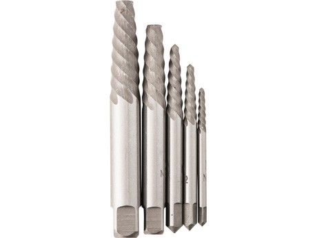

If you have a headstock chuck you have a lot of choices for a straight-sided dead center.
I have even used a screw extractor like the one on the left in this picture
