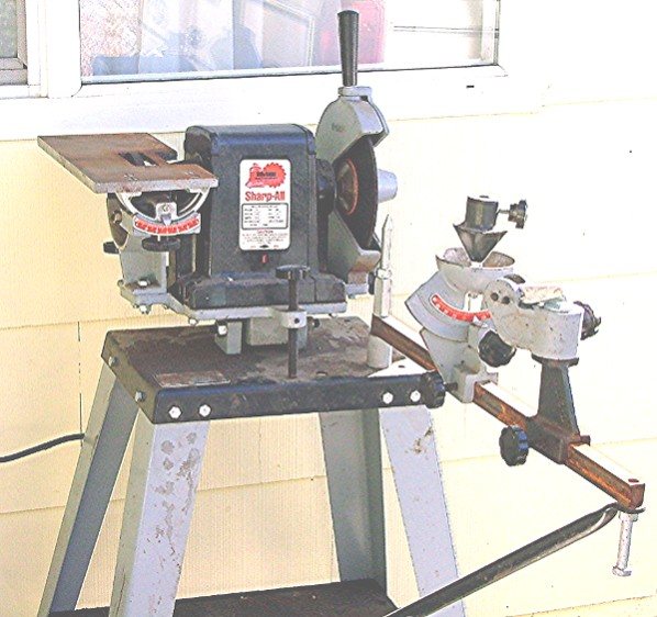

Here is the photo I said I would take
hope some of you get soemthing about other ways to get barrel trimmers ahrpened and thigns like that.
the handle above the large grinding whell is for actually puling the entire grinder forward into the item you are working on. the bar sticking out fron holds various holders. the one on there right now holds circualr saw blades. there si also one for holding chain saw cahins and many other accesories. sadly most of those are missing for this one. I will need to build a holder for the end mill cutter and the pilot that will fit on this bar. it can then be tilted as needed, positioned closer of farther away from the grinding stone as needed. and can even be set at an angle to the stone. basically compound grinding with depth control. this is how you could gring off the top edges of a barrell trimmer and still leave them all the same height.
notice the nob at teh center of the front of the grinder. this controls how far forward the machine can be moved. creating a consistant depth of grind.
now nto very many people are going to either run out and buy one fo these things, they are far from cheap. adn even fewer are going to find them for $20 like I did. heck one grinding stone for this machine is nearly $20. but you can rig up the same idea for a regular bench grinder. I thought of using my cross slide vise to be able to move the cutter head into my bench grinder. you could also mount a bench grinder to a plate hinded to a bench so it can be tipped forward like this one does.
in short you need a way to move the item you are sharpening in a controled direction, at a controled angle, and for a controled distance.
this particual sharpener is very high speed, you have to work in very short taps at a time allowing the tool to cool off between taps. but it takes off a lot of metal with each tap. I thik I could take a 5/8 inck drill rod and simply grind a barrel trimmer cutter out of it with no problem with this machine. I'll let you all know after I've tried it.
