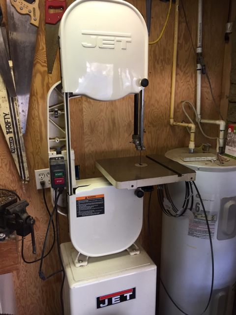

I managed to snag this at an estate sale today. Runs nice, though I haven't cut anything yet.
I'm curious for people's opinion: I will mostly be cutting pen blanks, bottle stoppers, bowl blanks, etc. I don't intend to do much scroll work right now. Would it be more beneficial to get a fence (what kind? Kreg, Carter magnetic?) or a roller guide bearing upgrade kit?
Thanks!

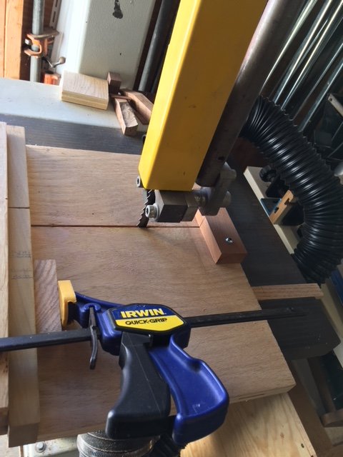

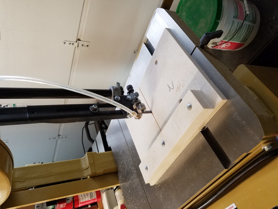

I've got a Kreg fence on one saw, but that Carter magnetic is nice. On the saw I use the most, I've got the stock Laguna but 98% of the time I use the sled I made below. The left side is 5 1/8" from blade for cutting blank stock, the right side ledge has markings for various tube lengths (plus the extra)--and I clamp a stop to the mark, no measuring. I've also got a few angled plywood pieces that I clamp on (like one to diagonally cut spectraply or any 5" length blank). Handier than a fence for me.
earl

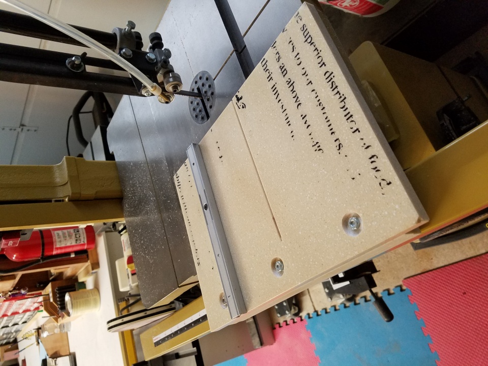

I also use a sled for most of my pen blank cutting on the bandsaw. Personally I would build a sled. With most of what you mention cutting that will be suitable for your cuts, pens and bottles stoppers and such, for the bowl blanks most likely you will not be using a fence but free handing the blank to round it up. If I wanted to spend more money I would get the good guides.
