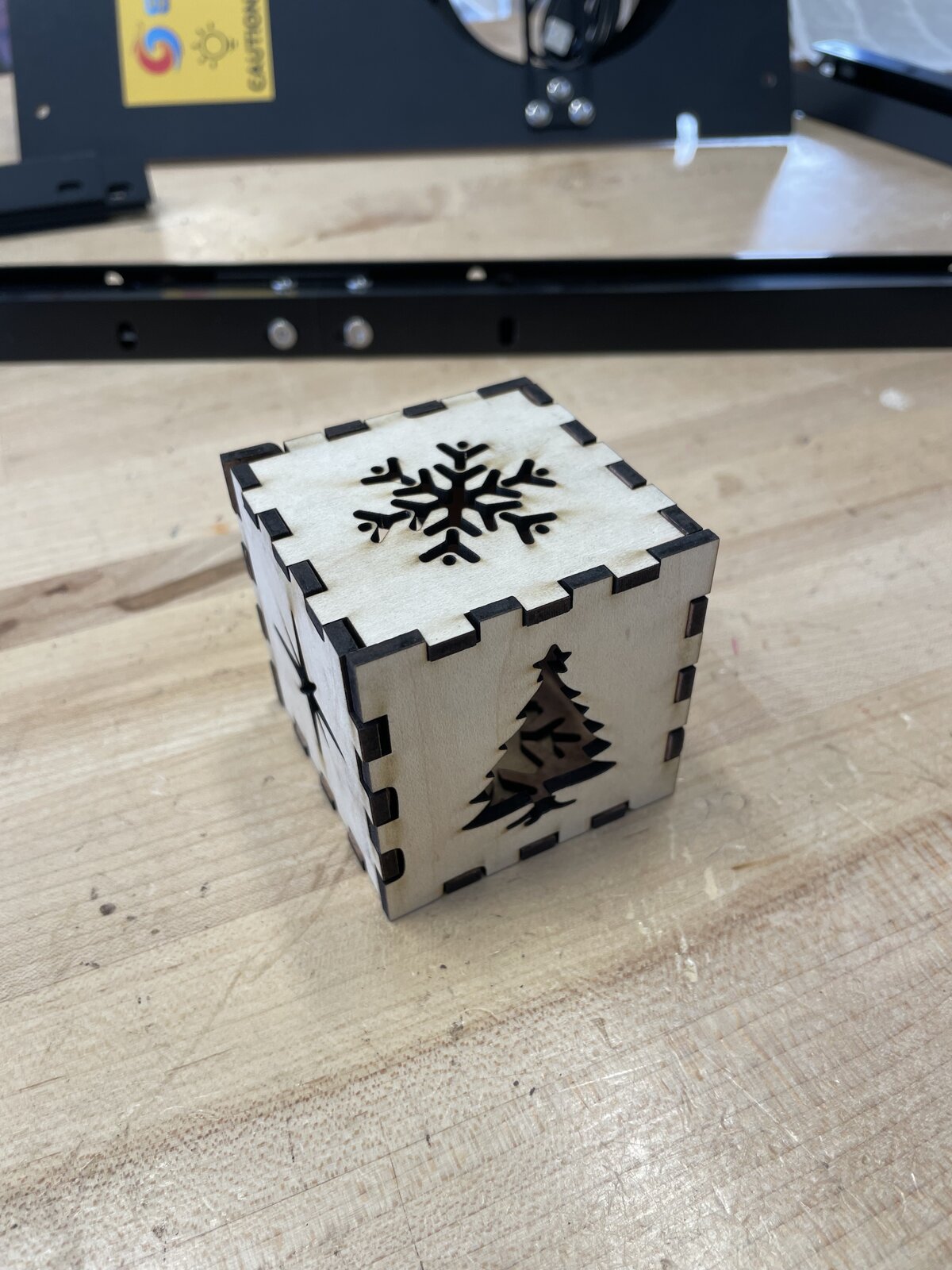

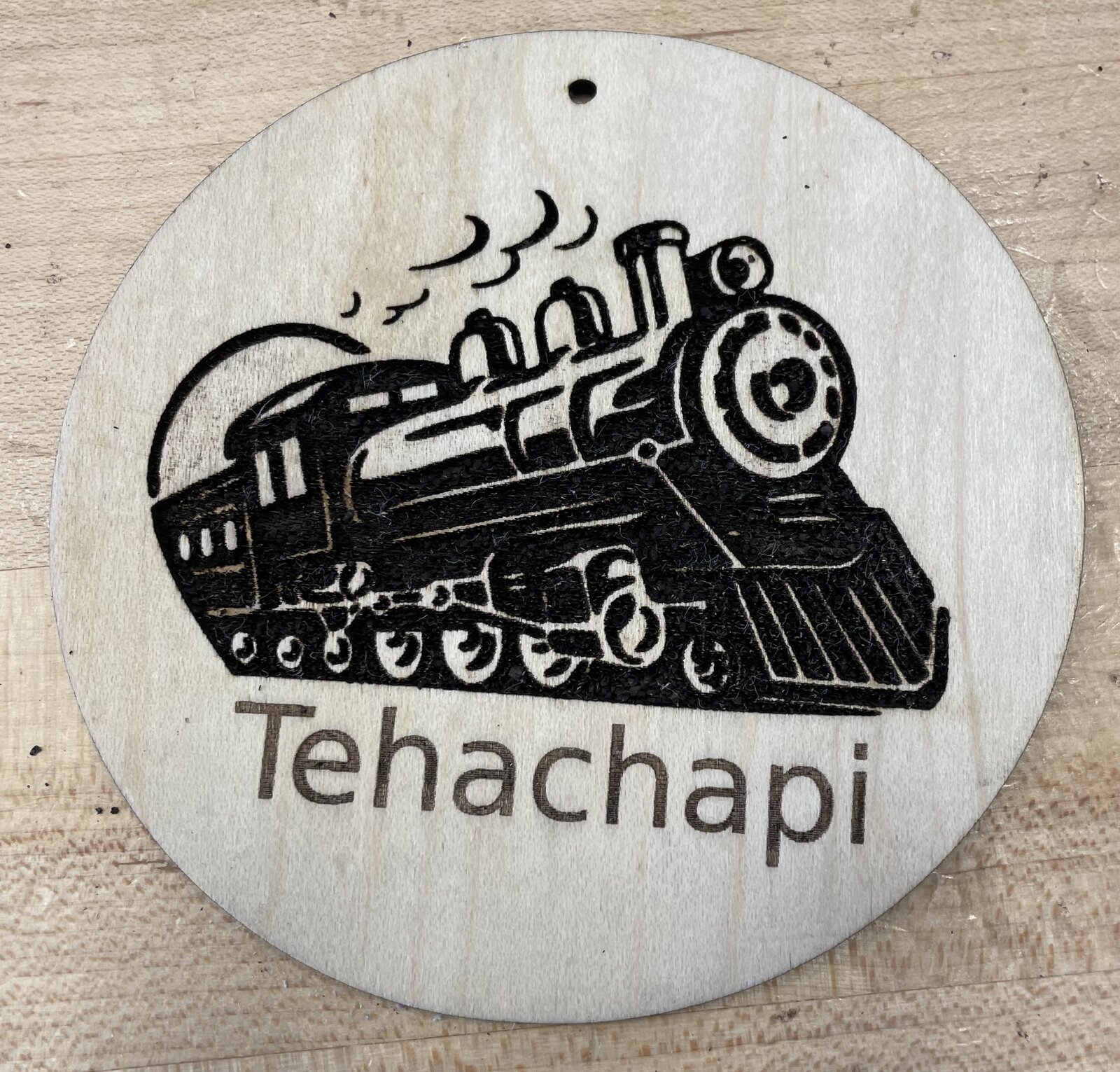

Just finishing these six "ornaments". The material is 3 mm plywood. It cuts through easily with one pass. The holiday box will become an ornament too. Some modifications are in store for the next burn.
Last photo is of sanded and DNA wiped final product. Total time for six was just over an hour while I did other stuff. I watch it regularly and will buy a halon extinguisher.

Nice work. Looks like you will be making adjustments to get the tabs tighter on the box. My first boxes either wouldn't go together or were so loose they fell apart! Make sure you measure the thickness of each board and adjust your cuts as needed. (Not all 3mm plywood is the same)

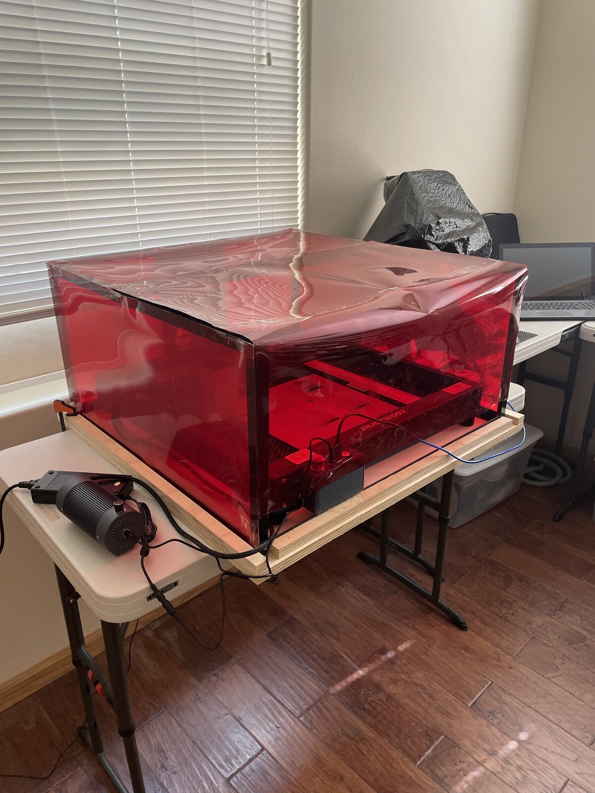

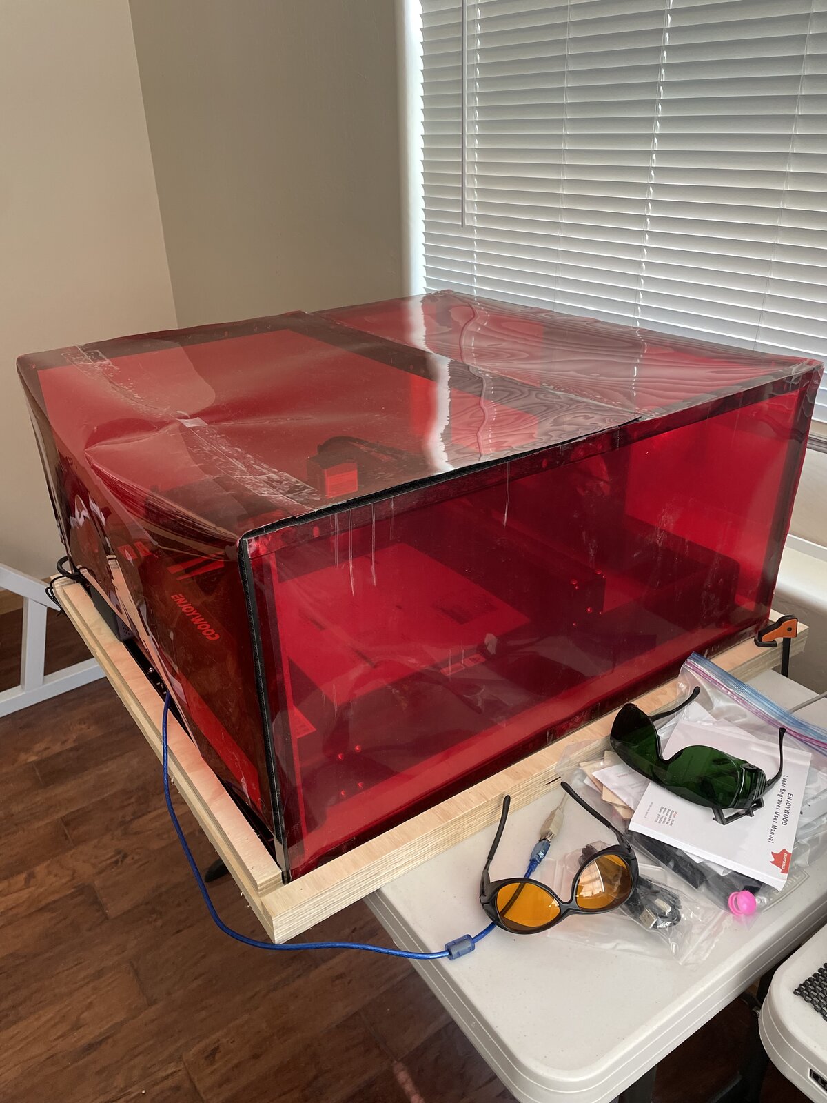

Finally finished my enclosure and got everything just about right. Smoke is exhausted outside where it belongs with a pretty decent fan and a 4" dryer hose. I 3D printed the 4" flange yesterday.
I've been using a friend's engraver while I got mine dialed in and in my room with my 3D printers. Now with one laptop everything is kosher.

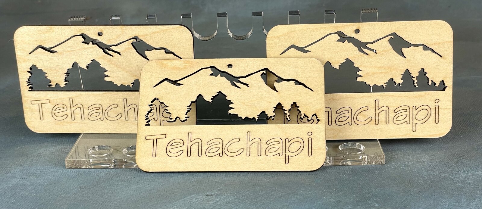

My first products went on sale today and time will tell. After the engraver; the cost is $0.25 each for each creation and they sell for $8. That kind of margin beats most pens and it works while, other than watching it from time to time, I do other stuff.
We are a tourist town so that will help with sales showing the word Tehachapi etc.
