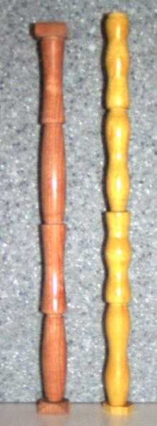

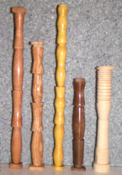

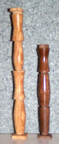

Gary Zakian
Jan 18, 2010
92
Bloomington, Indiana
Scott,
Just a few pictures and thoughts from someone who just started turning in January 2010.
I do not have anyone nearby to learn turning from, so I spent a lot of time reading on this site, looking at YouTube videos, and reading many books from my local library.
As for turning, rather than put pressure on myself to "produce" something, I chose to have some fun and experiment. That way if something did not work as planned it was OK since that is the nature of experimentation and having fun.
The pictures below are my fun experiments with blanks turned between centers. (From left to right) in picture number 1 is cherry, white oak, yellow heart, walnut, and basswood. Picture number 2 is cherry and yellow heart, and picture number 3 is white oak and walnut. I chose each of these as "sacrificial blanks" for my experiment. The basswood I got from hobby lobby for around $2.99. It started out as 1" square by 30" long, which I cut into 8" - 9" segments.
There were seven (7) experiments I conducted using these blanks. First, I used a gauge, skew and parting tool on each blank, as the spirit moved me, to get a feel for what each was best or better at than the other tools on the various woods. Second, I wanted to learn the turning ease or difficulty presented by each of the woods with regard to softness, grain, density, etc… . Third, I sought to learn what tools I felt more comfortable with in making the basic shapes. Fourth, some of the blanks had voids and open spaces that I practiced filling with CA and CA/sawdust. Fifth, I used sandpaper from 320 up through 1500 to see what each grit would do on each wood before applying any CA or BLO. Sixth, I tried some different finishes on the cherry, yellow heart, and white oak. The bottom shape on each is about 5-6 coats of BLO only after sanding to 1500 with dry sandpaper. This was just to see what straight BLO looked like on each one. The second shape up on each is a BLO base with 4-5 layers of CA/BLO on top of the BLO base. The third shape up on each is a CA base, with 4-5 layers of CA/BLO on top of the CA base. The top-most shape is finished with 5-6 layers of CA only. I micro mesh wet-sanded the top three shapes (not the BLO-only shape) from 3600 to 15000 to learn how each MM grade worked. And seventh, I am keeping these turnings and using them as reference guides for when I make pens from these various woods so I can see what finish looks best and whether there is any change in the finish over time.
The Walnut blank is BLO on the bottom, CA/BLO in the middle, and straight CA on top, finished with MM as indicated above. The bass wood has no finish at all, just dry sanding to 1500 with sandpaper.
When I was all done with each one I would have the members of my family come in individually and touch and feel each shape and finish and let me know what they liked and did not like about each turned blank. Their input was helpful and helped them understand what all the noise and odors were about.
Hope this helps.
