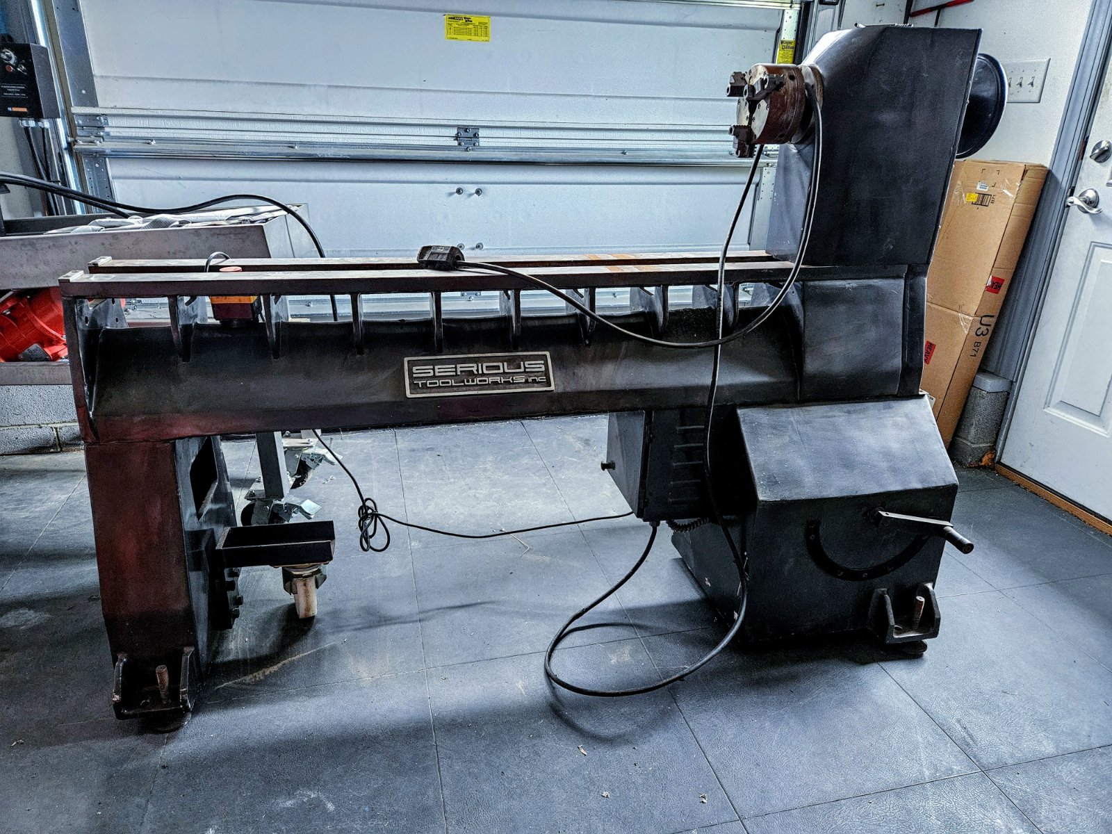

A week or so ago I noticed a listing on a local Facebook page that showed a rather large lathe. I could just barely make out the model number on it, which wasn't in the listing anywhere, and realized what it was. The price was great, but it was over two hours away and I didn't have a way to transport a 1500lb machine easily. (Yep... that's heavy)
I joked with the person that listed it that they were just far enough to save me from myself... which was great... until they reached out a few days ago offering to deliver it to me for the same price.

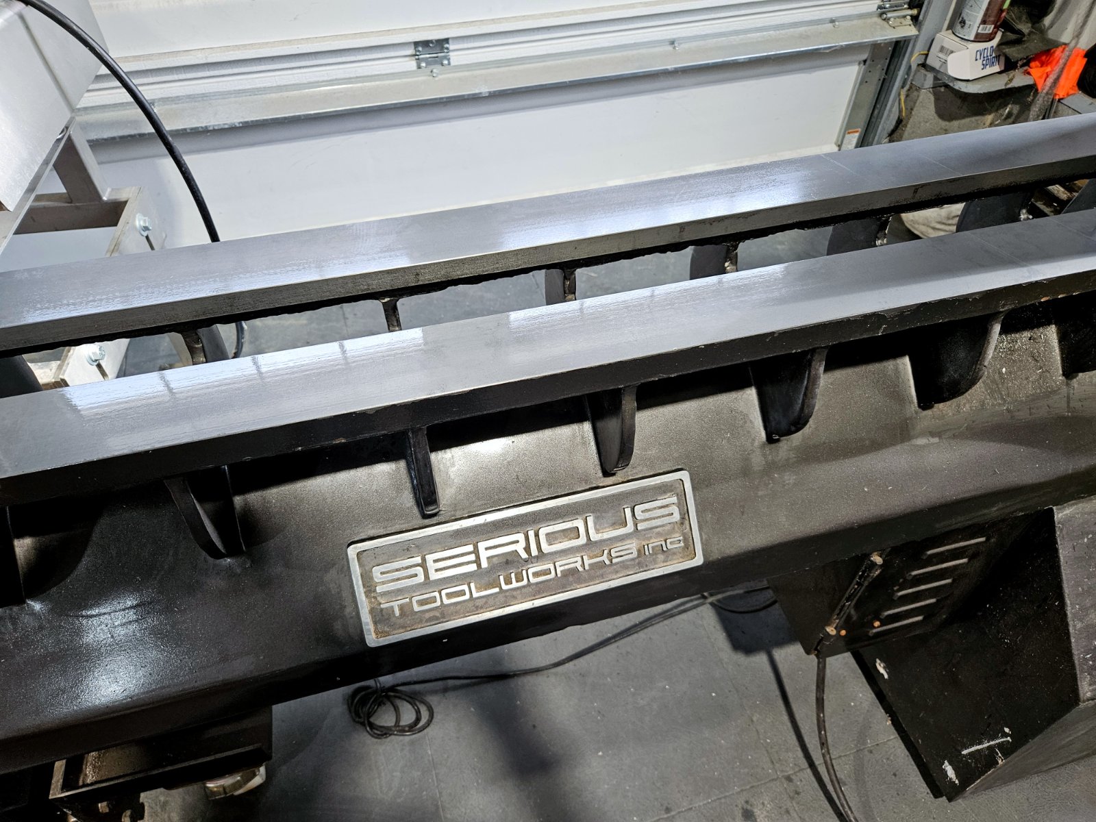

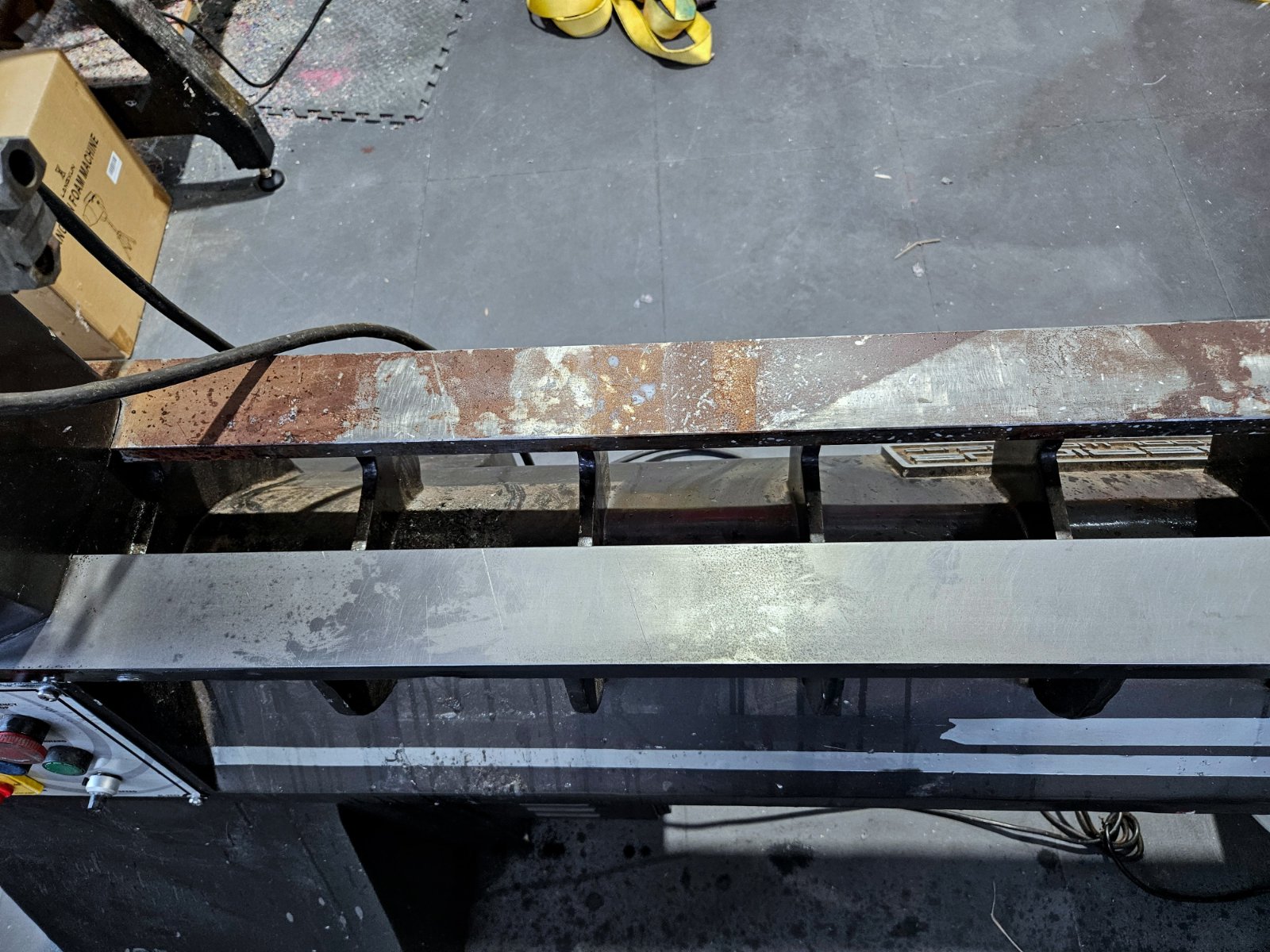

SOOO.... now I have this little thing in my shop. It's a Serious Toolworks SL2542. Weighing a mere 1580lbs, it was really fun to get off the trailer and into the shop. It does have wheels but the one on the tailstock isn't quite holding the weight (have to adjust the stationary foot later) so I used my gantry crane to get it in a temporary spot while I clean it up a bit. It sat for 2 years in storage so the entire lathe bed was rusty. Couldn't have that so I already cleaned it up. Now I'm waiting on MT3 accessories and a 1.5" x 8 wood turning chuck to get here so I can turn with it. That is NOT a size that gives you a bunch of choices in wood turning chucks!
Only thing I can think of that I might do with this thing is turn a drum shell or two... I used to build drums before going all in on pen stuff but never had a lathe big enough to do stave/segmented drum shells. The really funny thing is 99% of the time this will just be used to drill 3" lengths of 3/4" maple for our laserlinez blanks. But by golly I've got 6" of tailstock travel to do it with!

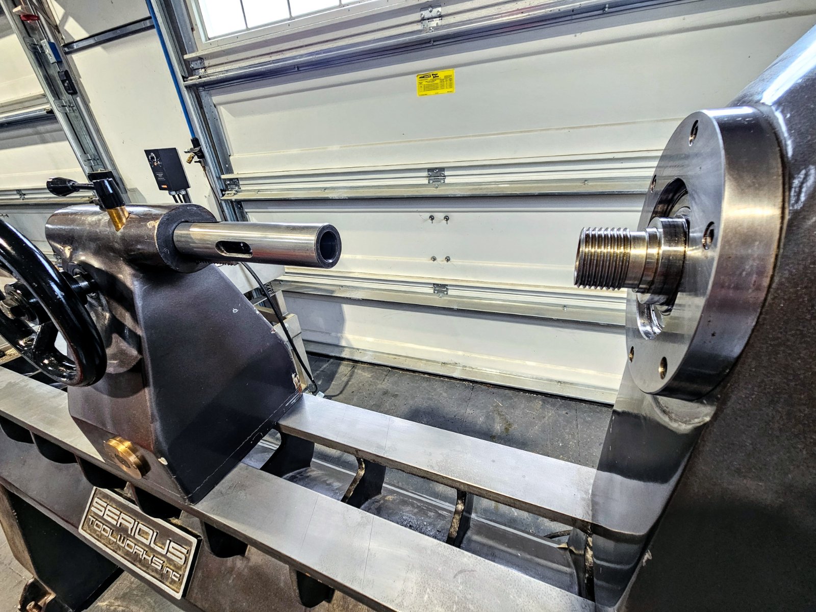

I didn't want to carry it far enough to put on the scale... guessing at least 60-70lbs. Funny thing is I messaged the previous owner because I thought the bottom part that holds it to the bed was missing. Figured out I had these two round pieces of steel with threads that happened to fit in the ways under the rails perfectly. I'm just not used to using a 1" bolt to hold things so I didn't realize what they were at first. 😆 Need to grab a different plug tomorrow, clean up the rest a bit, and get the motor back aligned and I'll be in business. Well that and I'll need to move it to a permanent spot. Which means getting the gantry crane back out... Once I have this where it's going to be it stays there, forever.

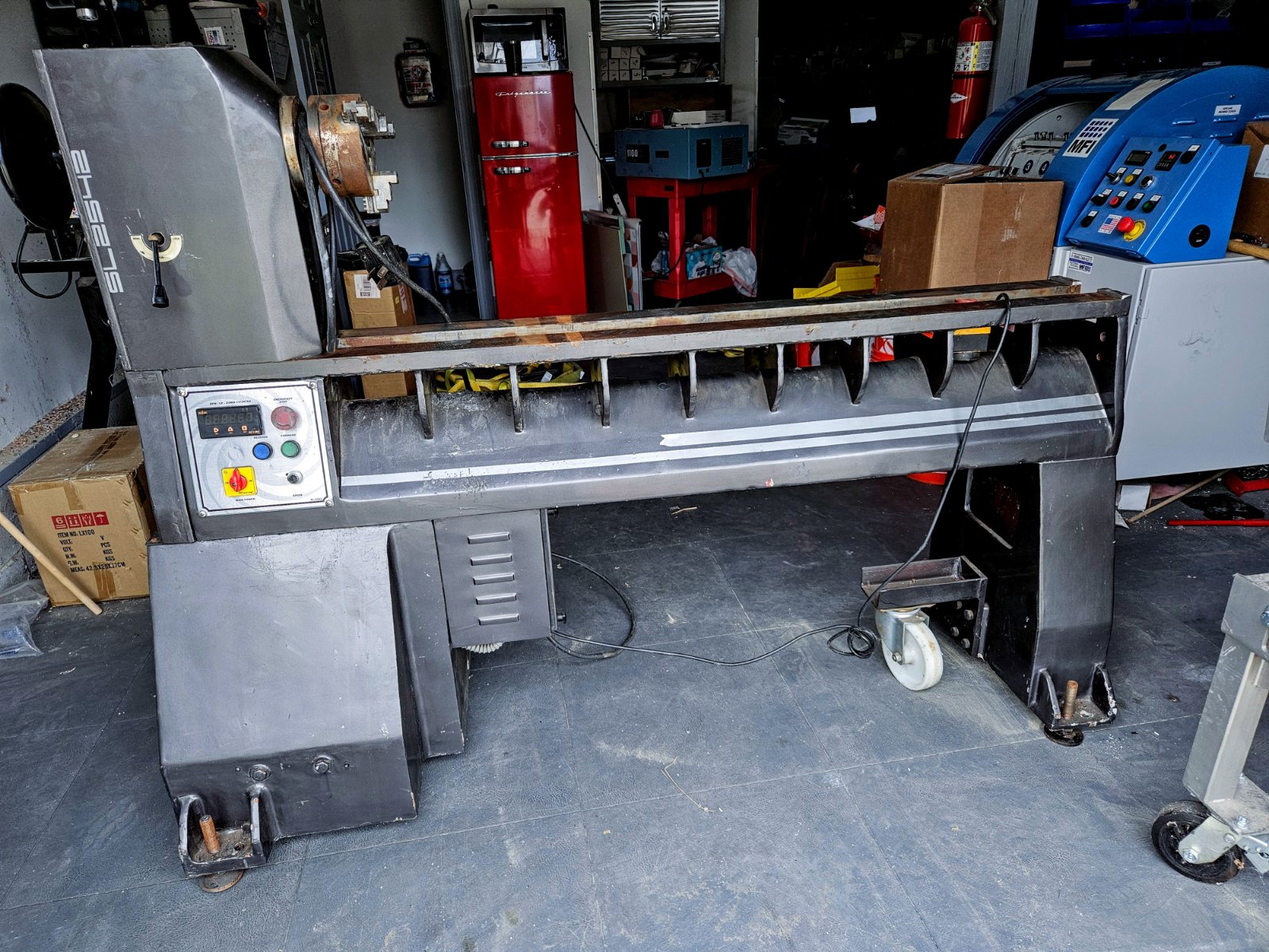

Thankfully didn't need to get creative... just held on to the nice large wheel and knocked on the chuck a bit with a rubber mallet. Things were pretty clean under the chuck so just needed a bit of tidying up. Today I'm hoping to swap out the plug and get some power to it. Everything spins free so don't foresee any issues. I'm pretty sure this company is out of business so any issues will be on me to fix and since it's circa 2012 things speed controllers, etc might have been discontinued and be fun to source exact replacements. No owners manuals to be found anywhere I can see... not that lathes are super complicated...but still nice to have for any machine.
"I'm pretty sure this company is out of business"
Still in business. https://serioustoolworks.com/wood-lathes.html
Well, I will try the phone because their email bounced. Got power to it last night and it's running nice and smooth but the tach isn't working so not seeing the rpms on the read out. Gonna open it up and have a look for loose wires etc.
