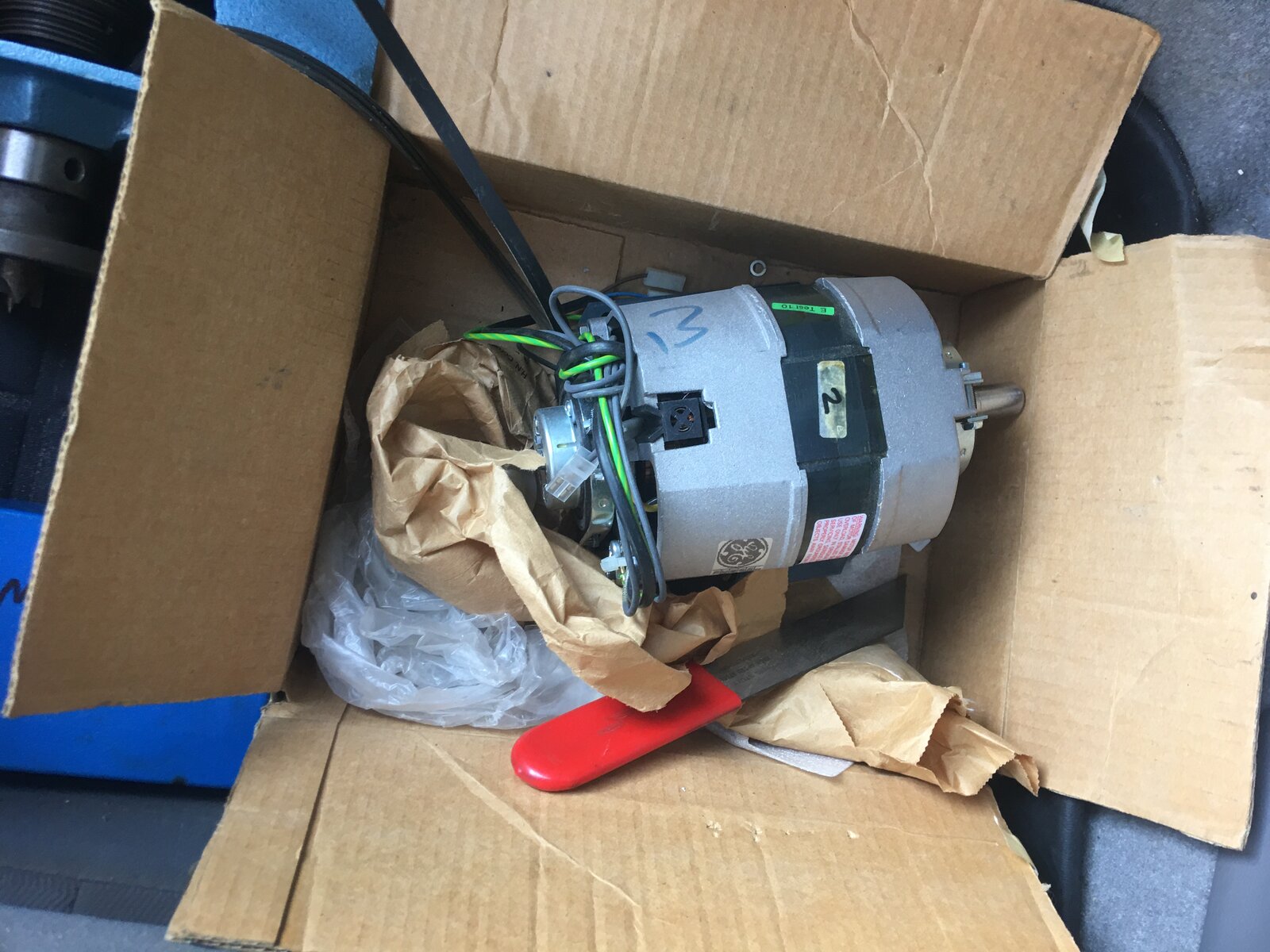

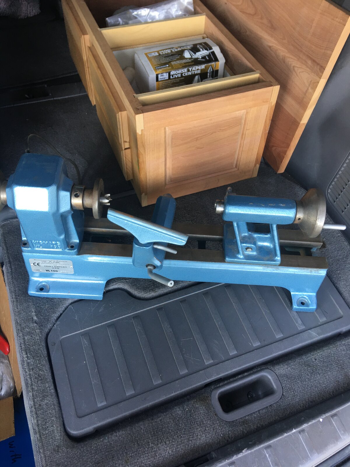

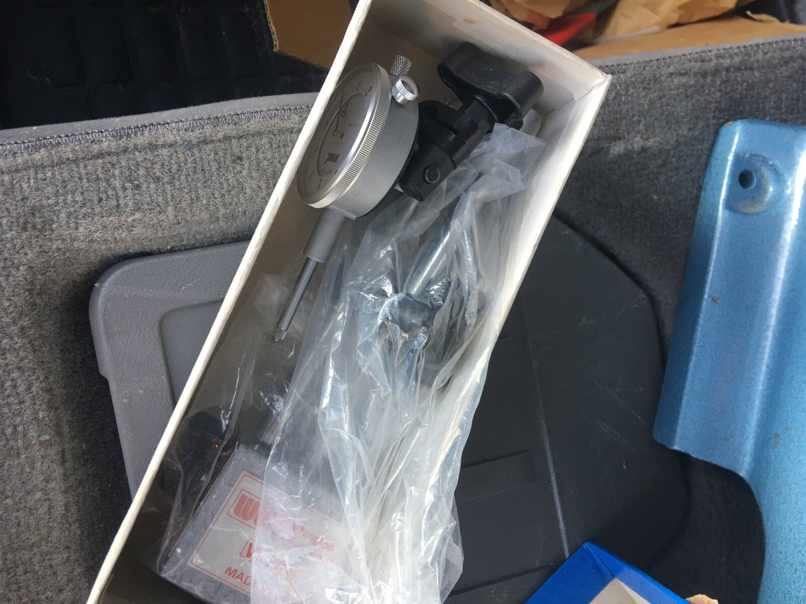

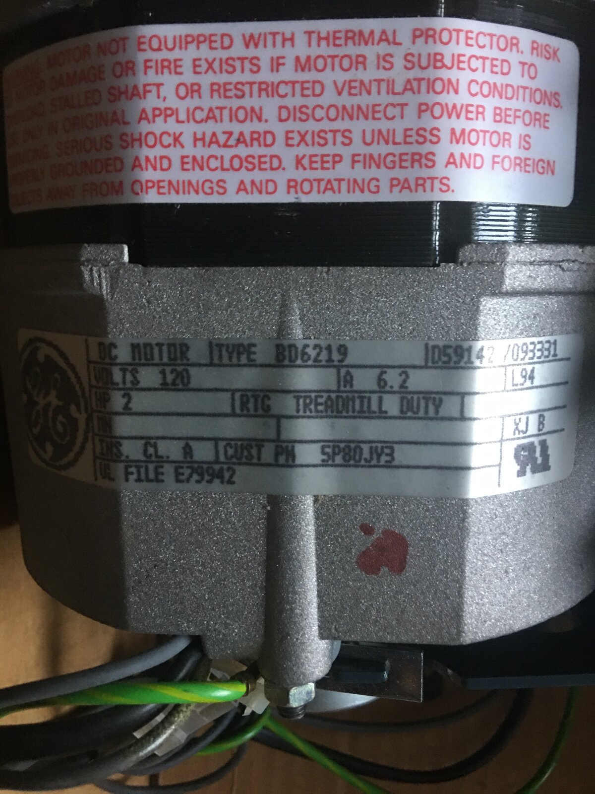

Picked up the Vicmarc Vl 100. In my van now. It came with 2 ge 2hp DC motors and cards and potentiometer for it and controllers. The previous owner was the sellers dad who passed away. The machine is not used. He had not completed putting it together. He had built the nice cabinet and mounted the motor in it. But not finished the belt slot or wiring. Also came with extra smaller tool rest and some other accessories. I am adding pictures.
I will need some help with wiring this thing up. Expect me asking some questions out of ignorance. 😊

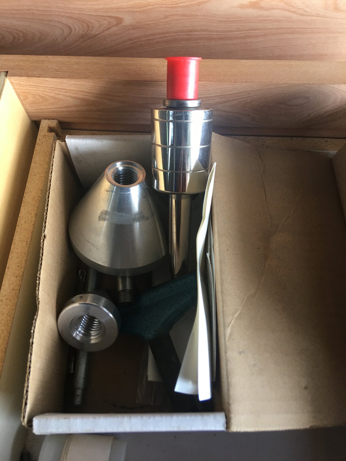

I have also just realized that it came with Oneway Morse taper live center pack. Even though I don't know exactly what it does I know that it is a good thing from the little reading I have done 😀

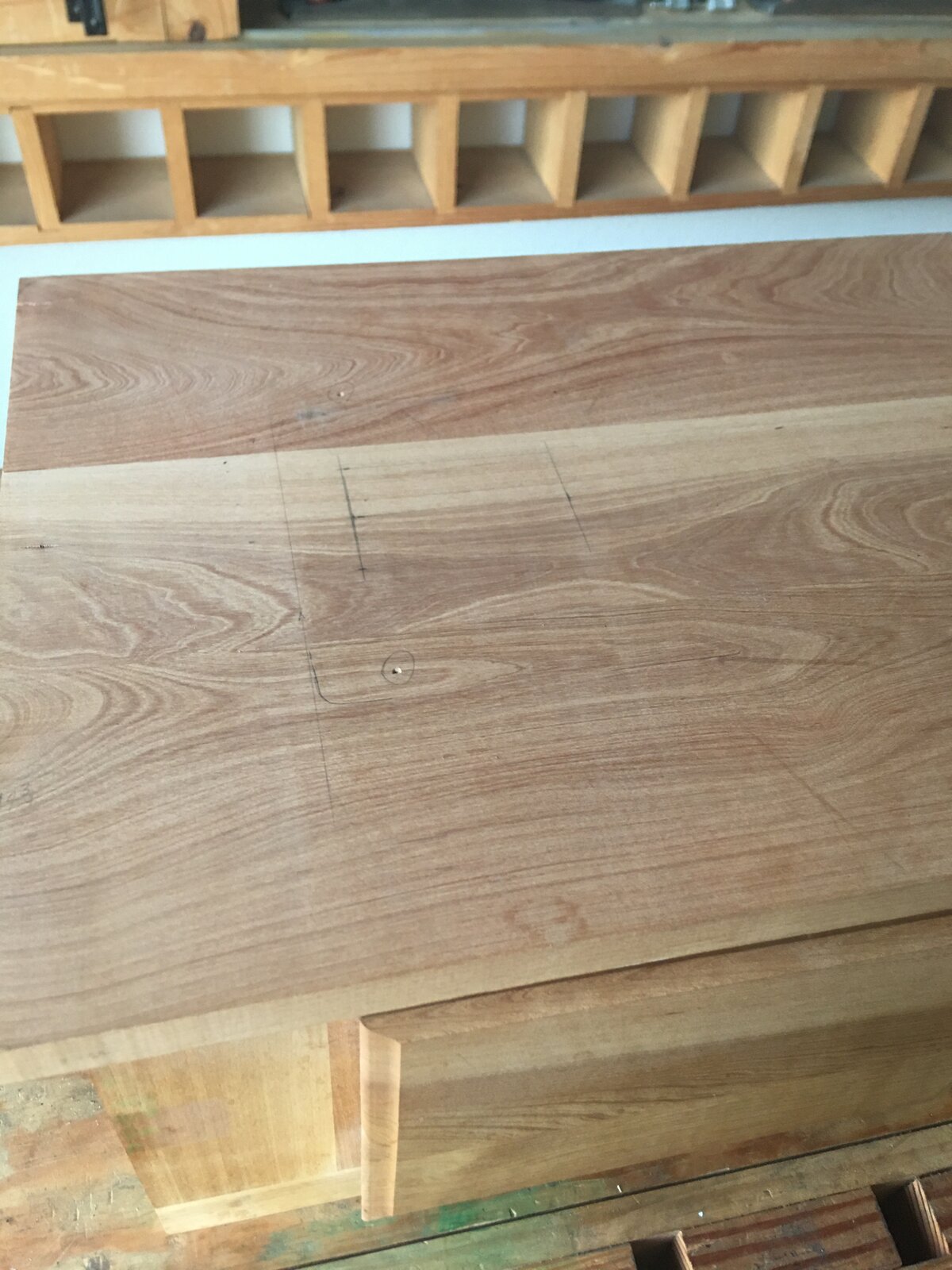

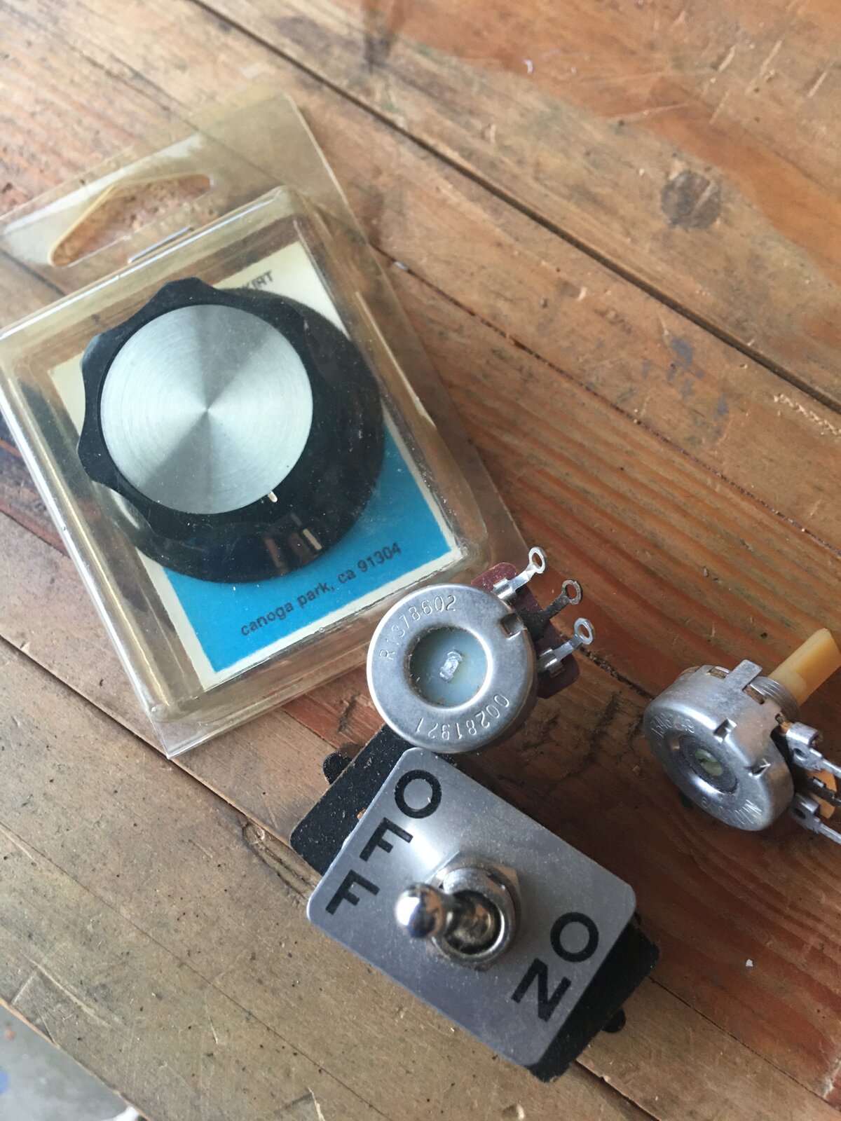

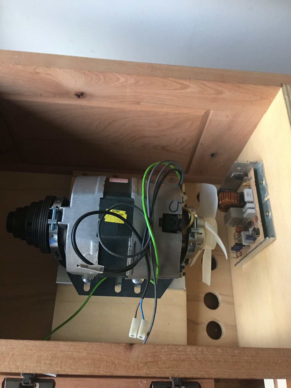

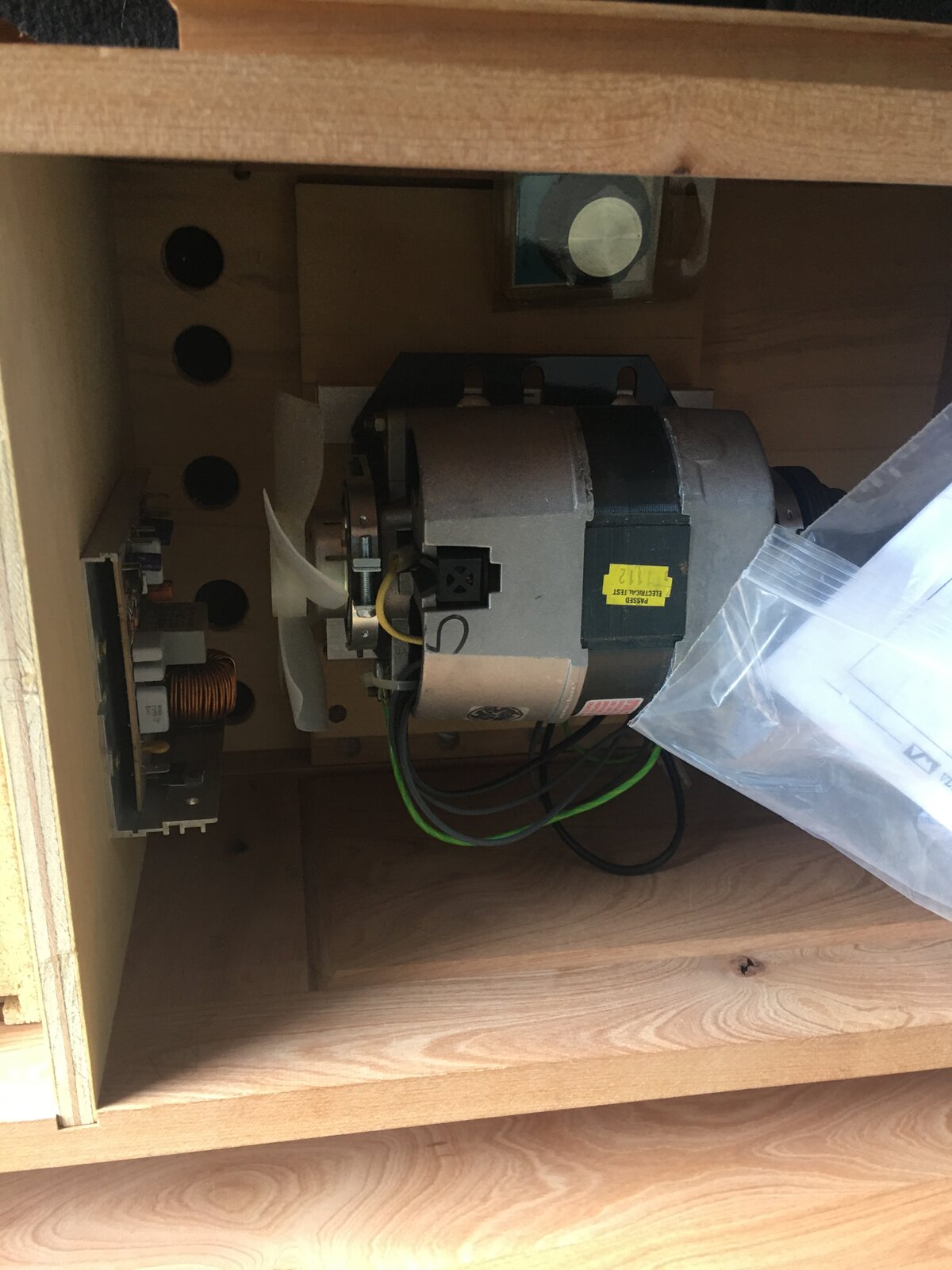

Okay. So here is what I got. I mean please take a look at the pictures. You will see in the pictures that I need to cut a slot for the belt and mount the lathe on top of the cabinet/stand. Then I need to do the wiring. The motor is already mounted inside with a controller card mounted on the side. The motor is mounted on a hinged slab. I will incorporate something that will let me lock it down and release when I need to change the belt.
I know nothing about wiring this thing. Some of you kind souls please help me walk through wiring and setting this up.

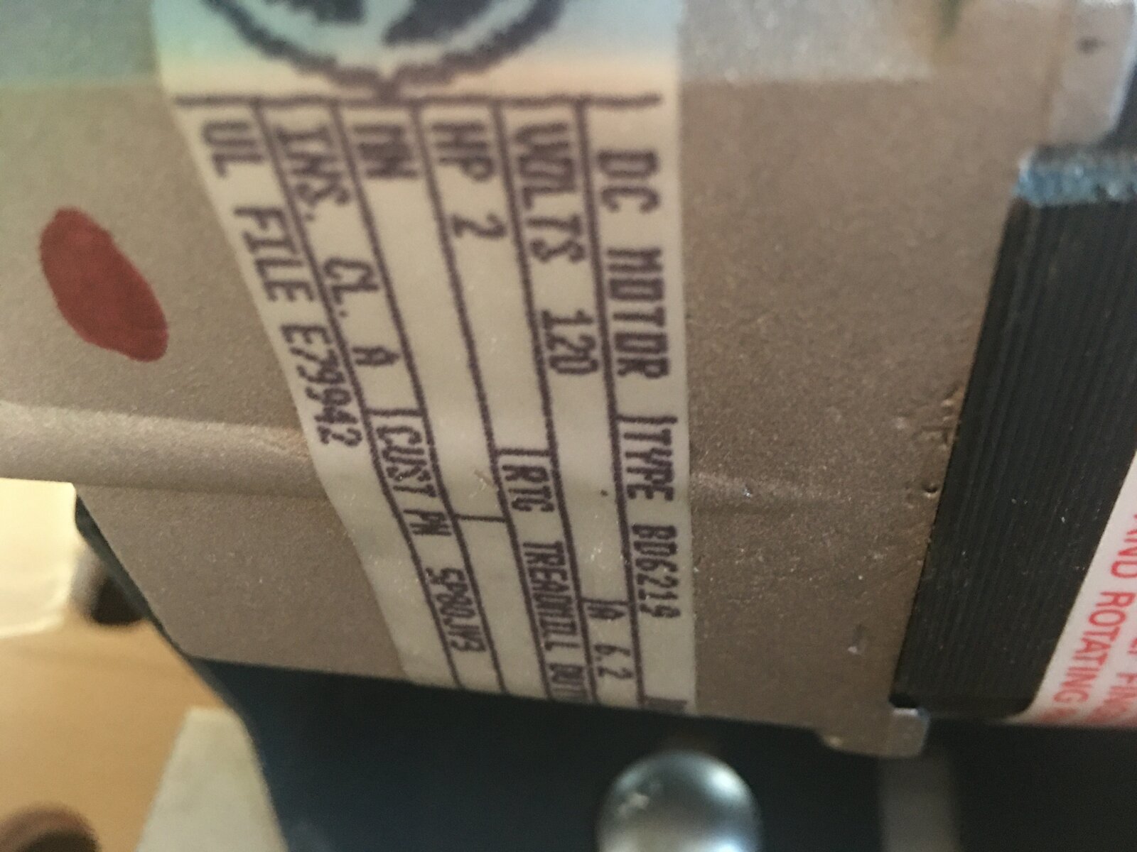

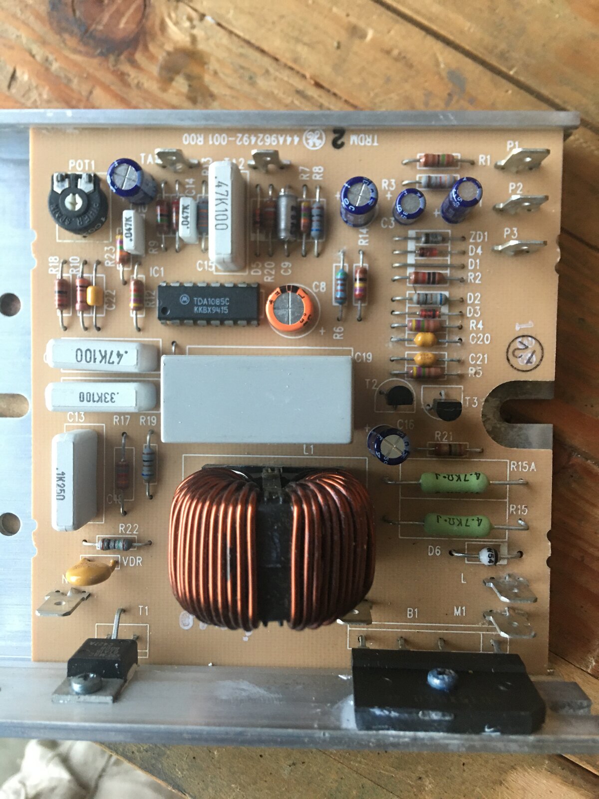

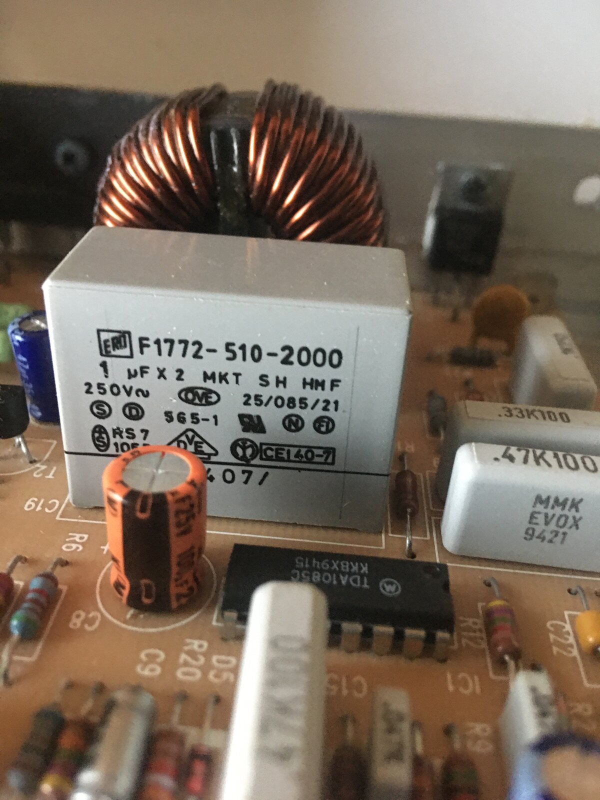

On the motor the label reads 120v and the white thingy on the control board - that I believe is a transformer - says 250v on it . Is that an issue ? Am I supposed to plug this thing into 220v outlet or 120v ? I have both in my garage.
magpens
Feb 2, 2011
15,911
Canada
The white thingy on the circuit board in the last picture is not a transformer ... it is a capacitor.
The voltage rating on it of 250V is not relevant for determining the correct AC source for powering your motor.
For the motor, its own label is what you should go by. . That label says it is a DC motor and specifies 120 v
But you are not yet ready to plug it in and make it go ... you need more advice.

GOOD !! 😁 . I wish I could be of more specific help. . I know a very little bit about electronics (like difference between capacitor & transformer) but I don't know enough about electricity to hook up a motor of this type.
It does look like you got some "good extras" with the purchase, like the cabinet, dial gauge(s), and the 2 Morse Taper live center. . The last two items are worth well over $100, so that's money in your pocket.

I found the following from my online search. And I can identify those connections on the board I got and it is the exact same GE board 44A962492-001 R00. I searched by that number and this came up.
"....The drive board that I have has the following connections on the board...L & N = 120 vac in, M1 & M2 DC out to the motor, TA1 & TA2 tach input from the motor P1, P2, P3, goes from the drive to the speed pot. My drive is a GE, part # TRDM2-44a962492-001-r00....."
Getting some sense about it. Need to figure out what else I need to control speed and if possible to do reverse.
And need to figure out a way to protect that motor and board from dust. The slot for belt is going to let dust go in there. But that comes after I solve the wiring. 😊

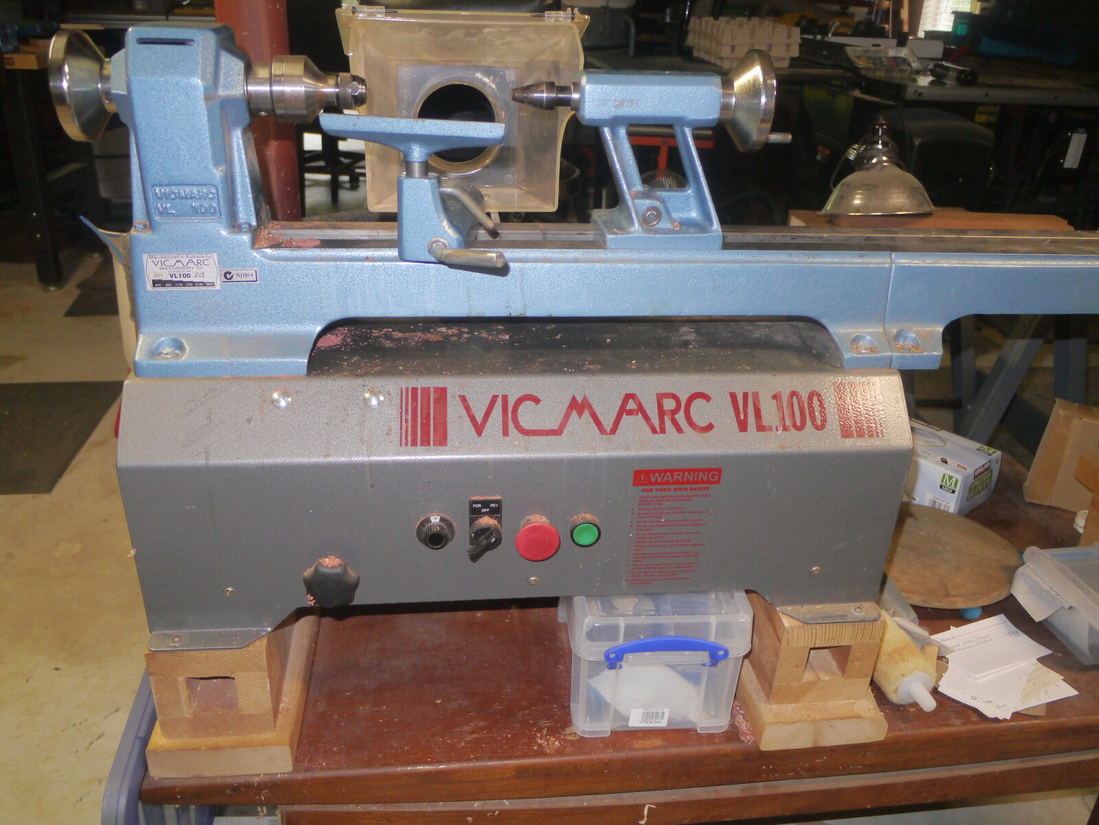

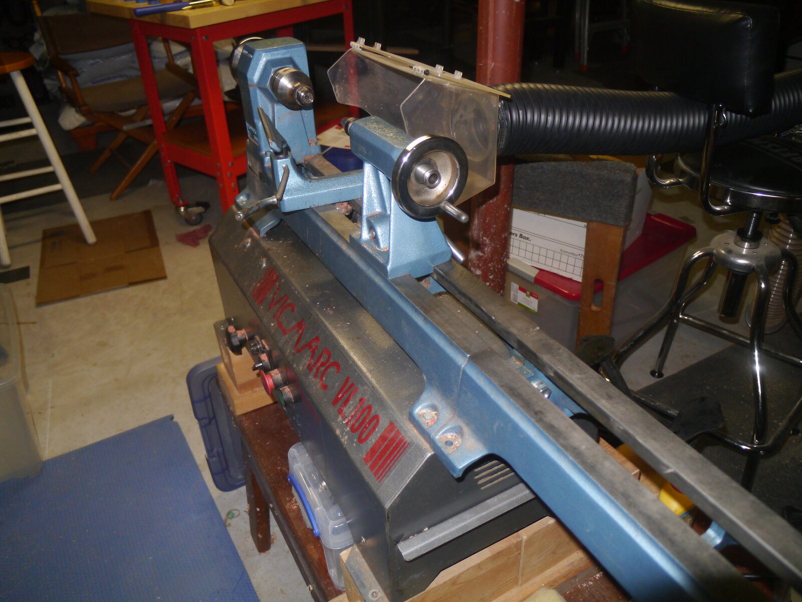

I mounted my VL100 on a bench and took the drive through the top of the headstock on the bench keeps the under part of the bench
empty. I will look for pics.I have a VL100 and its larger brother VL150 ,both bought as bare lathes and I fitted variable speed controls to them using three phase 415 motors and controllers that allow 240 in 415 out.My Vl100 is about 30 yrs old.I will take pics tomorrow.
Peter.

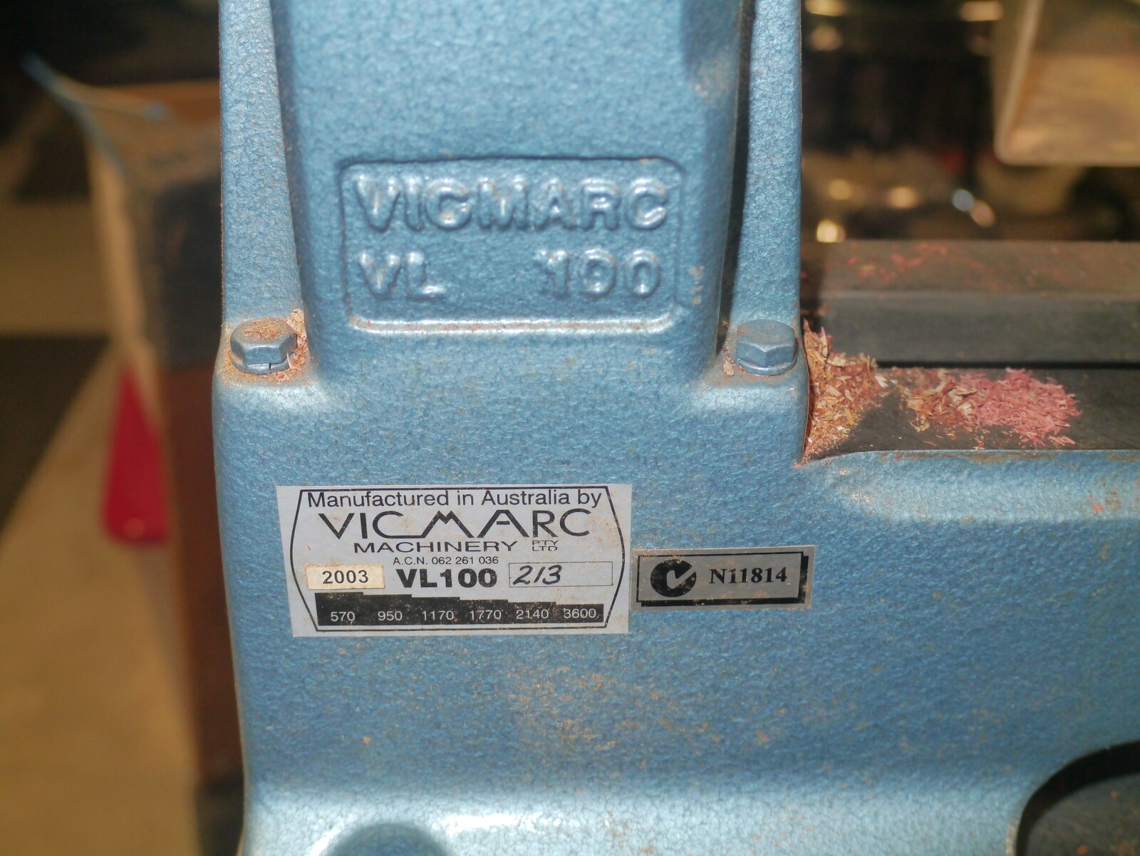

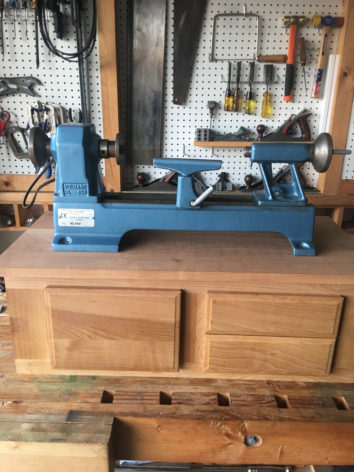

I've owned a VL100 for almost 20 years and never looked back. I spent $1000 when most new turners were purchasing small Jets for $100. Some of the best money I ever spent. I purchased a bed extension a few years later. Hopefully the pictures will post.
Charlie...........
Charlie...........View attachment 288433
Wow great set up.
Where did you get the stand/motor set up below the lathe from ?
What kind of motor set up does it use ?
And how did you get the bed extension
ctmayflower
Dec 30, 2012
3
Wow great set up.
The set up was one of the stock Vicmarc packages at the time and came to me all set up - sort of a plug and play. I have never separated the base from the lathe.
I purchased the lathe and extension bed from a turner in Atlanta who was a small Vicmarc dealer. If memory serves me right his name was Terry Daniels. He was an elderly gentleman then and I lost contact with him years ago.
It has variable speed and forward and reverse as you can see from the controls. It also has 5 belt positions. It runs on 220. No electrical knowledge at all so I can't help you there. I do have an electronics manual from Control Techniques (UK) dated 2002 which makes no sense to me.
Hope this helps .........
