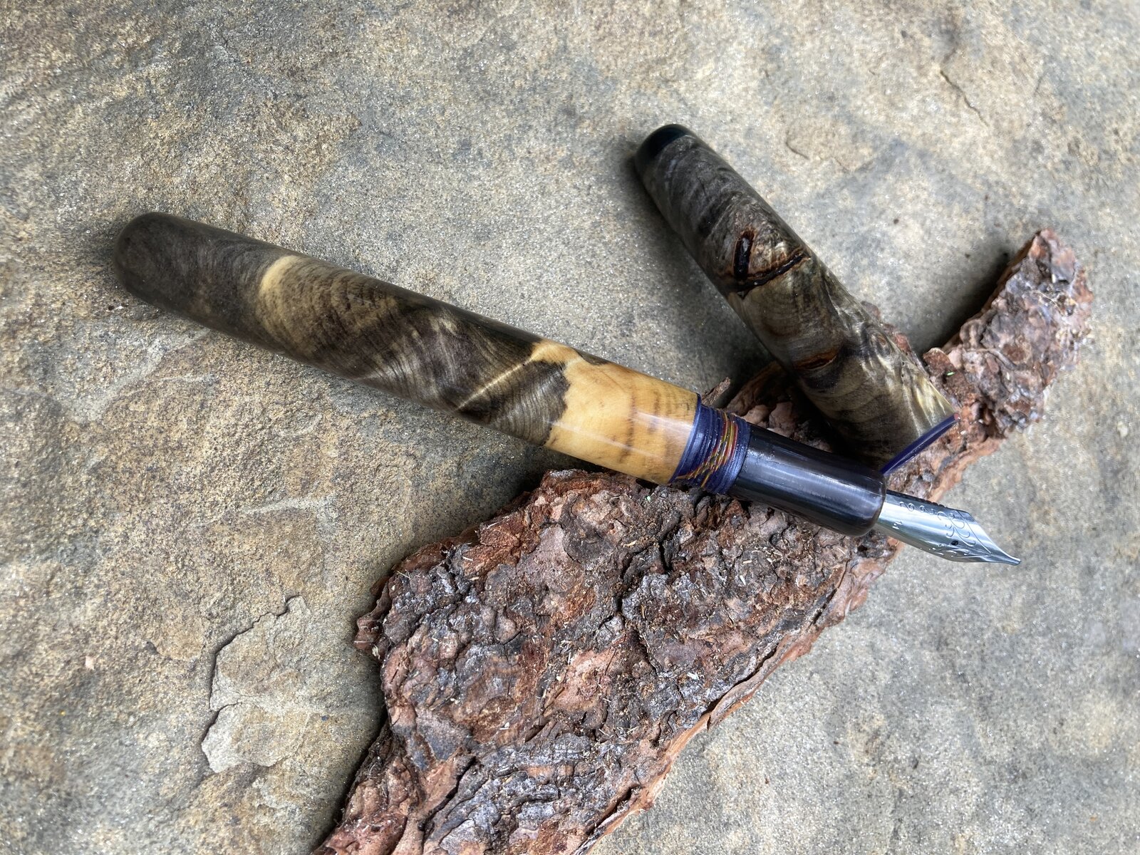

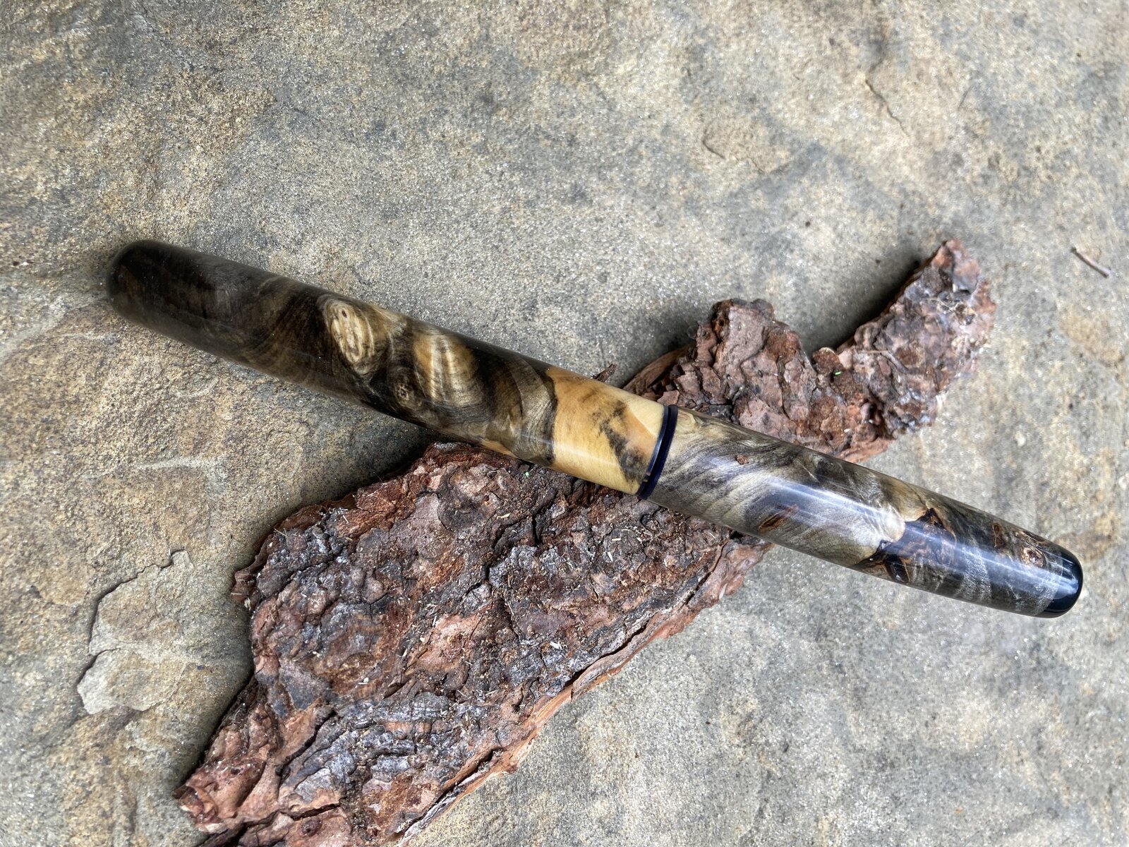

My most recent mistake is a stabilized Buckeye Burl. I like a little longer section and a little longer body but the cap got a little long because I developed a crack drilling for an acrylic insert. Got the insert cut to fit and repaired the crack but had to put a little finial on to hide the repair. I couldn't shorten the cap because the liner would be exposed.
Couple of questions..
Does stabilized wood need an insert?
When the cap is attached to the body it appears to fit well but you can feel a little difference in the fit when you turn it in your hand. 13 mm triple start threads. Is this typical?
Thanks, Jim

I think it's best to use an insert instead of threading the wood because the wood threads can get damaged over time. When you say you feel a difference in the fit, do you mean it feels out of round?
I always use an insert in wooden pen caps (I also line the barrel too) only because, having learnt the hard way, even stabilised wood can dry out fountain pen nibs very quickly. I think it varies between woods.
You can get away without using an insert by coating the inside of the cap with lacquer but I didn't enjoy doing that as I found it quite fiddly to do.
