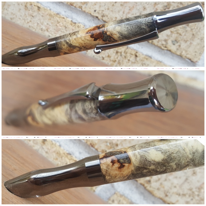

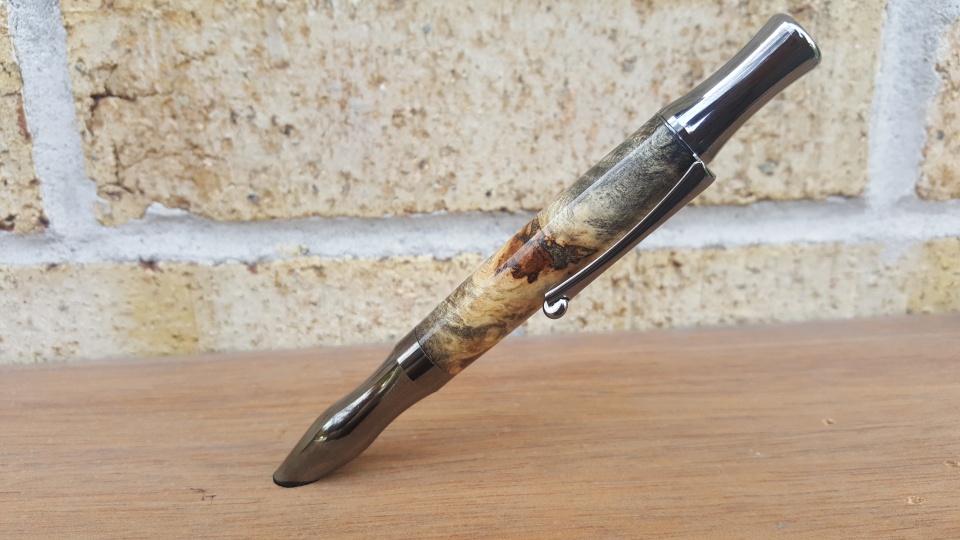

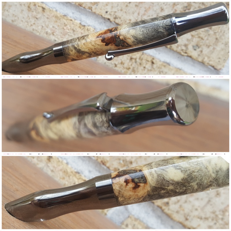

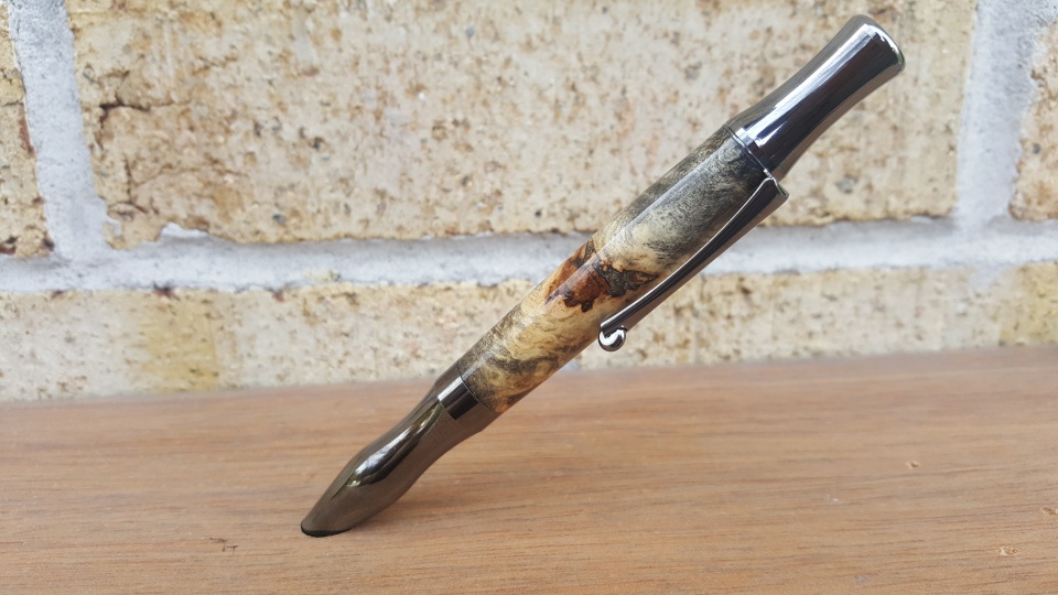

This is my most recent pen (Princeton) made with dyed buckeye burl that we scored in a grab bag.

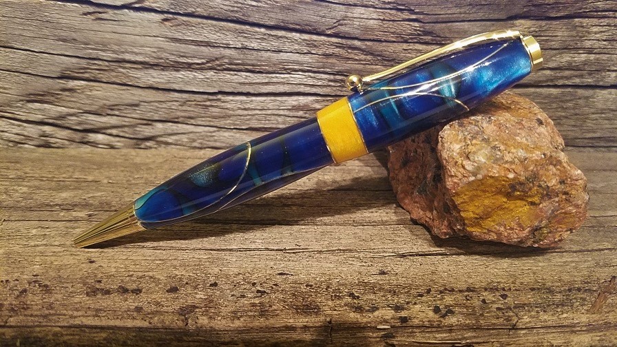

The slimline pen kit is your friend. Less than two dollars each. (Go with chrome, it holds up best) Learn to modify it. Throw away the center band, and you can make it any size or shape you want. Use cutoffs from other blanks and turn your own center bands. Cut a aluminium can into pieces, scuff up both sides, and glue it to both ends of the center band before turning, it will separate the types of wood or acrylic without leaving an ugly glue line. You can also use construction paper, old gift cards, or anything else you can come up with. (I enclosed a picture of one I have done.)

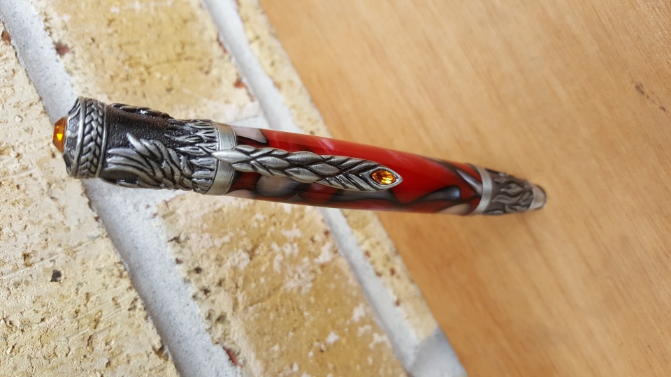

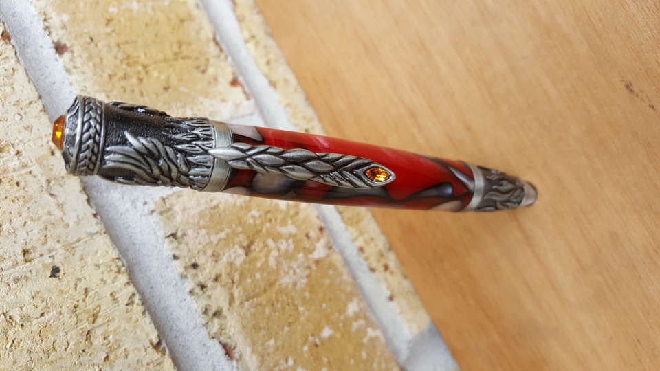

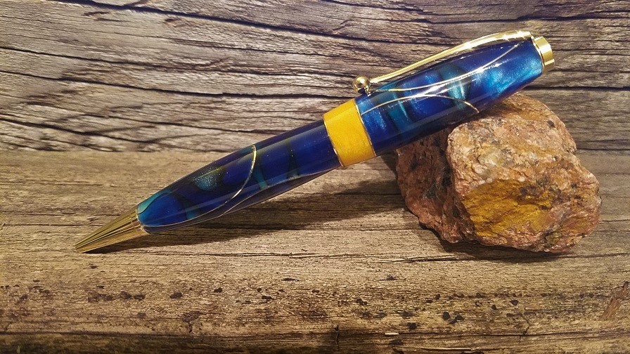

I'll try to attach some pictures of the pens we have done.
