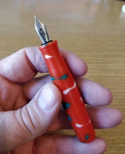

Anyhoo, so, the sum total of my turning experience as of this morning was rounding four pieces of scrap down to cylinders. I just got a tap for the Jowo #5 I was planning to use for my first pen, and today I went out with the idea of practicing drilling and tapping on some scrap. I grabbed the shortest, ugliest piece of scrap I had, and got started. Well, things kept working, so I kept going, and I before I knew it I kind of accidentally ended up with a miniature, ugly fountain pen.
It's just a one-piece eyedropper filled through the nib end. Super simple. But it's my first pen, and it writes! I love it!

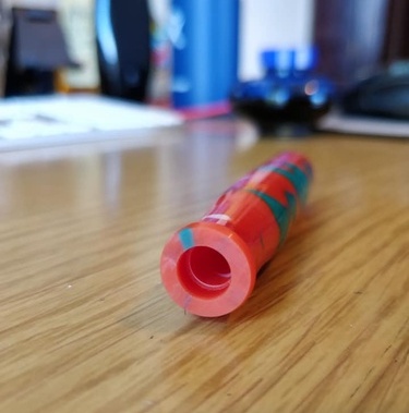

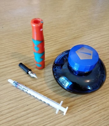

here are more photos... it's so simple, it's just a tube with a nib in it. No section, no nothing. I wanted to make a pen, and this was an easy way to start learning! I'm going to make a friction fit cap, but I need a bigger drill bit than I own...
You can see the stepped drilling for fitting the Jowo housing. Three drill bits and a tap for this, lol! And I forgot to add a little ring for the collar.
Ready to fill with Namiki Blue!

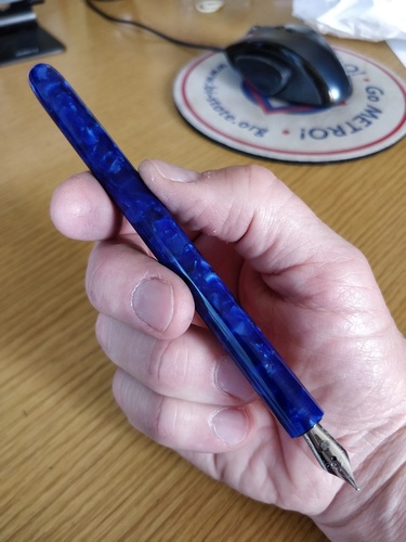

This went so well I made another pen! 😯
I really didn't expect this to go so quickly! Wait until I start trying to make caps and sections...

That's the beauty of the eyedropper filler -- the ink just goes in the body of the pen!
I drilled a 6mm hole about 2-1/2 deep, which would fit the nib unit plus about 1.5 ml of ink. (That's actually a fairly generous amount, compared with a typical fountain pen cartridge or converter.) Then I drilled and tapped to fit the nib unit, which is threaded so it can be removed and reinserted easily. Then you just fill up the pen body with ink, put the nib in, and start writing.
Most fountain pens have a separate grip "section" that holds the nib unit, and that screws into the pen barrel. That's a pretty complex piece, since it has to be threaded for the nib and for the pen barrel. I'm sure I'll get to that pretty soon!
