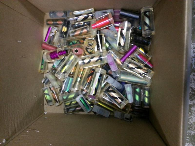

The picture below represents about 6 months of experimenting and about $1000 in materials. They are all failures. Polyresin, Alumilite and Epoxy. And the box keep getting more tossed in as I try new things, and sometimes just have a bad day.
Failures? Care to explain. I see a few in there I'd liek to call dibs on, if not all
cheapest? yes
easiest? depends on what you mean by easy. Its messy, smells horribad, is toxic, can be finicky with getting the right amount of catalyst for your ambient temp/dye/color socks you are wearing, etc.
Not trying to dissuade you, but want you to know how complex this area of the "craft" can be.
Bubbles
Delaminations
Melting (PR will eat some materials, including base paint coats)
Bad Resin
Wrong Resin (I tried several other types other than the standards we use)
Seams peeling up
etc.
They look great from afar, not so much when you have one in your hand.
