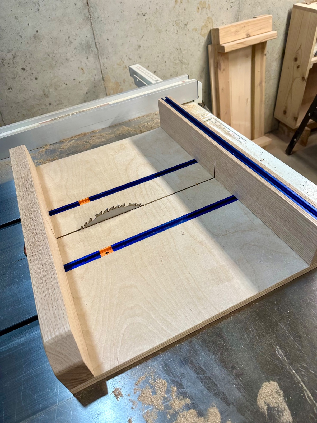

This is a work in progress. I just started and nothing is attached yet. I decided to go with plastic runners and they have not arrived yet. I'm also trying to decide if I want to add any features, such as T track in the base or maybe a replaceable zero clearance insert. Adding T track to the base will weaken it, so that's a con. Adding a replaceable zero clearance insert might be difficult to keep everything flush so that's also a con. My old sled had neither and it was perfectly fine so I'm leaning toward just keeping it simple. Does anyone have those or other features in their sled? If so, do you find them useful?

Yeah, that's why I'm considering T tracks, but honestly I don't think I'd ever use them. I already have better ways to cut very accurate angles. It's more than likely this will be just like my old one, just simple. One thing I'm doing different is to not glue down the back fence. That will let me re square it, if necessary.
It seems like I build a lot of sleds but the usually don't get used very much before I build a different one. I use smaller sleds on my bandsaw far more than I use the larger sleds on my table saw. Since I don't use them very often I typically make the runners out of oak moulding that is made for wooden screen doors. It seems to fit my miter slots almost perfectly at 1/8" x 3/4"and it is radiused on one surface which makes dropping it into the miter slot a breeze. I have put t-track on several of my sleds, typically so I can add a hold down clamp to keep my fingers away from the blade and so I can lock in a stop of some kind for when I'm doing repeat cuts. - Dave
Mine is similar and I did put two T-tracks in it running parallel with the cut, one on each side of the blade. I really like having them for hold downs.
Ken; I don't know how thick your base is. Metal Incra slides mounted so the fit of the slides adjust from above.. I put a grid pattern of 1/4" x 20 TPI T-nuts through the base on my sled. I have made a blank cutting jig and an adjustable fence that can attach to the sled. I also made studs and clamps for clamping down odd shaped work pieces,
Mine is even simpler. No T-track of any kind. Because of the 3/4" thick plywood you can nail/screw temporary fixtures and fences as needed, pull them off when done. I did stair stringers for my decks that way. My runners are just waxed hardwood. I can see using T-tracks etc if doing the same kind of work a lot but my stuff varies and tends to be one of a kind.

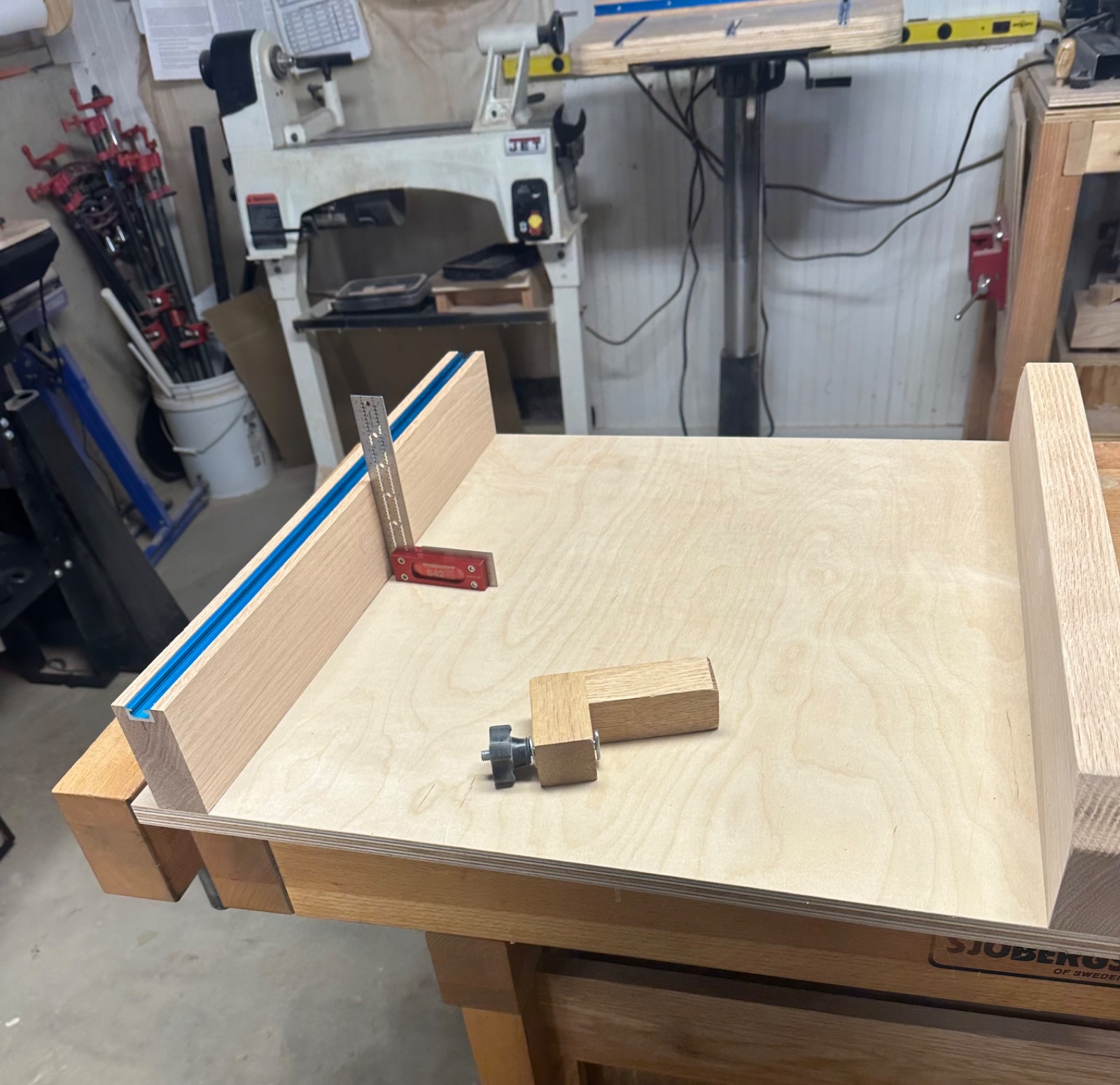

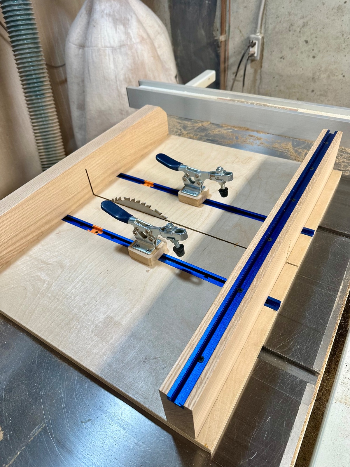

Sled is coming together, all that's left is to attach a blade guard tomorrow. I finally got it square within .002. That's a story though. I fell into using a squaring calculator online that was a fiasco. I moved things exactly as the calculator said it never worked. After a good two hours, I went old school with my trusted square and it came together quickly. The old ways are usually best. I did decide as you can see to install a couple of t tracks. Don't know if I'll use them, but they're there if I need them.
