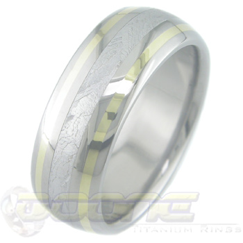

Here's a new one for me. It has two inlays of 18K yellow gold with a wider inlay of Gibeon Meteorite in the center. The meteorite is from outer space and is over 4 billion years old. It's a metal very similar to stainless steel. It gets its characteristic crystalline patterns from it cooling so slowly over millions of years while in space. The addition of the gold on the titanium rings adds a bit of a fancy flair.

Another nice piece. If it is not a trade secret, how do you bond the different materials together??? Curious in that can the method be carried over into pen making??? Thanks for showing.

That's super cool for sure. Do you have to etch the meteorite to get the Widmanstatten pattern to show up, or is it visible after polishing? Do you actually have to machine out the insert ring from the meteorite, or is it possible to cut a strip and bend it? I would think the first option would be prohibitively expensive even for jewelry, but I might be wrong.

Thanks guys. The meteorite Is cut in a strip and hammered into an undercut groove then laser welded. It is etched to bring out the Widmanstatten lines. The acid doesn't affect the titanium.
