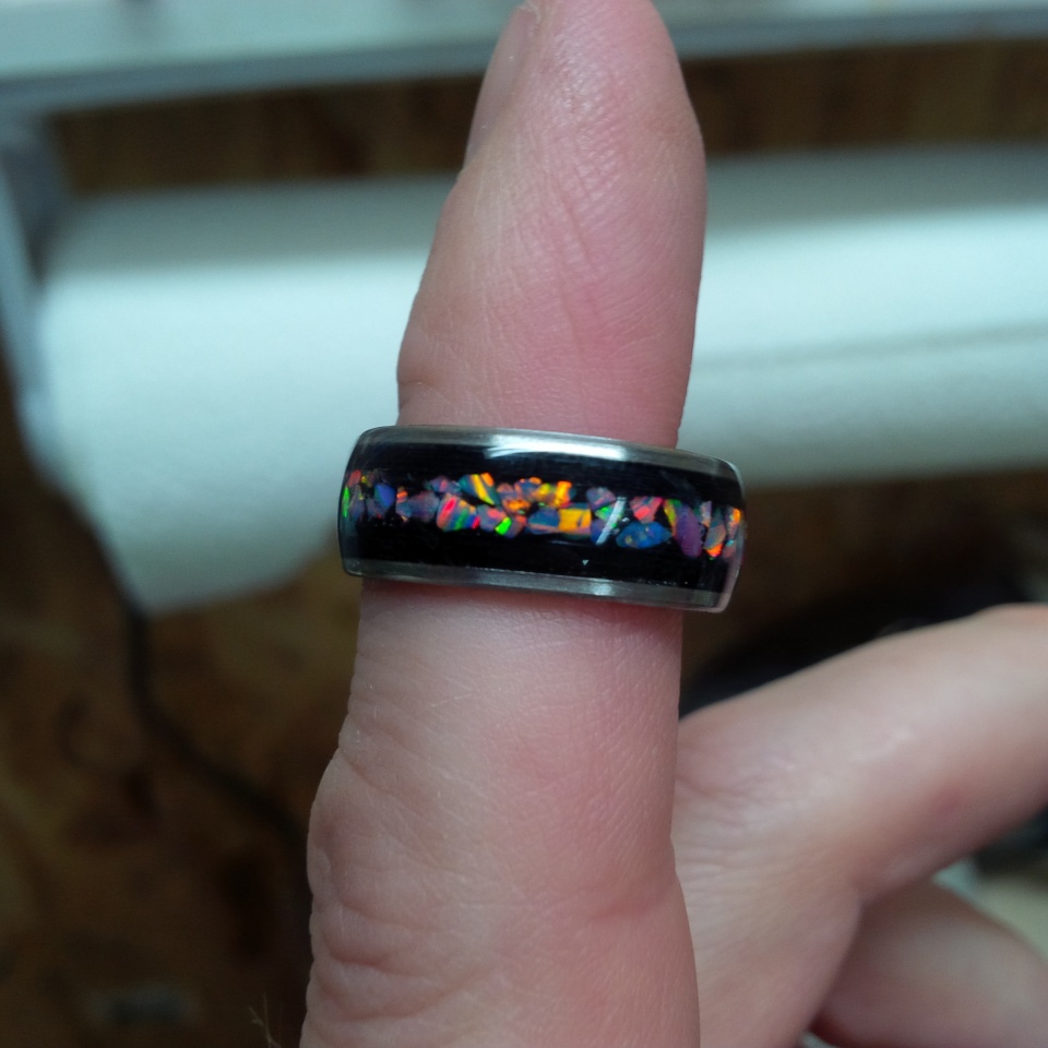

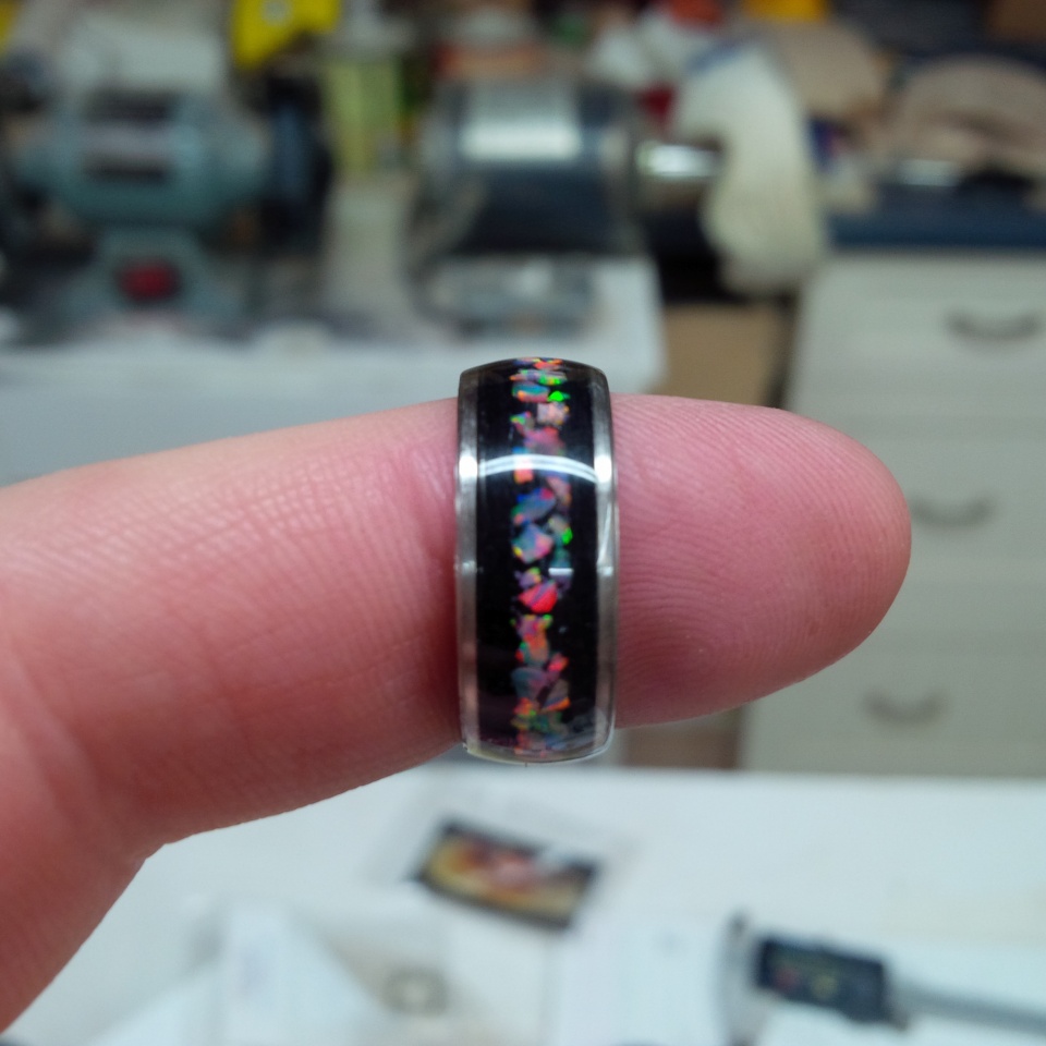

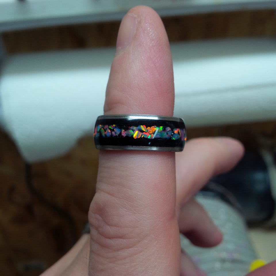

Metal core with bentwood black dyed pearwood ring with an inlay of synthetic opal. The opal glows and looks like it is on fire as you rotate it in your hand. I will definitely be adding these to my Etsy shop.

Thanks Steve. I took the extra time on this one and placed each piece of opal with tweezers which gives a bit different look than sprinkling the fines for the inlay. There are a ton of possibilities with the inlays.
In regards to the finish I actually put it all together then turned the wood down to meet the metal core. After that I sanded and then applied finish so there is CA glue on the stainless steel. I don't know how well it will stand up but my wife has it to wear and test so I will see if the glue comes off the metal or starts to look bad with use. I did not like going this way but didn't have much choice on this one. I have 2 more to play around with and am planning on the next one to completely finish the wood before sandwiching it in the core. This will require some very precise measurements but I think it is possible. My only concern is if the seam between the wood and metal will allow water penetration. At least with the way I did It on this one I know water can not get in.
