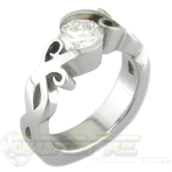

Here's a new ring I did where I used the laser for the cut throughs. It's a tension set, meaning that there is no bridge between the arms holding the stone. The strength and spring of the titanium alone hold the stone in place.

Bruce,
Sorry to ask but is this a ring designed for the woman or for the man. It has some aspects that make me think it could go either way.

This was for a woman. It's hard to see in this angle, but it has a Euro shank, which are corners at the bottom that help to keep the ring from rotating on a finger.

Beautiful ring as usual! Just wondering if rapid significant temperature changes could cause the metal in the ring to expand or contract either putting too much pressure on the stone or allowing the stone to become loose and possibly fall out?

No, that doesn't happen with these. If the ring expands with temperature, the prongs can simply bow further out if they needed to. The expansion might be a thousandth of an inch or so. There is something like 70 pounds of preload on the stone, and that won't change significantly with temperature. The stone will still be tightly gripped, but not enough to cause damage.
