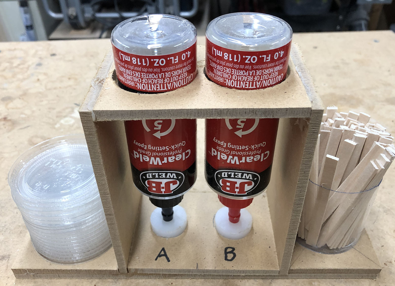

Hi all,
I was just fidgeting around in the shop this afternoon (avoiding a pen repair that I need to do) and decided to put together a new, revised, epoxy caddy. The revision was essentially to shorten the container for stir-sticks. I have had a dickens of a time finding them, and of course like all other things, inflation has hit the price. They are normally 6-inches long, so I figured that certainly a 3-inch long stick would suffice for mixing little bits of epoxy, so I cut the bundle in half.
I use lids from small condiment cups to mix it on/in. I also turned a couple of HDPE buttons to rest the cap/tip in. I figured that leaks or drips would be less likely to glue themselves firmly to the HDPE than on wood. That way I can also pry them back out and clean them up with solvent if needed.
Dave

I've used blue painters tape and squares cut from a sheet of silicone to mix on, but the little plastic lids were surplus and in abundant supply. I like them better because they confine the epoxy better than a flat surface and I find that it mixes more thoroughly because of the shallow dish shape it has.
Dave

Your Epoxy Caddy is well thought out. I may have to give it a shot. šŸ˜
Your solution is pretty much what I was going for. I was always struggling with getting the epoxy to the tip of the bottle. The caddy just started out a stand so I could keep the bottles inverted. The storage for my mixing lids and sticks was just some gravy I added on. - Dave

Will epoxy stick to HDPE? Could make a small depression in a 3" x 3" x 1" piece of HDPE with a large forstner bit, or secure the rectangle of HDPE in a 4 jaw chuck and turn a depression with sloped sides.
I don't know how well it would stick to HDPE after it was mixed. I was thinking silicone simply because it is flexible which should make it easy to peel off of the cured blob. For the lid buttons I used HDPE because I can toss it into a jar of acetone to clean it off if I need to without any negative impact on the HDPE. I also use HDPE finishing "cone" bushings when I apply CA for the same reason - acetone cleans off the dried on CA without degrading the bushing. - Dave

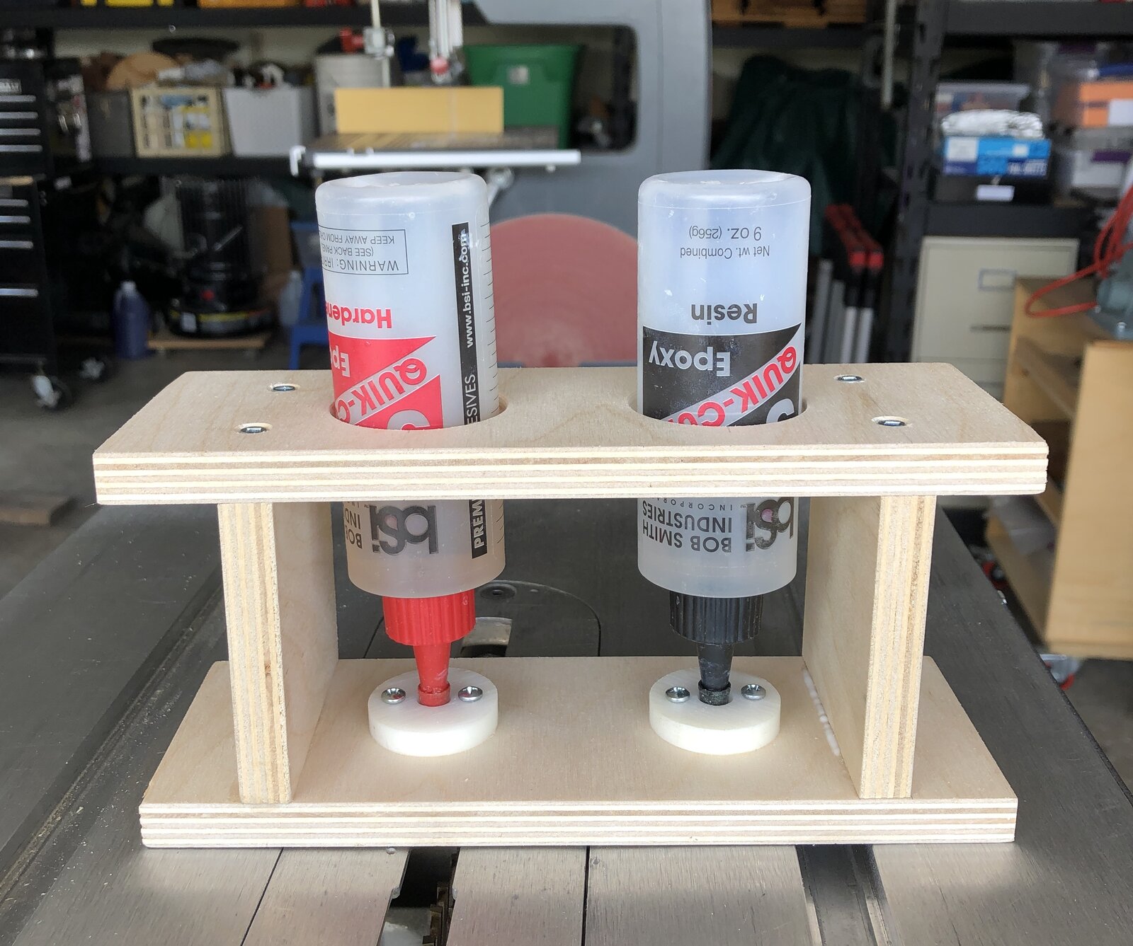

I made an epoxy caddy this morning inspired by Dave's design. Now the epoxy is ready to dispense whether the bottle is full or 1/4 full. As a side note, I mix epoxy on 3x3 Post-It notes. Tear off the note and you have a fresh surface for mixing.
