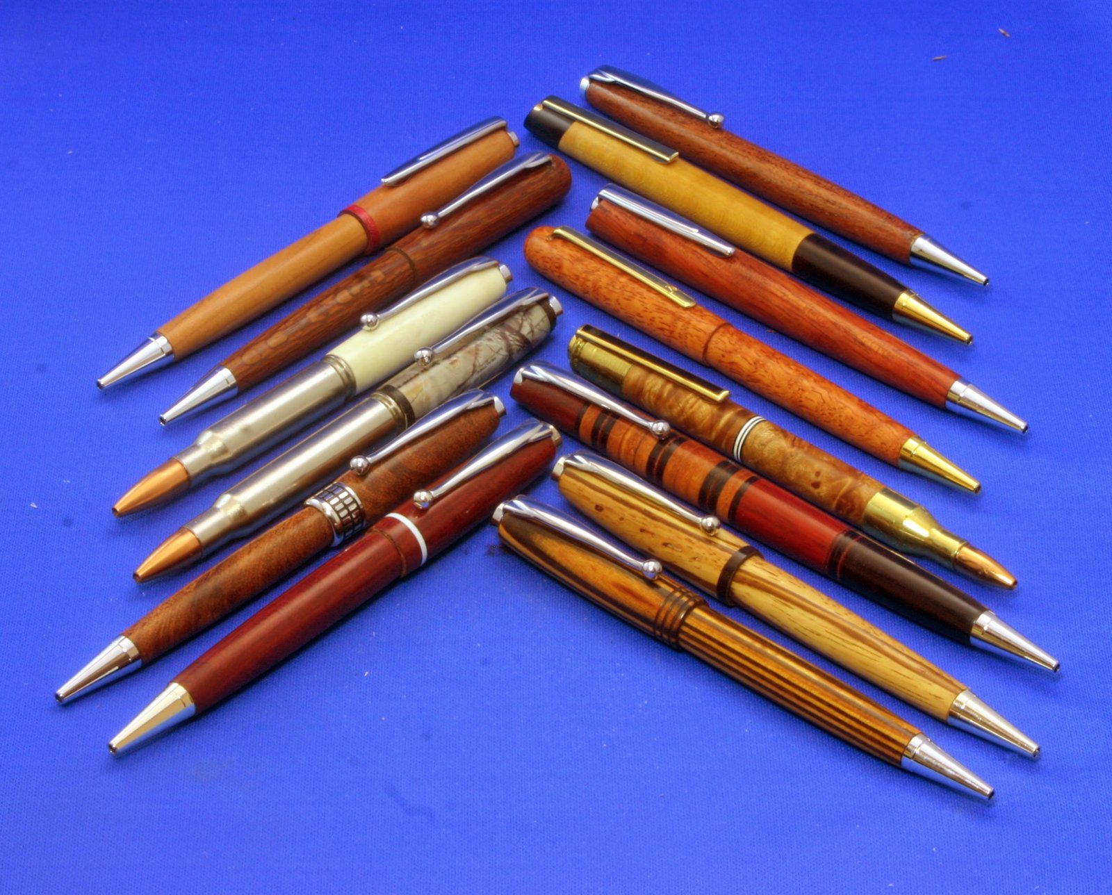

Mal and Kenny,
Not sure what modification to the bottom of the pen Kenny was referencing. There is not much that can be done with the bottom (nib/writing end) if the cone is not removable. I have made single piece pens from most all of the popular twist pens: slimline, cigar, perfect fit, jr gent twist, el grande twist to name a few. I have made the SLimline Pro click into a one piece but the nib cone is screwed on so it can be removed to change the refill.
I looked at the instructions form the Groove and with neither the clicker nor the nib/cone being removable then making it into a one piece is not promising.
Several of my modifications can be found in the flib here or in the files of the FB penturning or casting groups. There are several articles on my website and the address is in my signature at the bottom of this post.
Contact me with any questions and I will answer them. I have written a column called "The Penturner's Carner" for More Woodturning Magazine since 2006 so I have a lot of articles and I need to get more of them in the library here. I just submitted 4 this past week. April 2020 is the last issue of More Woodturning Magazine. It has been fun.
Do a good turn daily!
Don
All are made with slimline kit parts.
