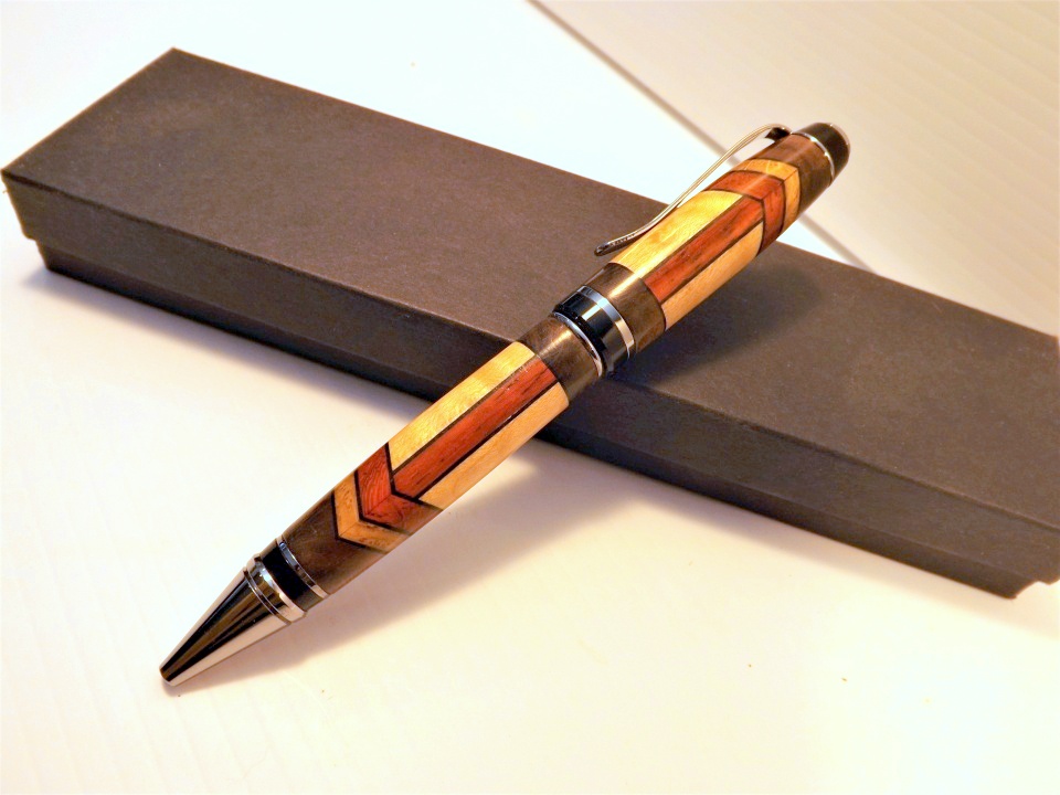

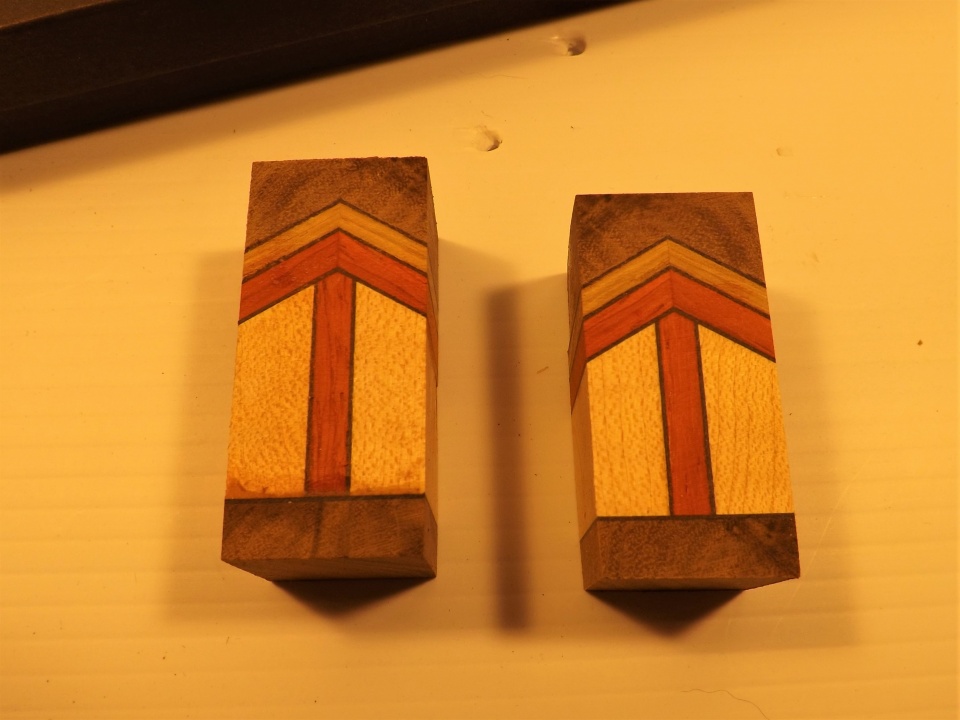

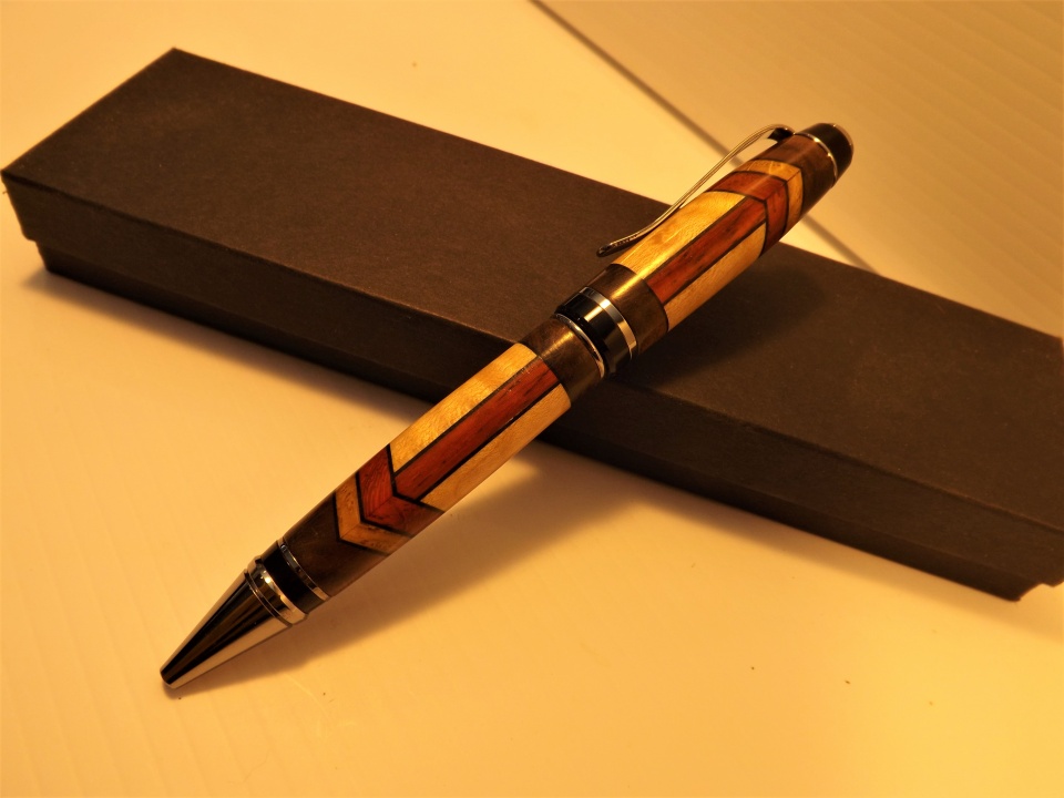

Playing with a Gisi(ish) style pen blank, started off simple enough made of walnut, white oak, padauk and maple. I didn't want to waste an expensive kit on an experiment, so built it on a simple cigar kit in titanium. I like the way it turned out and will do the other blanks I have left over on some better kits.

How do you cut the perfect "V" in the block at the top end of your blank ?
I cannot see any join in that piece, although I can in the smaller V-ed pieces.
I have never done any of this design.
But... I have viewed, many, many, many of this design - and yours is MUCH more precise than others that are thought to be "well done."
Ya dun well!!!
Very NICE!
A Very Attractive Pen.
Superb Choice of Materials, Pattern and Segmenting.
Beautifully and Precisely Applied as a Blank.
Outstanding Accuracy, Fit and Finish.
Congratulations.
I just used the table saw, careful to adjust the depth to only go 1/2 way through. I did use a much wider piece and cut off the v-block when done.

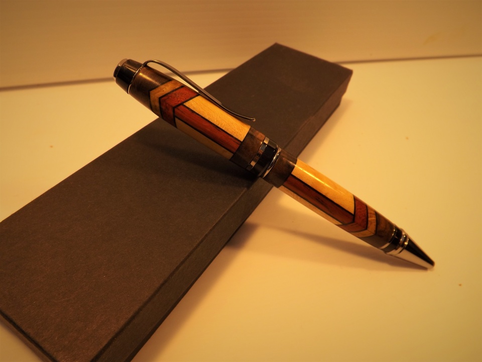

Very nice job! The pen looks great and the joints are very precise. Great color combination as well. The photo is a bit dark and off-white... easy to fix with a photo editor (before and after pics attached below). I see your latest photos are looking much better. Keep up the great work and congrats on the front page!
