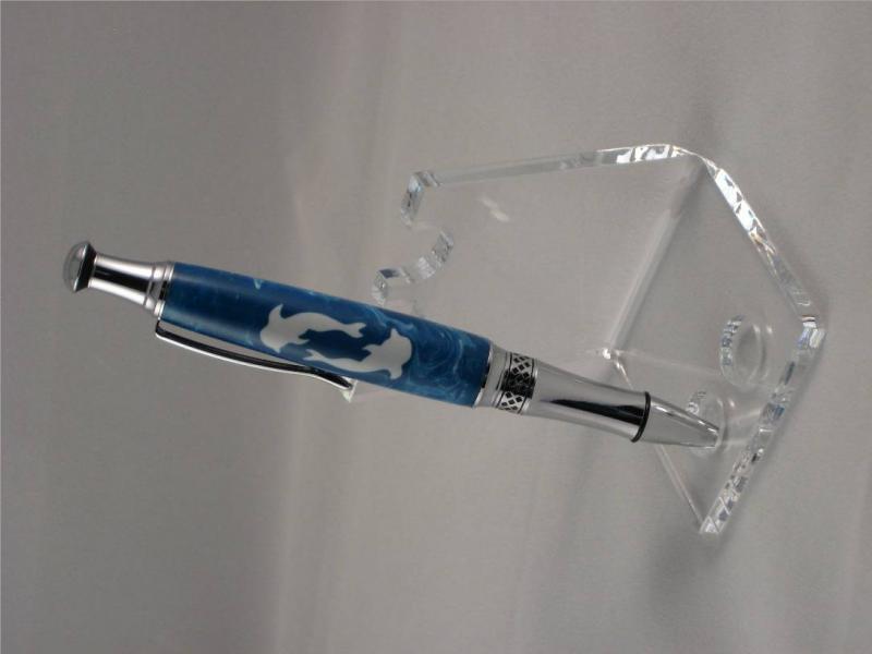

JasonJ
Jan 17, 2010
16
Iowa
I agree... the nib end is much wider.
Here's one I did a month or so ago. I like the kit. I bought a bunch of them when they first came out.
