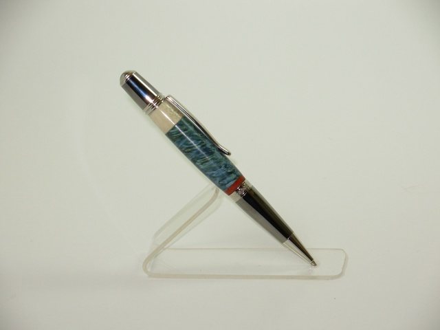

This pen is the result of scraps around the shop and for my own use. But the display stand is something I made tonight following Dario's direction on a recent posting. Super easy Thanks Dario!!:D

G'DAY Bernie its good you have found a use for your scraps' l do the same. your pen amd stand looks good. l better find Dario's post.I also would like too make a stand.now with your pen there is one thing l would of done. That is put the white between the red and blue. but thats just me dont take any offence mate. [:)]

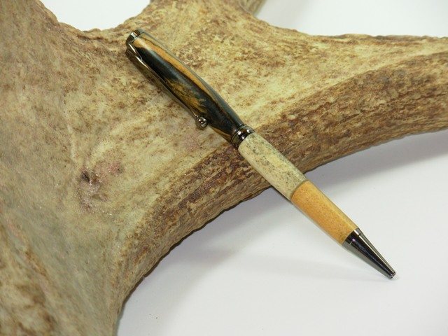

Thanks JC... I agree with the White Antler in the middle but the BEB was the largest scrap so I put it in the middle. I have another scrap slimline from tonight. More Antler with BOW
