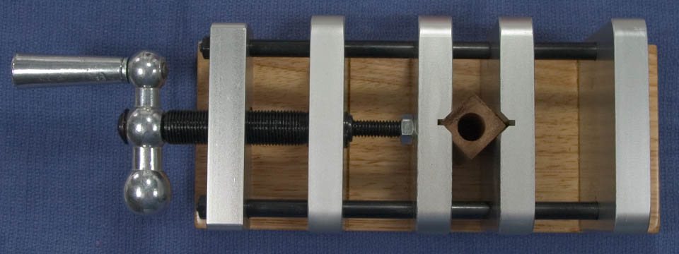

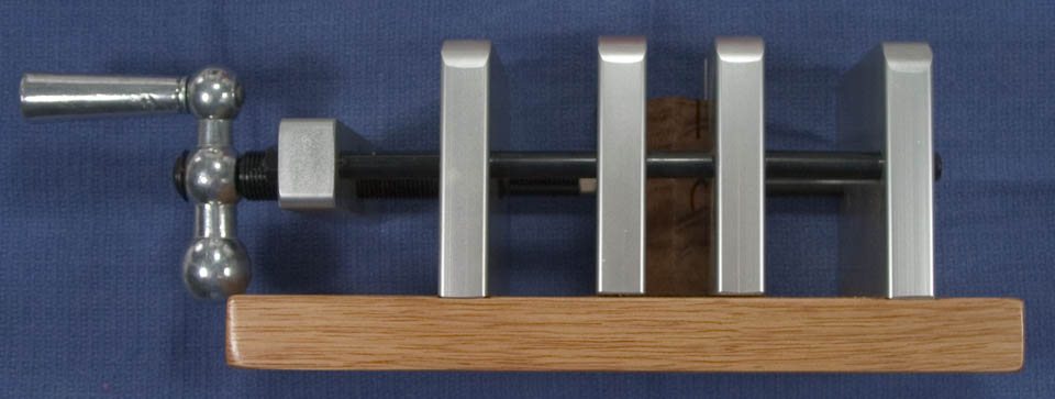

Ok, I drilled the 13 sets of blanks (26 holes) that I mentioned above and here are my initial thoughts.
1) There is still some slop in the system. The large threaded shaft ends in one of the stationary plates and is held in place with a C clip so that it can rotate in place. This is where the problem is. There is some slop at this point which allows the two moving plates that are the jaws to move as a unit. I measured the amount of movement and it is between 0.006" and 0.008". I noticed this because I saw the jaws moving back and forth slightly when I was drilling the holes. I was worried that it would make the holes oval but I measured the hole diameter on several blanks at several different angles and couldn't measure a difference.
2) The two plates that are the jaws go all the way down to the wood base. This makes it harder to use a scrap of wood under the blank to prevent blowouts. Its still possible but less convenient. Not to big a deal for me since I don't drill all the way through (I cut the end off using a jig on my miter saw to eliminate the chance of a blowout and to size the blank). Just wanted to mention it since it might be an issue for others.
3) The overall function of the vise is great. Easy to use, holds the blank very firmly and the handle style makes it very easy to open and close the jaws quickly. I still feel that overall the vise is well built and is heavy duty. We'll see how it holds up over time.
I plan to make a modification to try and fix the slop in the system. Maybe something like a 0.005" teflon washer behind the C clip. If I figure out something that seems to work I will post the details here.
Todd

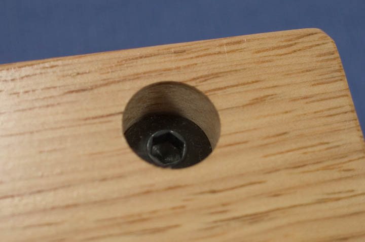

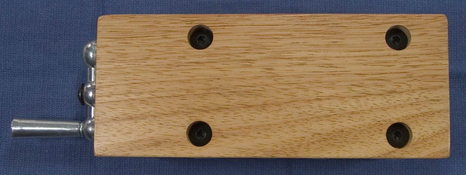

Thanks for the information, Tod. Does the vise come mounted to a base or is that something the new owner has to do? How is the vise mounted to its base?
Could you put some sort of spacer under the vise mountings to raise it up enough to be able to slip a sacrificial block under the jaws?
I would like to see a few close-up pictures of the unit as the catalog picture is not as detailed as I would prefer. Thanks

Randy,
Here are some pictures for you. This is exactly the way the vise came out of the box. I beleive that a new base, a spacer between the wood base and the vise or a cutout in the wood base could all solve the issue of a sacrificial block under the jaws. I haven't taken one of the screws out so I don't know how much extra length there is. You might have to find new screws if you use a spacer.
Todd
