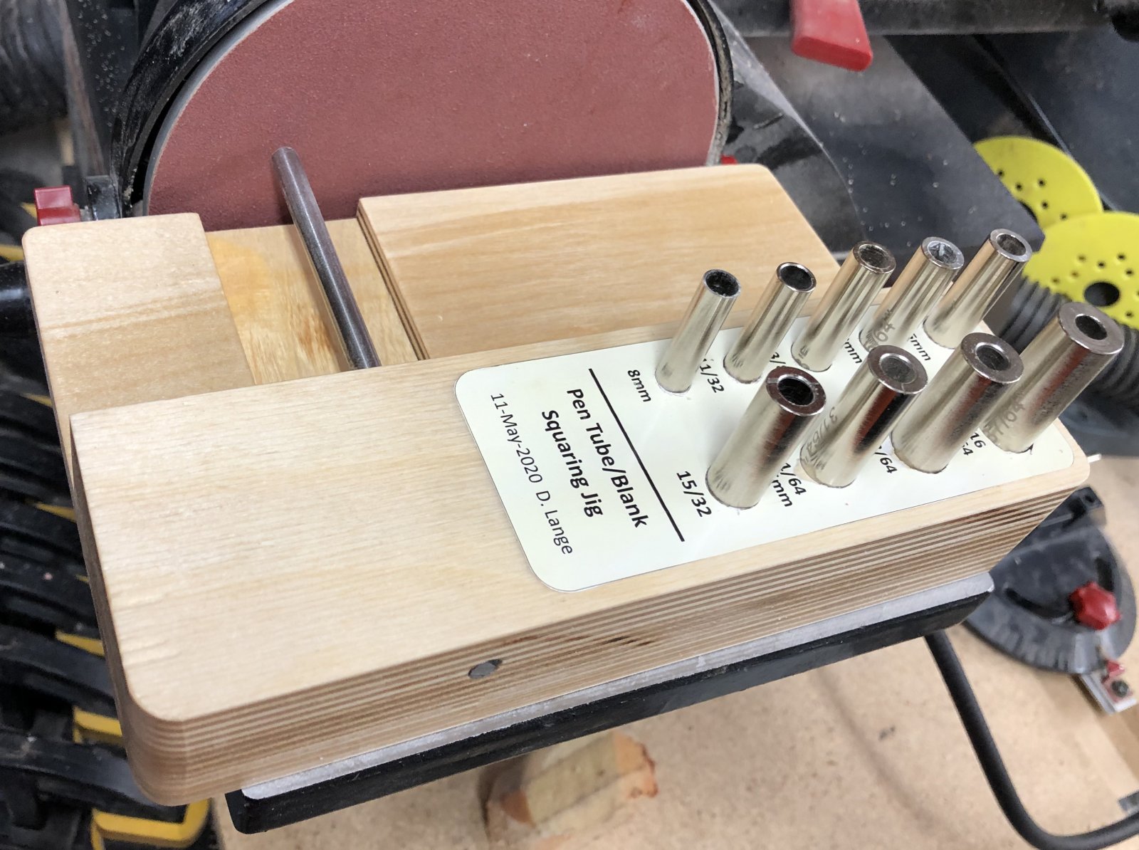

I was inspired by KenB259's recent post of his shop built squaring jig, so I spent my shop time today making a squaring jig for myself. I made the runner out of aspen and used some bits of 1/2 inch Baltic birch plywood I had laying around for the build. The main shaft is a piece of D Drill Rod (0.246 inches). I also drilled holes to store the sizing sleeve set I got from PSI. Thanks Ken for the inspiration!

What I see here is is really what the IAP is all about. egnald was inspired by KenB259 to create this jig. In KenB259"s post he cites WriteOn as his inspiration to create the jig that inspired egnald. POST people, POST! What you throw out there today will be improved upon by someone else tomorrow. We ALL benefit from the collective wisdom of this community.
