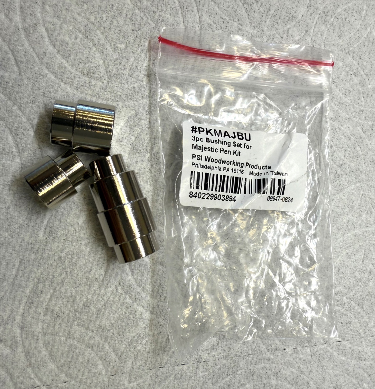

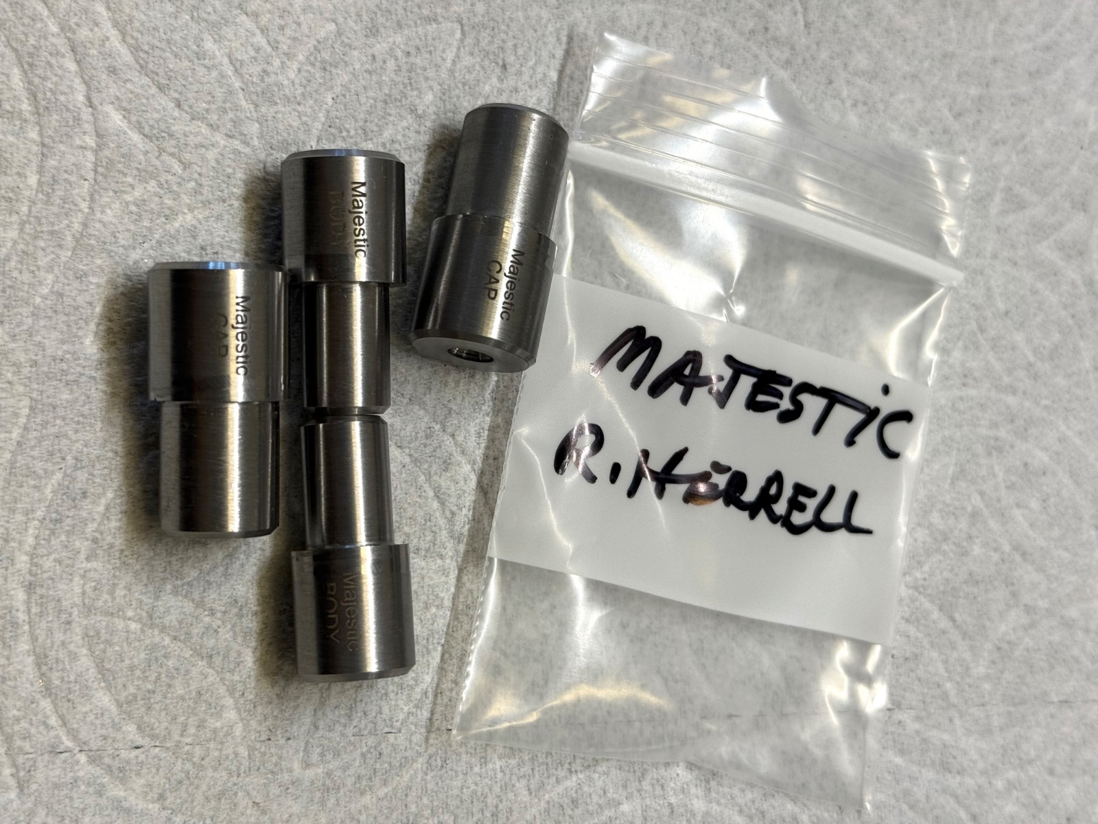

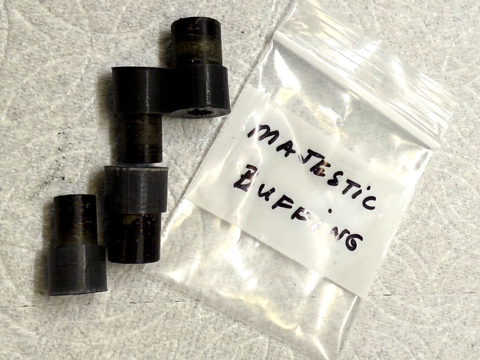

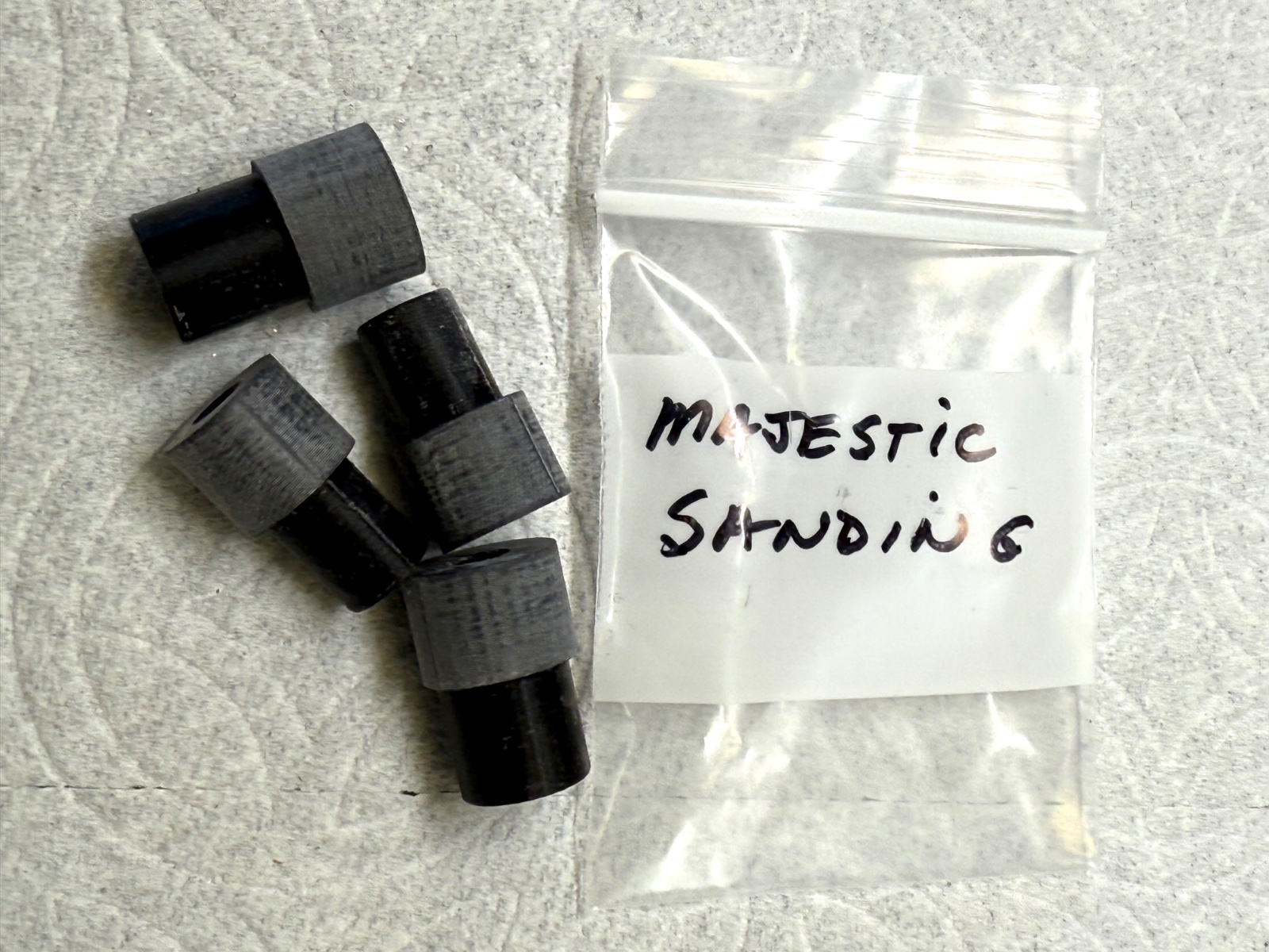

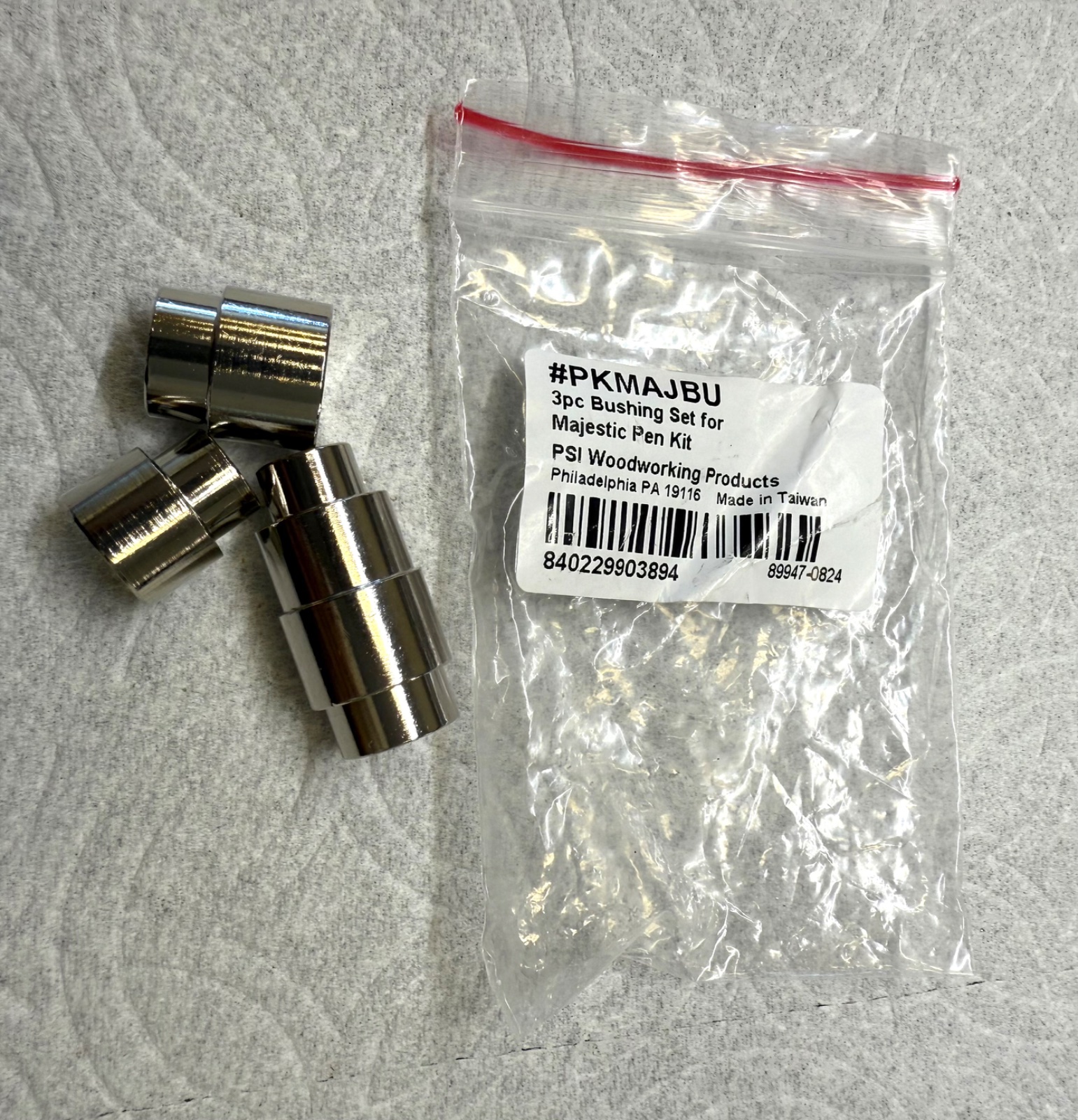

When I get a new pen kit I go through a number of steps before I start turning. I always buy the stock bushings that are intended for a mandrel. I never turn with the stock bushings on a mandrel. I use the dimensions listed on the instructions and the stock bushings to determine the TBC bushings I ask Rick Herrell to make for me. He is the best! I use those measurements to create sanding and buffing bushings on a 3D printer. It usually takes me a couple of tries to get my bushings just right. By that time Rick has my new stainless steel bushings ready.
I turn using the TBC stainless bushings carefully

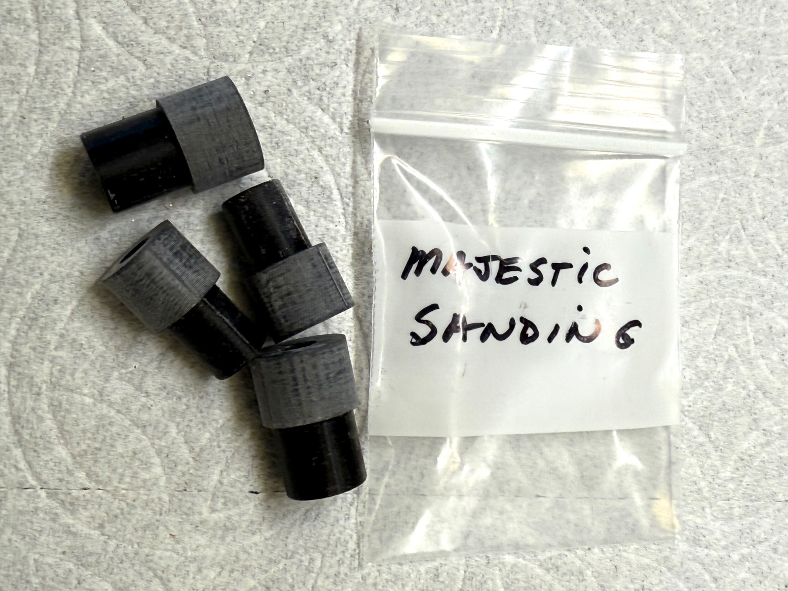

I sand with my 3D printed bushings.
After applying CA finish and flush sanding the ends. I use the sanding bushings again to sand the finish smooth.

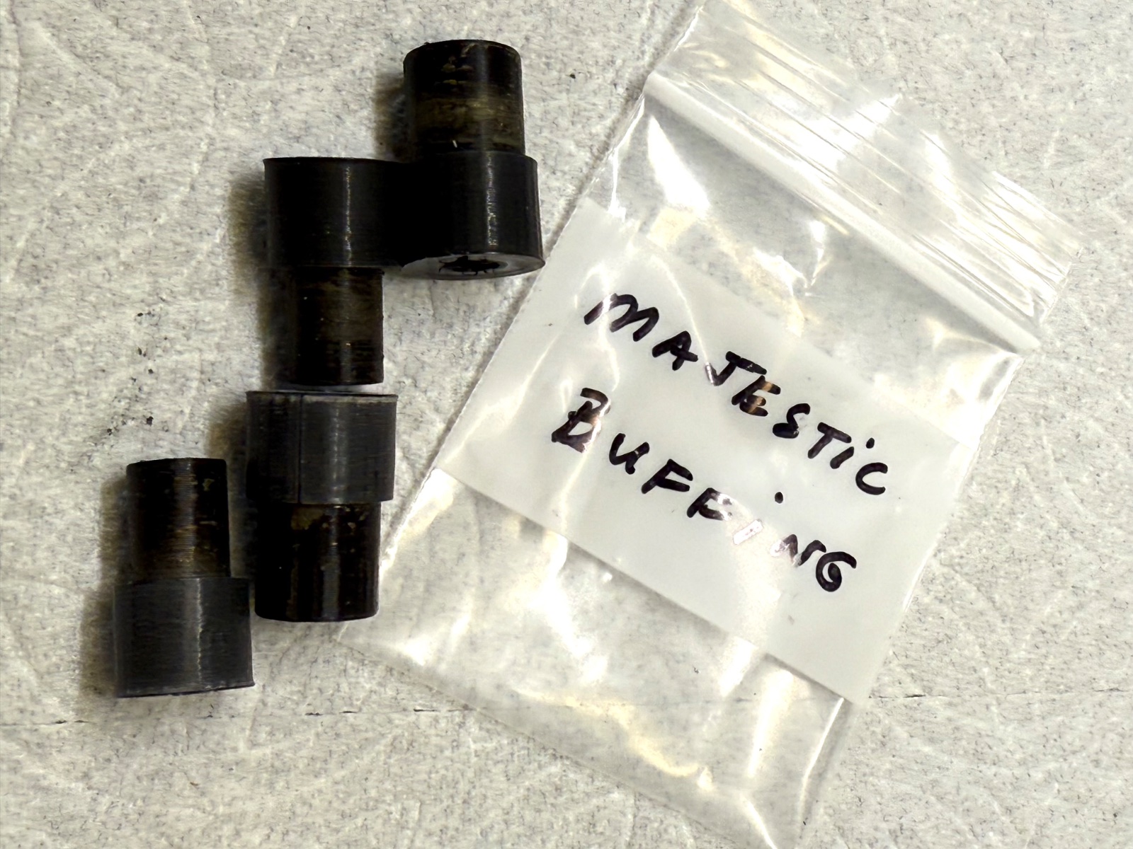

I use the buffing bushings on a baton-like stick to buff them to perfection.

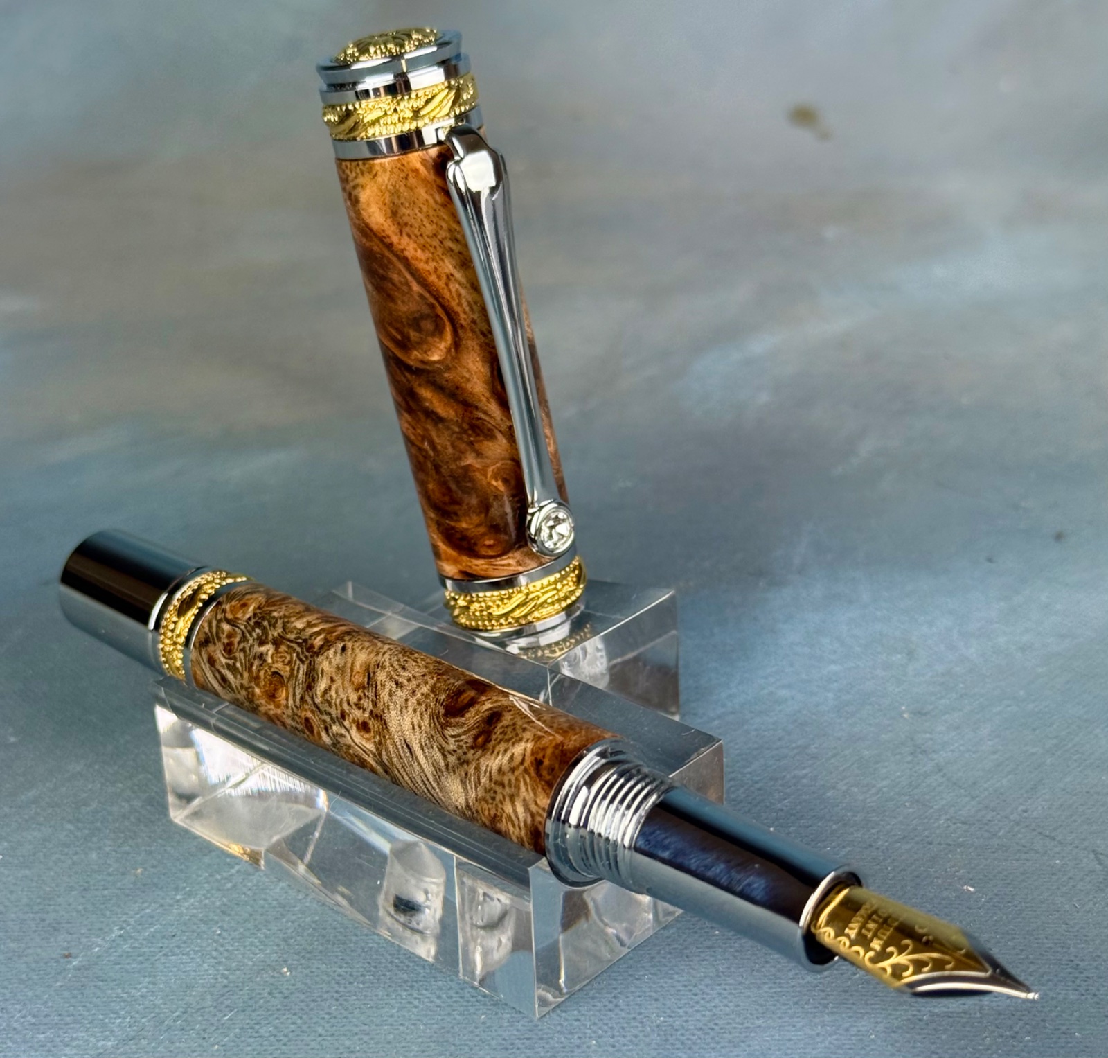

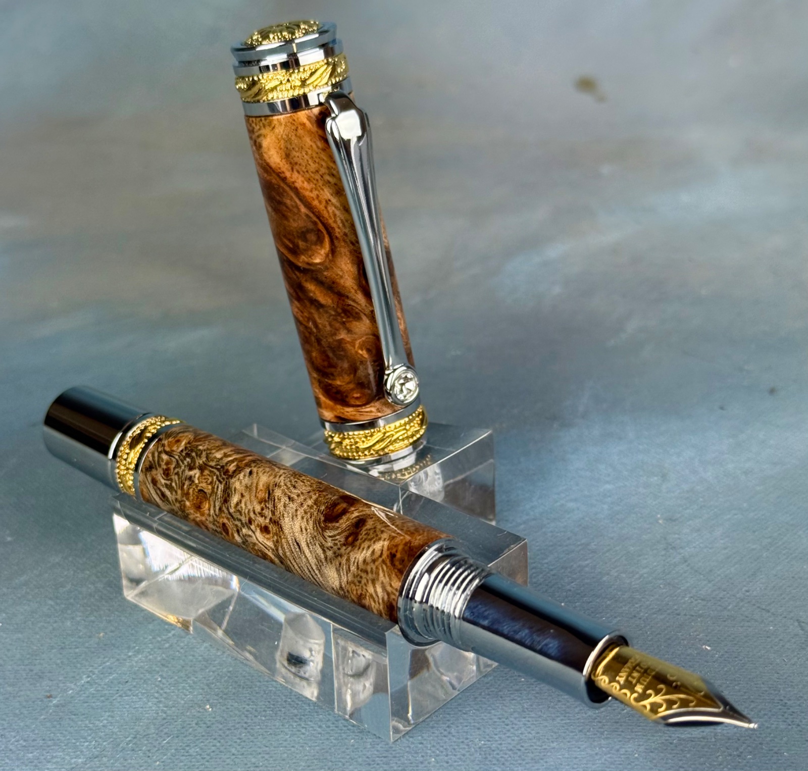

Last photo shows proof of concept.

Curious. In the second photo, the bushings made by Rick (and those made by you on the 3D printer) do not appear to have 60* milling normally used for TBC turning. Do you just use them with a mandrel? Is there a reason you seem to have opted for non-TBC (i.e., without the 60* indentions)?
Actually, 60° milling is not an absolute to use with 60° centers. 60° milled bushings though, do require 60°centers. Before 60° milled bushings were made, standard bushings were used on the centers. John Goodin made the first 60° bushings back around 2008/09 after TBC got started.
They both have 60 degree cones.
