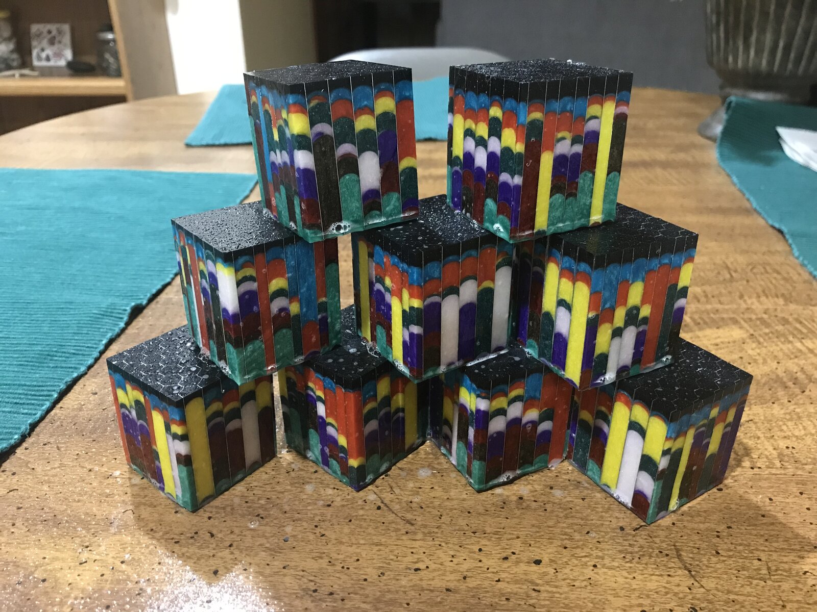

Pretty excited about these!

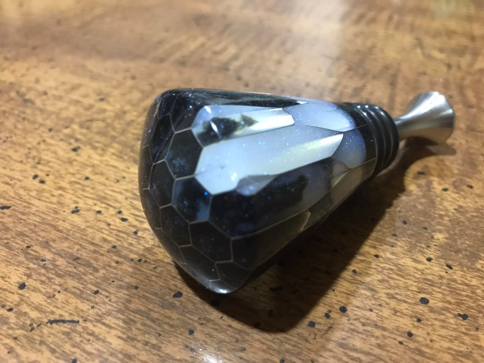

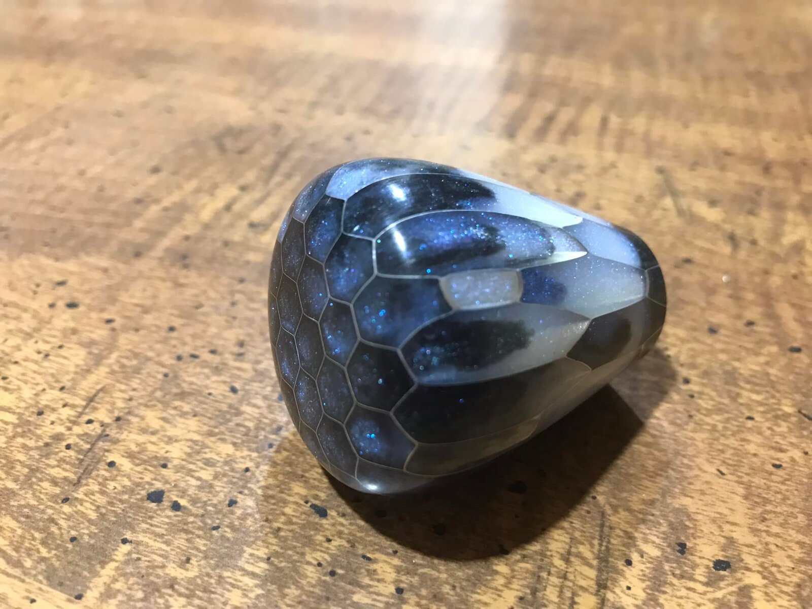

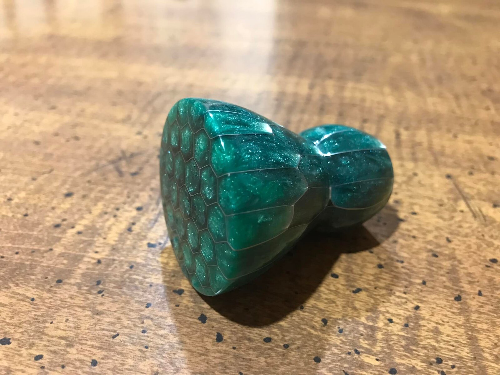

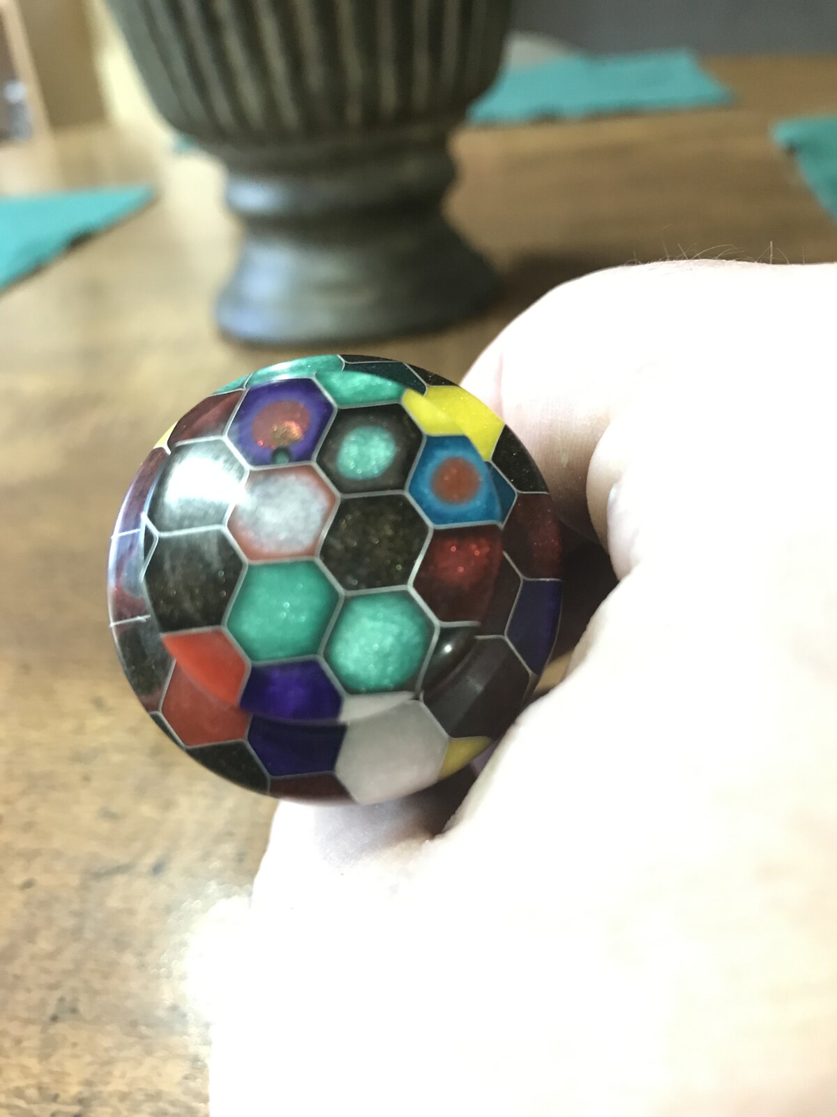

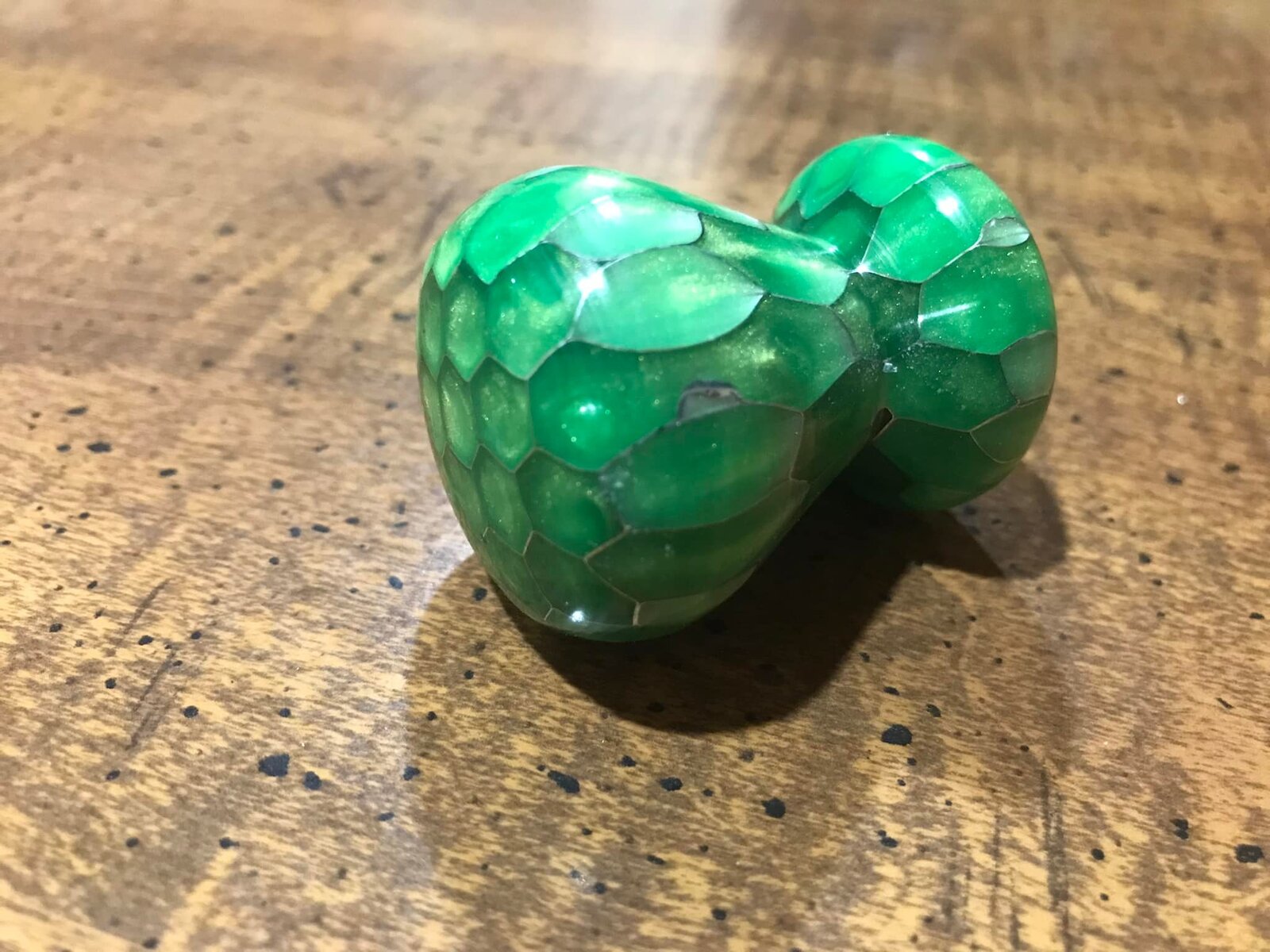

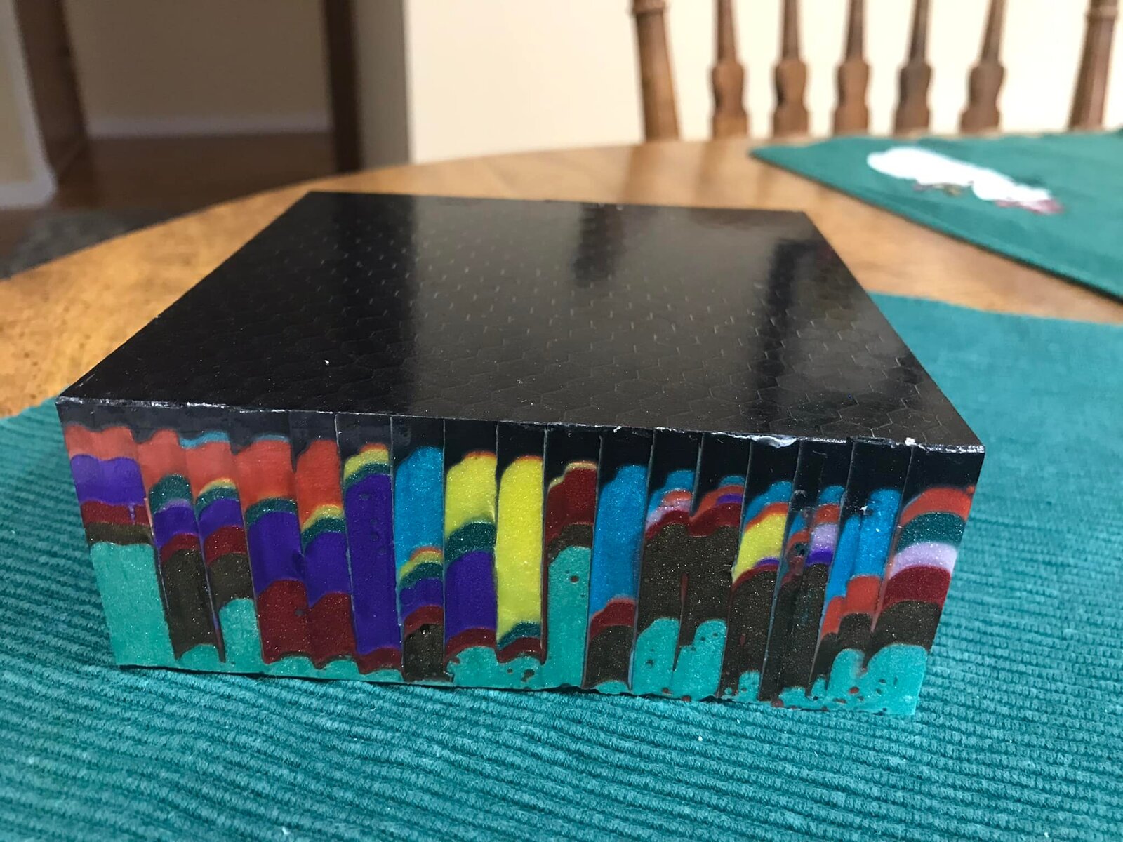

I use my 5.5 x 5.5 x 2" HDPE block mold. Cut the 2" thick Aluminum honeycomb to size. Then mix a batch of alumilite clear slow and pour about 1/8 into each mold. Then insert honeycomb and cure. The resin seals the bottom of the compartments in the honeycomb. Then mix 100g of colored resin and pour random, filling up some of the compartments. My mold holds about 1000 g so I ended up doing 12 pours on this blank. From each block, I get 9 bottle stopper blanks.

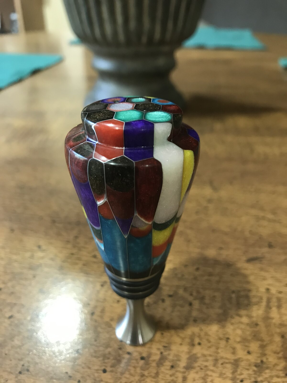

I am not usually a fan of honeycomb blanks as two sides look nice and the others are... 'wonky'. Yours are amazing! I am a fan. I love the stoppers you displayed - very nice! 👏 👏 👏 👏
