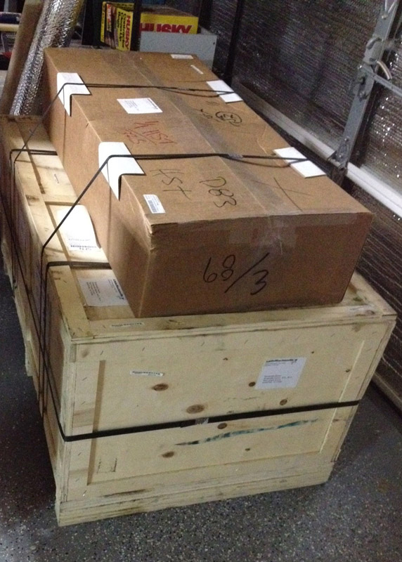

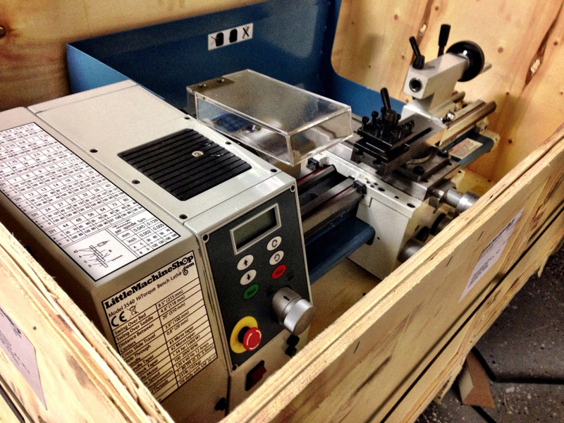

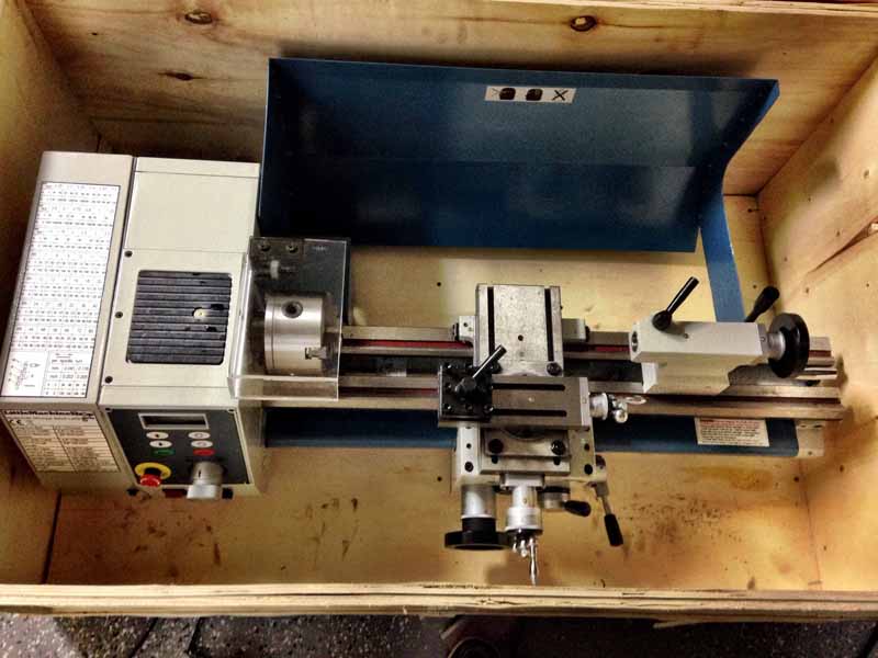

Well..I got a new lathe...Little Machine Shop 8.5 X 20. It's a bit bigger than my Micromark 7 X 14. I opened up the crate and realized that it was one extremely heavy lathe...230 lbs..I believe.
Well being a Wizard...I took out my mighty magic wand and waved it....and nothing happened... :confused::confused::eek::eek::eek: jeeez...all I wanted was for the lathe to come out of the box, rise a measly 4.75 feet in the air and land softly on a work bench. :redface::redface:. Soooo...while I'm getting a new wand ...
an inane question follows...anybody have suggestion on how to get this lathe on to my work bench ? Please...? Doc....:)

Ed McDonnell
Oct 20, 2008
2,294
Melbourne, FL
4.75 feet is a pretty tall workbench! You might be able to rent a lift table (or an a/c lift). Or you could buy something like this:
Northern Industrial Tools Hydraulic Lift Table — 770-Lb. Capacity, 51 1/2in. Max. Lift | Hydraulic Lift Tables Carts| Northern Tool + Equipment
You would have to build a ramp / platform to get the last couple of inches with this one.
I use a harbor freight shop crane to move equipment around in my shop.
SHOP CRANE, 2 TON FOLDABLE
It's not ideal for getting things on benches unless you can get the legs to roll under the bench (or the bench fits between the legs).
Another way I've gotten stuff into place is to use steel loading ramps (like they use to get ATVs into trucks) and slide things up into place.
Probably the easiest thing would be to find a friend or two and give it the heave ho. If you take off the chuck, carriage and tail stock it might be a whole lot lighter.
Nice looking lathe!
Ed
The Penguin
Dec 21, 2009
2,134
Houston, TX
Invite some BIG friends. Have beer. Beer is for AFTER it is on the bench. Russ
big and DUMB friends. LOL
seriously - I could come by and lend a hand. what part of houston are you in?
I'll be up around Spring for a good part of the day on Saturday...I might could bring a motorcycle lift, but that will only lift it up about 18" I think.
Dave Turner
Jul 23, 2010
417
Sylvania, Ohio
If you have a solid attachment point on the ceiling (I drilled a hole through my overhead floor joist and bolted an eye-bolt into it), you can use a comealong (also known as a cable winch - available at Harbor Freight for $15) and tow-strapping to lift your lathe. I've successfully used this arrangement when assembling my bandsaw and jointer.
If your overhead lift point is located elsewhere, you can always lift the lathe onto a rolling cart, then slide the lathe from the cart to your fixed work bench.
mredburn
IAP Activities Manager
Staff member
Jul 5, 2009
8,753
Fort Myers FL
Unfortunatly I have no advice on repairing your "Broken wand' I believe there are doctors that specialize in that.:biggrin:
ed4copies
Local Chapter Manager
Mar 25, 2005
24,530
Racine, WI, USA.
Being the type that rarely asks for help, I have a couple observations that may make this possible:
It looks like a garage (Dawn pointed out the mechanism in the background could be a garage door). Is this also where the "bench" is located?
If so, are the wood cross beams exposed, as they are in most garages?
Do you have a "garden tractor"? Or your car can be a good substitute.
Plan:
Take OFF the tailstock and "banjo" (wood lathe terminology). That should remove at least 50 pounds. Use garden tractor or car to push the box and "body" of the lathe right in front of the final location on the bench. Attach one end of a long rope to the bumper (well the hole in the frame that is usually right under the bumper, these days) of your car (make sure the rope is secure, no slipping). Throw the rope over one of your exposed beams, right above the lathe.
Attach the other end of the rope to the lathe bed, allow it to slide to the tailstock end, but make CERTAIN it will hold. Back up the car, the lathe will rise. When it is higher than the table, have your wife or son swing it over the bench, keeping their fingers in your sight (you are driving the car). When it is properly positioned over the bench, drive forward---don't let it completely "seat" on the bench, you want to adjust the position.
Job accomplished, you can now drink the WHOLE case of beer, since you didn't need help!!!
Congrats!!
Ed
(Years ago, I would have had Dawn grab one end and we would have lifted it to the desired position---grandpa always said, "Too soon old, too late schmardt"!!) Now, I look for levers and "non-lift options"!!
hard hat
Mar 25, 2012
470
Norfolk, VA
one friend, a 12 pack, and a large pizza. a little heave-ho and it'll be there. with two people that's only 115 lbs each...
MartinPens
Apr 3, 2010
1,813
Medford, Oregon, USA
Home Depot = day laborers...?
I think Seamus is your best bet. Hope it works out. Look forward to seeing what comes from this beauty. First thing, make yourself a new wand.
MarkD
Jan 24, 2011
2,293
Sayre, PA
Call your local tool rental place. I bet they have will have something to do the job, and you won't have a bunch of big drunk men to get rid of afterwards :biggrin:
mrburls
Sep 13, 2008
1,728
San Antonio Tx.
Hey Doc, Congrads on the new lathe upgrade. What I used to move my new metal lathe out of the crate and on to the work bench was an engine lift. I've used it for a number of things to move when I borrowed it from a friend. You can roll it around to where it needs to be with lathe hanging from lift. If you don't know anyone with a engine lift, you can buy them at Harbor Freight for under $200.00 They do come in handy at times.
And I was able to do it myself without help :wink:
Keith "mrburls"
BKelley
Jan 31, 2010
891
Tucker, Georgia, 30084
Congratulations on the new lathe, I believe it is identical to my 8.5 x 16 except for bed length. They are good solid little lathes . When I got mine, I had to go to the local UPS terminal and they loaded it on my truck with a fork lift. Upon arrival at home I backed truck up to shop door, opened boxes up and accessories were carried into shop. When time for lifting lathe, I borrowed two hefty men from my lawn service people and they placed it on my work bench. That was about 3:00 in the evening and by the same time next day, I had cleaned adjusted, and was pen turning. I hope you enjoy yours as much as I have mine.
Ben
terryf
Jul 10, 2010
1,276
Pretoria, South Africa
Doc, you should have asked the guy that offloaded that monster box to put it on the bench for you. Must been a huge linebacker looking at the size of that thing.
Seriously though, its either a rope with pulleys and a 6:1 mechanical advantage or an electric boat winch as was mentioned earlier. (or four of Davids mates :) )
Happy turning :D
wizard
Aug 27, 2009
3,569
Houston, Texas

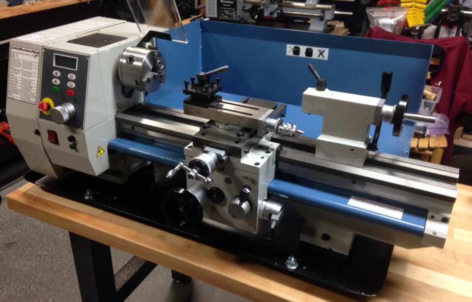

On the table!
Got it on the table....many thanks to Shawn Pachlhofer (The Penguin) and his friend Mike Myers for coming over and helping getting my lathe set up! Now I just need the time to make something :rolleyes:. Again, many thanks Shawn and Mike!!! Regards, Doc:)
