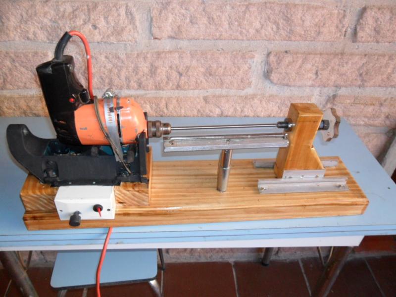

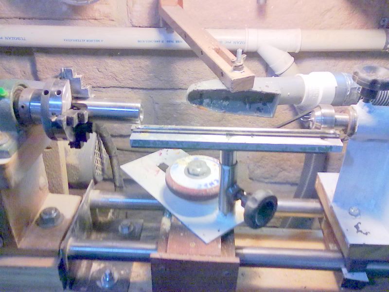

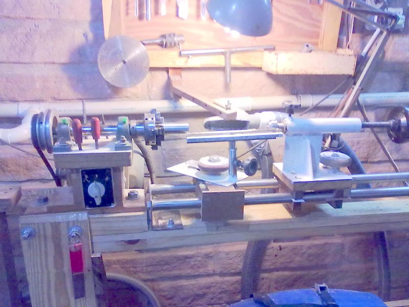

fernandorosa
Jan 16, 2012
16
novo hamburgo rs brasil
For here in Brazil we do not have the amount of lathes that you have
I'm waiting for my son to bring a bag to make it an import
the rate is 60% more freight going to 50%
This for a retiree is too expensive
So I'm going around using my home that I myself costrui
A I have two large and one small
Some measures:
The first large-capacity "-the distance between centers 40" variable speed (electronically) 150-3600 rpm
The small-capacity 5 "-distance between centers 12" - variable speed (dimmer)
The photos show details
Fernando
"Who does not have hunting dog with Cat"
