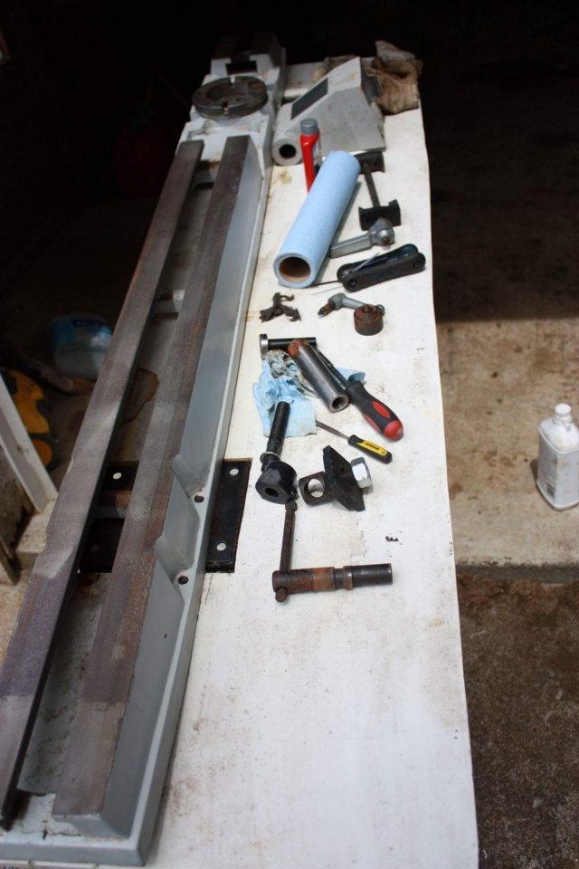

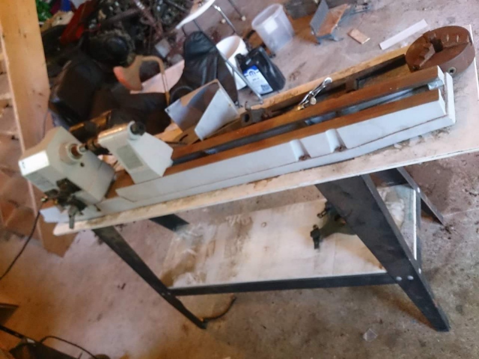

Well I got the lathe home today. Tore it all apart, cleaned the ways and applied a coat of hard wax. I also used a small file to remove some of the rough casting. The tail stock slides like it's on rollers.

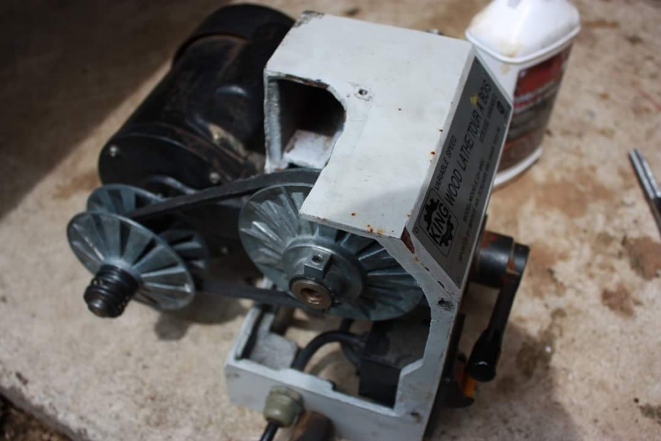

Found the motor to be loose so I tightened that up and while I had it apart I got the Reeves drive freed up and lubed. Plan to order two belts for it I as I can get them for 7$. What kind of grease are you supposed to put in the grease fitting in the end of the shaft?
Happy with my purchase just need to find some odds and ends. The handwheel on The tail stock is broken and I have no mt2 accessories.
