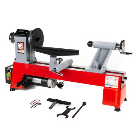

Thank you all for your advice. The mini lathe i use now is a proxxon wood lathe; i am considering to buy this one:
Specifications are below the model photo, cheers
The first thing that sticks out to me is the low speed on the lathe; 650rpm which for me is a bit high for applying CA glue, drilling, and finishing. Other than that, it looks like it should get the job done.
So that machine has a M33 headstock, meaning that you will need to find a chuck that also has that same thread. Something like this from that same manufacturer
If you want to drill your blanks on the lathe (I really recommend this) then you will also need a drill chuck
You will also need a mandrel to turn pens on but I do not see one offered by that company. Hope this helps!
thank you for your advice,a m33 headstock can accomodate a pen chuck however isn't it? i suppose i need to find a specialised shop to buy such a part. Haven't thought about rpms though, what rate is low enough? cheers
M-33 thread is pretty common, especially in Europe. Finding an M-33 chuck in Greece will likely be easier than the common USA sizes, so no worries there.

the thing is that i just checked my lathe's low speed and its 1000 rpm. I suppose that things would be easier with a lower speed but i ve managed to apply ca and drill holes in bud vases.
My reactions to the specifications for this lathe are:
Motor power - probably a bit on the light side. The specified continuous power rating of 500W translates roughly to 1/2 Hp - I would prefer to see a continuous rating closer to 1 Hp (1000 w).
Side note: the specification also mentions that the 'S6' rating for the motor is 700w. While this is interesting, my personal belief is that this is potentially misleading (just like Hp ratings on lawn mowers and other small engines - which is why they are no longer used, and engine displacement is used instead as the means of comparing machines). Under IEC standards, 'S6" is the peak rating of a motor when it is subjected to alternating periods of peak load following by equal duration periods of idle, no-load operation. So, in this instance, the motor is capable of developing 700 w of power for a period of X seconds provided it is then allowed to run at no load for a period of at least X seconds to cool down. Potentially the most severe duty that a lathe motor will see is during end-grain drilling, and it is true that a this is typically done intermittently. However, I know that when I stop drilling, I turn off the lathe - I don't allow it to continue to run for as long as I was drilling to cool down. Therefore, in my opinion, reliance on the S6 rating could lead to overloading/overheating of the motor.
Spindle thread: M33 is common in Europe. You should have no difficulty find accessories to fit. MT2 is very common.
Throw: 153mm - typical for a midi-lathe.
Distance between centers: 460mm is also typical. However, understand that in practice, you won't be able to use the full length - when you add a scroll chuck, and a jacobs chuck for drilling, you will lose 150mm, and probably more of this space. OK for pens and bowls, but you won't be able to do long spindles (eg, baseball bats). You might look into whether a bed extension is offered as an accessory.
Tailstock travel: 55mm - probably typical for a lathe of this size
Speed range: 650-3800 r/min. Also typical for lathes in this range. Some lathes in this category offer an undocumented ability to adjust the speed range slightly - there is no way to know from the specification if that applies to this machine.
Bottom line - not a bad lathe other than being a bit underpowered.
