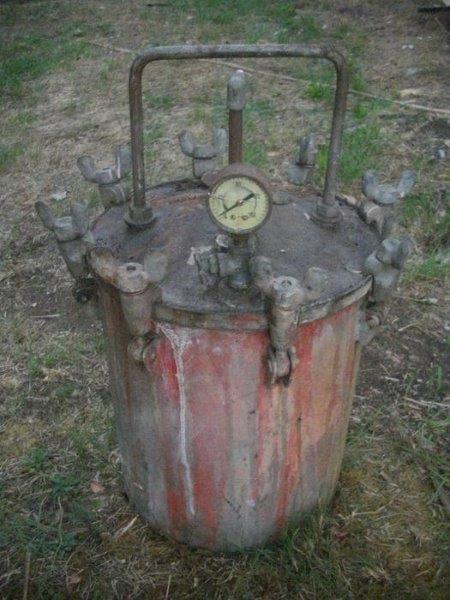

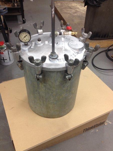

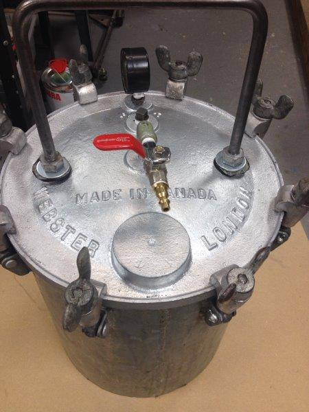

Very nice. I found this one a couple of years ago. Got it on Craig's list for $30.
It's a 5 gal. Not sure on the pressure as the label was gone. So to test it for my use I filled it with water to within an inch of top buried it in the ground and started pumping. I took it to max compressor 120 lbs. no problem. I think I got this tip from Curly.
I don't use that pressure when casting though. Usually 100 lbs.
It was a Canadian built unit by Webster. Can't find any info on the company but it's old.
