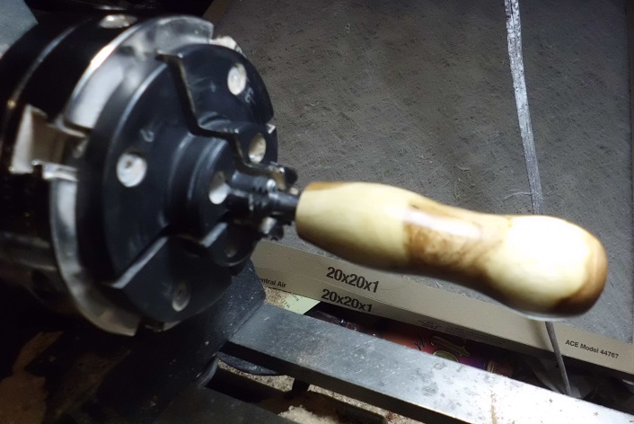

You can't see the rod in this pic because it's sticking all the way through the headstock .... :) Needed to use my Utility Grip chuck rather than my 3-jaw, as this one has the through-hole necessary for the rod clearance.

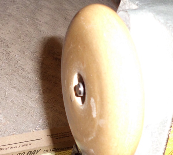

Here's the view from the back of the headstock, you can see the tip of the rod peeking out ... (and you can see my home made handwheel that I added to the headstock as well ... just some MDF that I turned in position on the lathe and sealed with CA.)

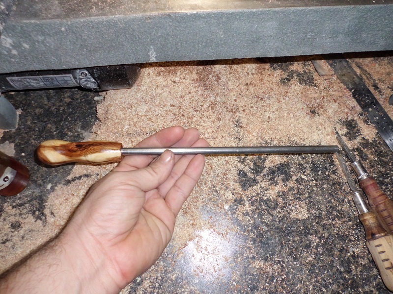

And, while typing up this post, the CA finished drying, so I have it out ... here's a view of it in my hand. :)
(Home made "grandpa's screwdrivers" turned mini detail lathe tools to the right ... picked them up for a buck apiece at a pawn shop, and used my sander to re-shape the tips to my liking. I have four, total .... looking for some more, they work great for small bowl and box turning! If you look closely, you can see they have square shanks. Phillips screwdrivers had a round shank, these were slotted.)

Side note ... used the new bar several times last night ... I'm pleased that it's a good deal heavier than the original bar, and it just takes a light tap to un-seat my #1MT accessories rather than the hard tap (or multiple hard taps) it was taking me with the old bar ... :)
