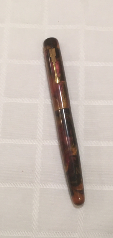

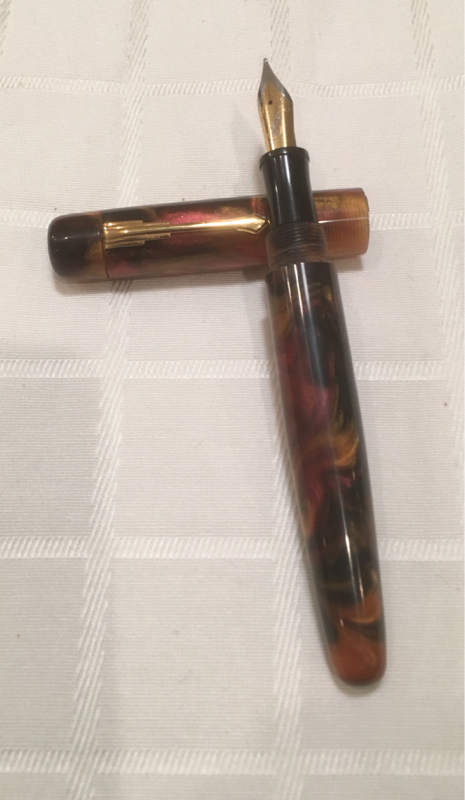

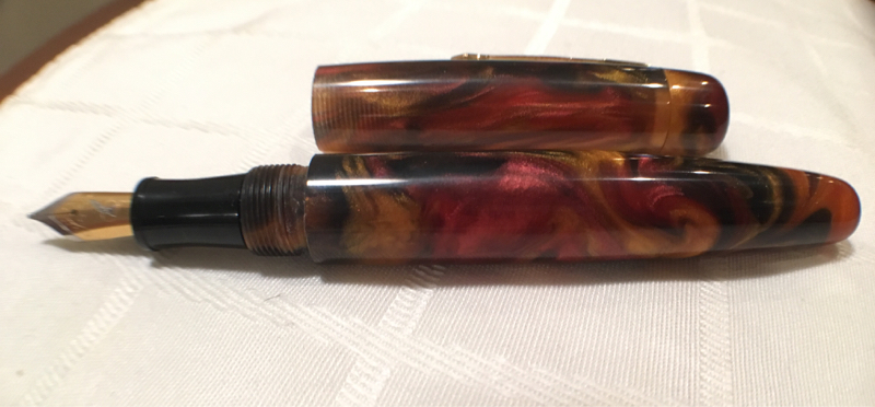

Here's one I finished tonight. Polyresin with a #6 Heritance nib.
