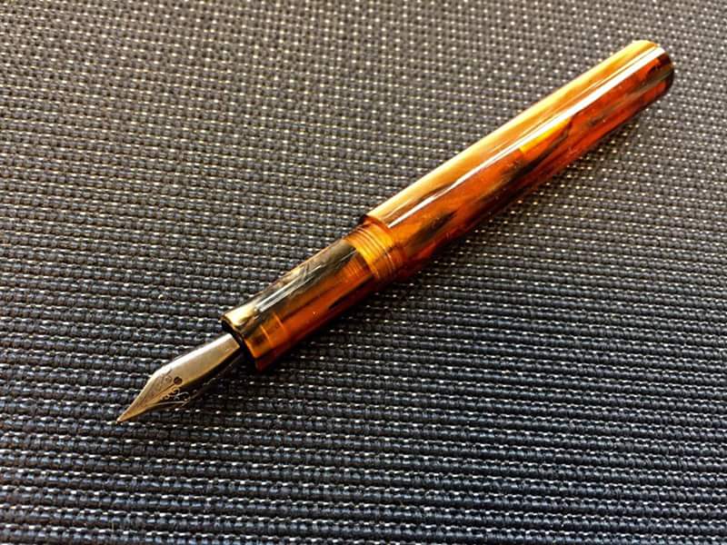

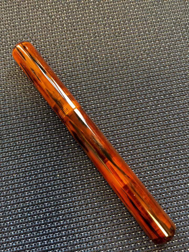

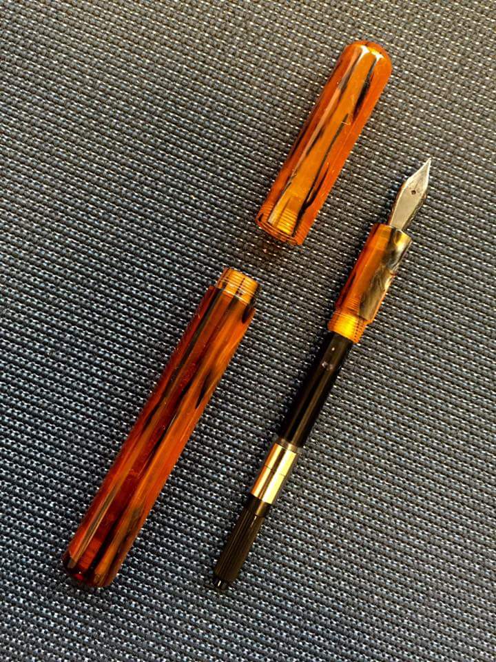

New Kitless FP in semi transparent acrylic with 5mm JOWO bib.
See more from More4dan
More4dan
Mar 17, 2016
2,100
Katy, TX

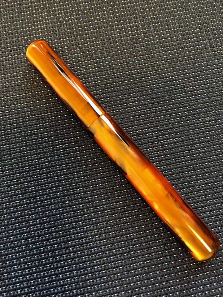

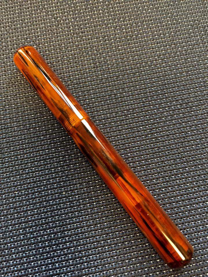

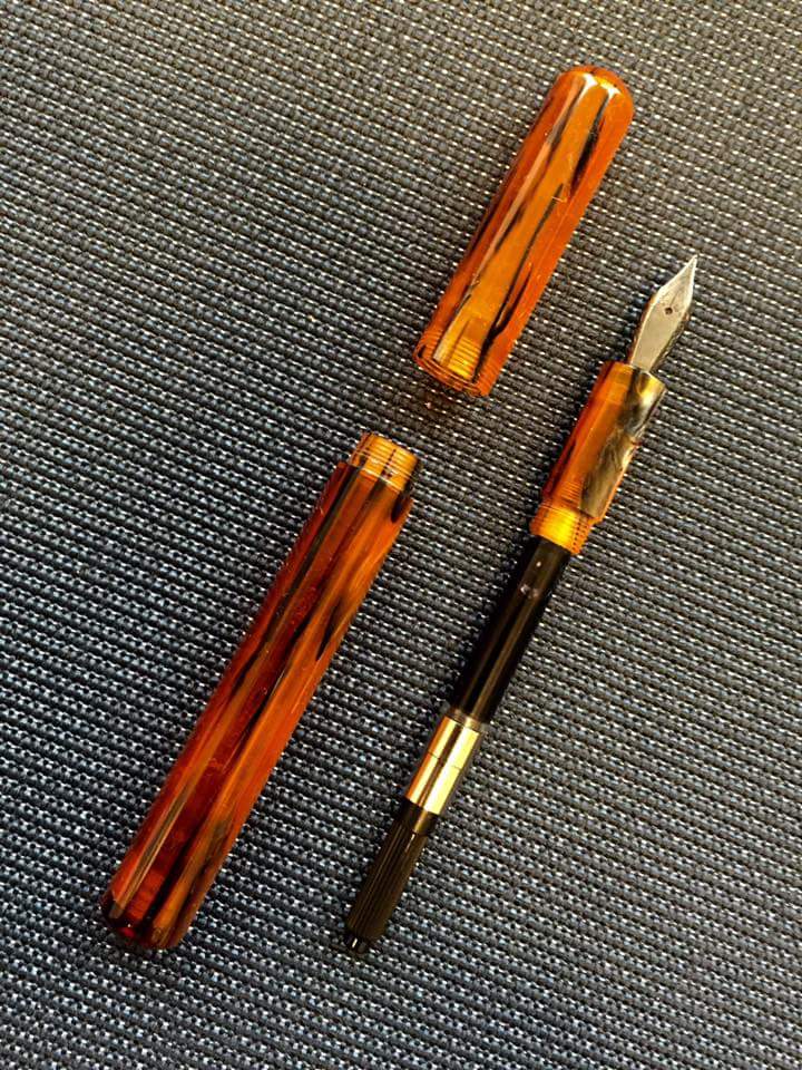

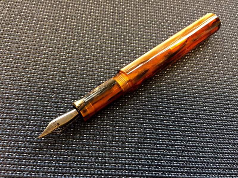

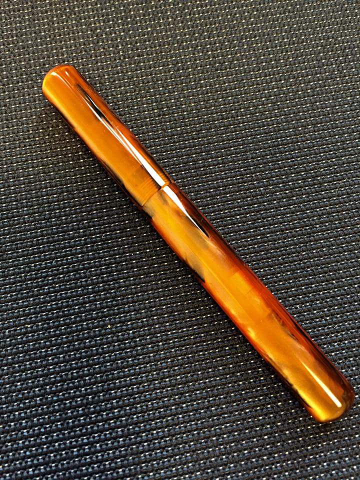

My first all acrylic FP. I used a blank that is transparent from one side and opaque from the other. It's not quite as dramatic after turning and drilling but still different. Dimensions are 12mm diameter and 125 mm capped and 123 mm uncapped. It uses a K5 converter and a JOWO 5mm nib with a Ruthenium finish. The ends were rounded with a 3/4" roundover router bit mounted in boring bar holder. Comments and questions welcomed. Any links to how to polish the ID would be appreciated. Thanks

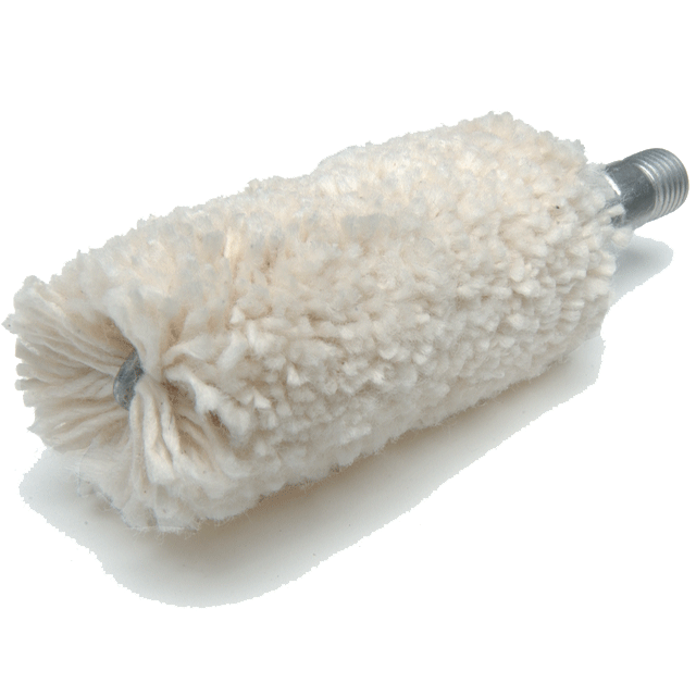

Thanks for all the comments. The video helped a lot. Wooden dowel and fine grit sand paper ready to go. I also purchased some gun cleaning swabs in different diameters to use with buffer polishing rouge.
