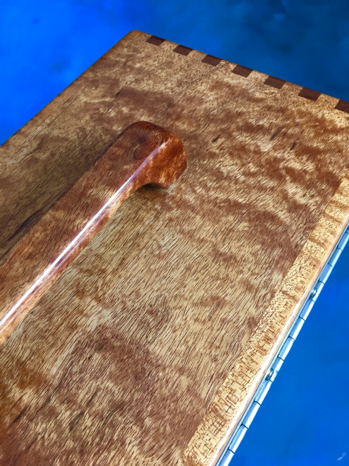

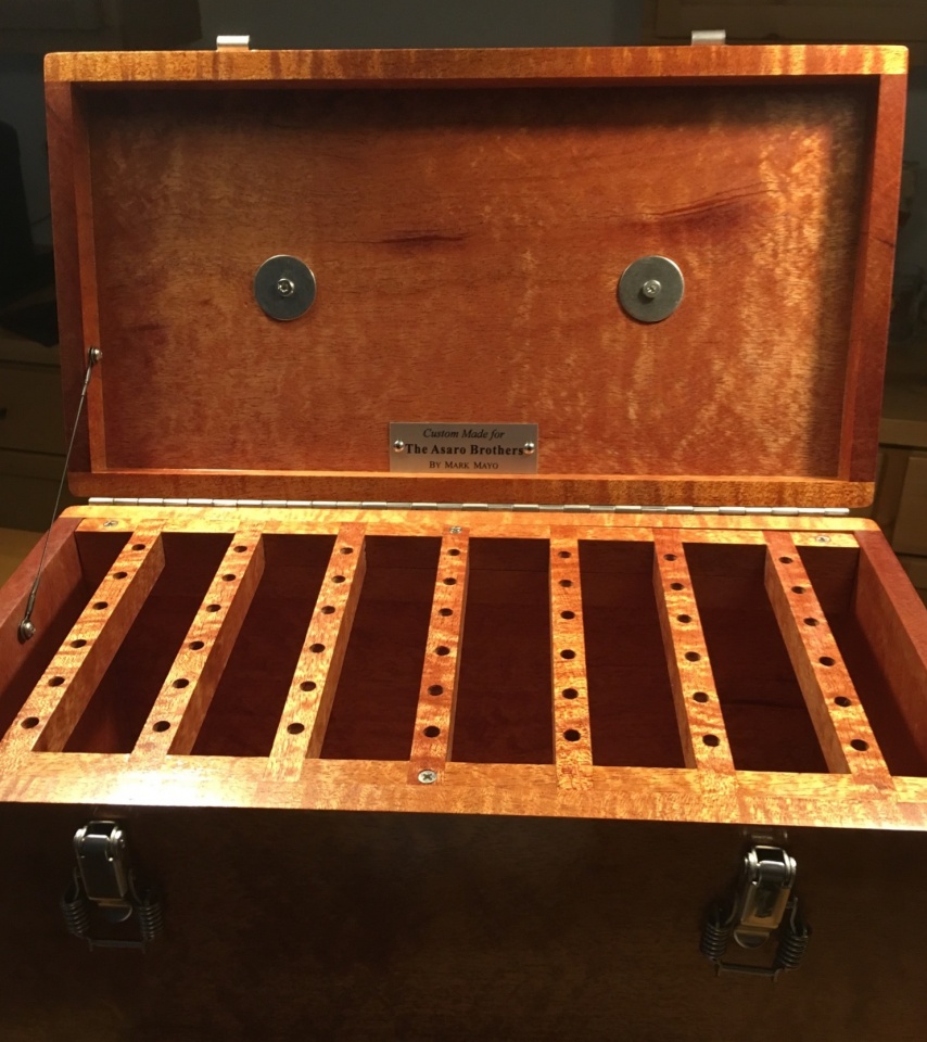

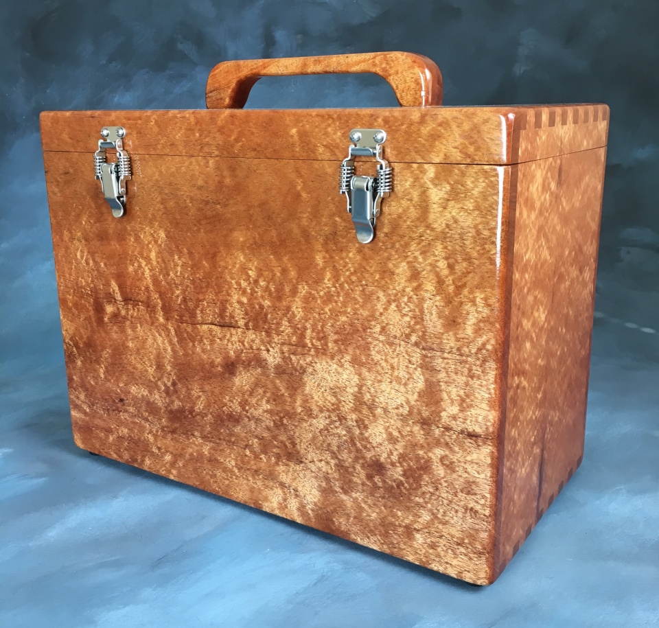

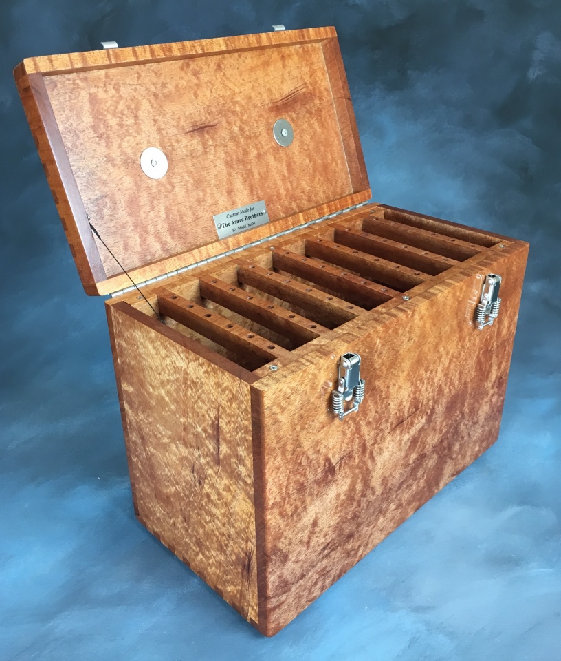

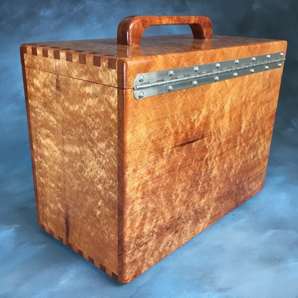

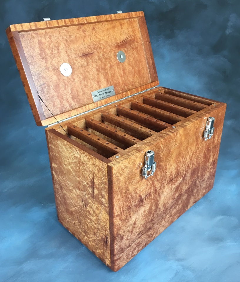

I found a couple of very unusual boards at Austin Hardwood in Santa Ana when buying wood for two custom jig boxes. It was unusual enough that I worried the buyer would not see it like I did, but I pulled the trigger anyway. Here are the results.
Here is is email upon receiving his new custom saltwater fishing box.
"Hi Mark ... I got the box today and it looks amazing , it absolutely pops in the sun and see what you mean about the holographic look ... Unbelievable - ANTHONY"
Nice, now back to four- six pens per day.

The guy would have to be almost blind to not appreciate the beautiful wood you selected. That is a stand-out tackle box, that will no doubt accompany many a "Fish Story" for years to come.
Outstanding wood. Is there a reason you used that particular hinge on it? I would have opted for brass but saltwater would be an issue for just about any metal. Thanks for sharing the story and pictures.
Forgot- what finish did you use?
The hinge is stainless steel; they survive the salt water environment the best fir me. I use 5-6 coats of System Three Spar Varnish diluted 4:1 with mineral spirits. I wipe it in and sand between coats.

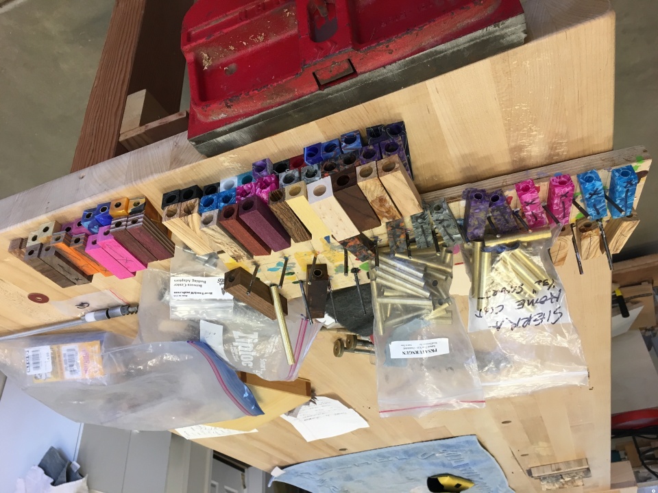

I make pens too...
I try to complete four or more pens per day. Sorry this site's photo viewer turned this upside down twice once before and once AFTER I flipped it 180 degrees, go figure.

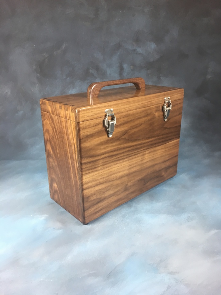

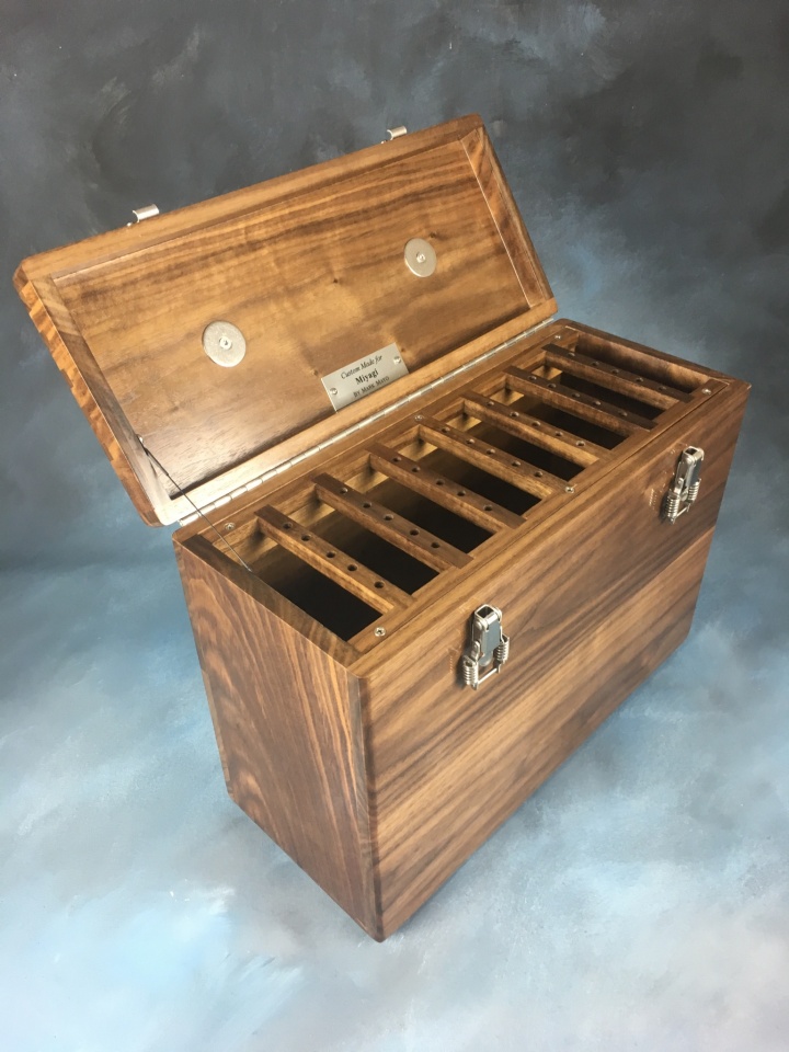

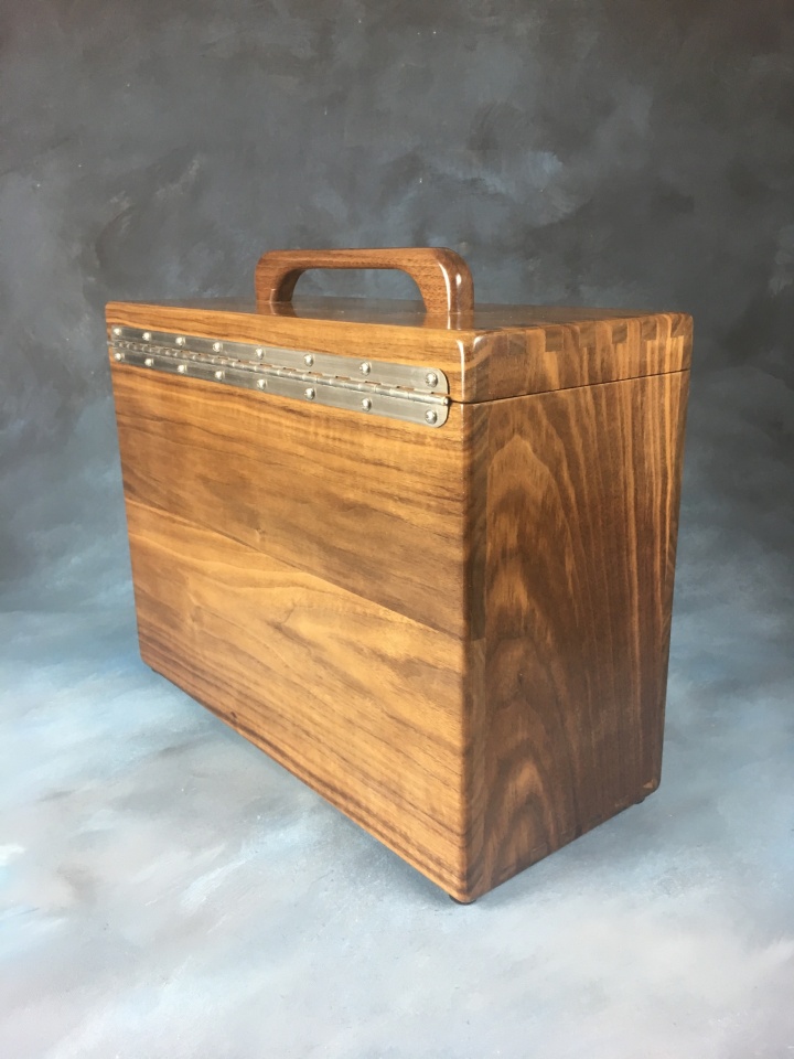

Walnut too
A walnut jig box. I use these to help support times when pen sales are not as robust.

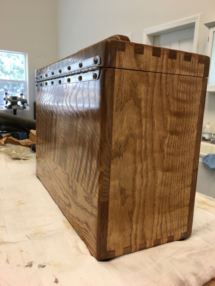

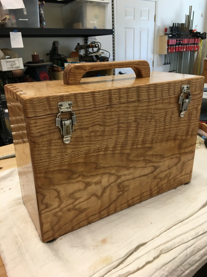

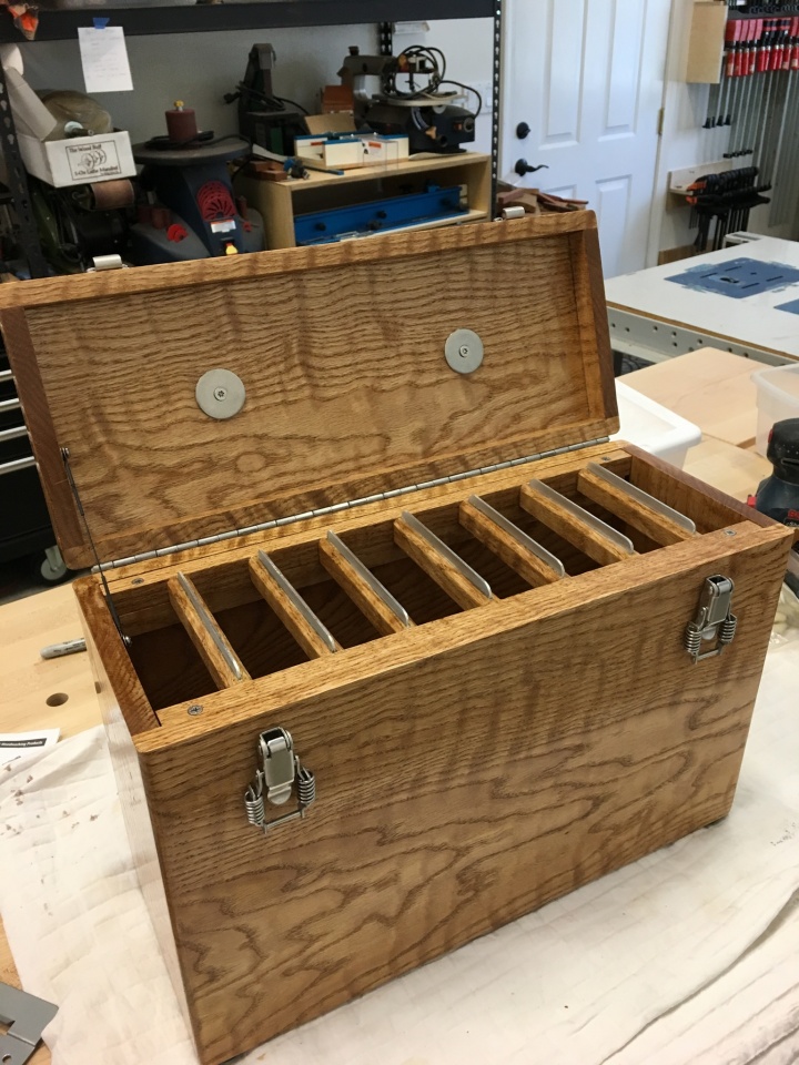

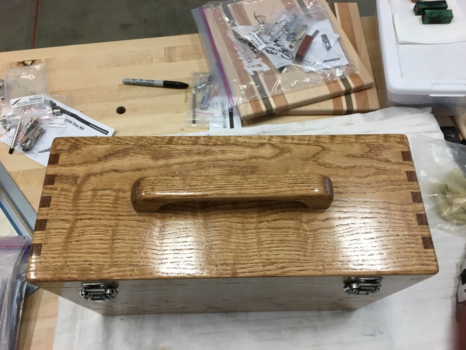

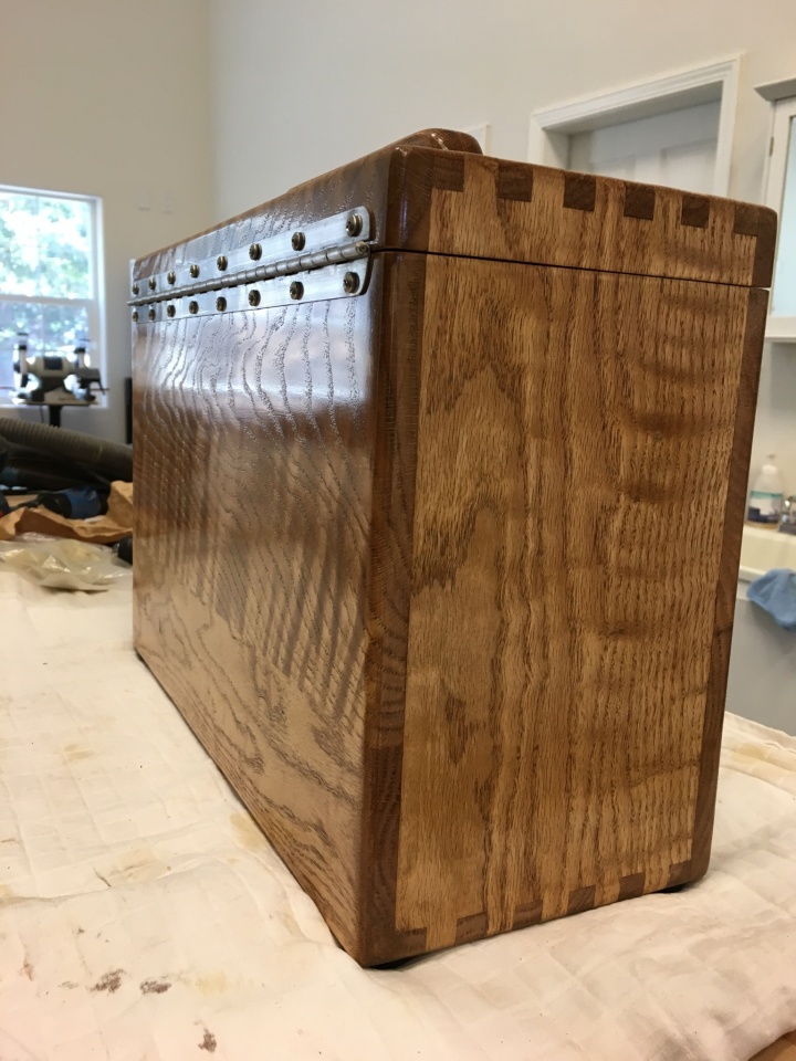

Quartersawn quilted red oak...
This was another board that even the guys that write up your purchases at Austin took notice.

Outstanding joinery superb craftsmanship. I know it's built to use but I'd be afraid to put a mark on it.
By the way
I use a very flimsy box joint jig from Rockler. It works, I get tight joints, but I will upgrade to an Incra box joint jig after some cash flow during the holidays.
