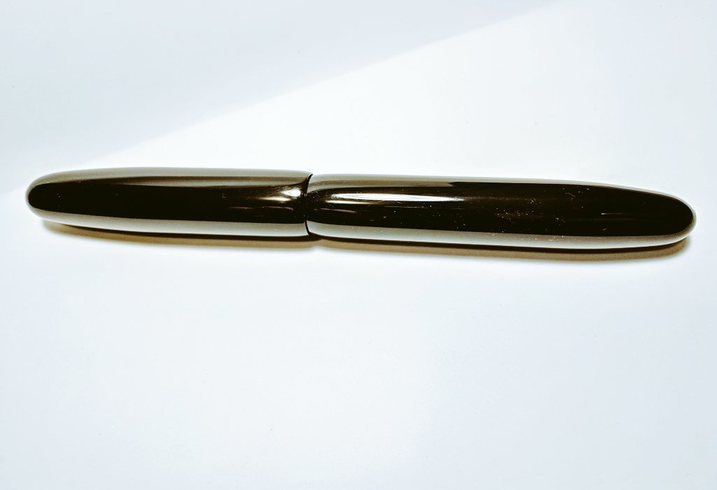

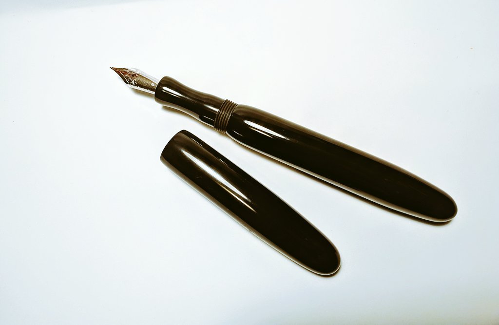

Hi all,
I present to you my final design of my ebonite pen. I'll do a golden sample when my triple die and tap will arrive.
Nice weekend all.
Teo

Very nice, what is your process to polish the ebonite? It looks amazing, do certain ebonite's polish better?
It's a very demanding process, I think I could make a pen during.
I use sanding paper, Sia Swiss, great quality.
I'm starting at 400 till 3000. I'm sanding in both direction, circular and pen length.
Luxor polishing paste to finish on buffing wheel, first I use white and finish with orange.
Ebonite quality is very important, I use SEM from Germany.
