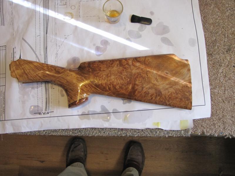

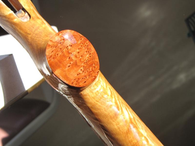

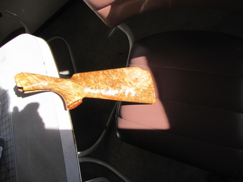

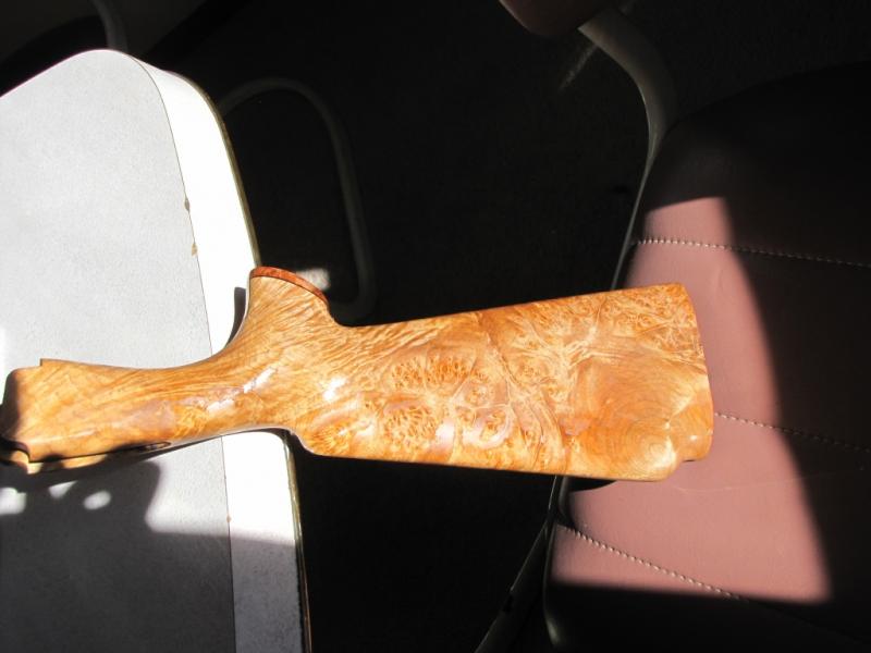

I'm just getting started with stock work. Still have lots to learn.
You just can't beat Maple burl when it comes to value. This blank was $90. Something similar in walnut would be at least $600, probably a lot more.

Maple durability
I know other people with maple guns. I was careful to lay it out so that there is straight grain in the grip and front portion so that it is strong. It was much harder to work than walnut I have worked on. And, the person who is helping me learn showed me how to bed the back of the receiver so that the recoil impacts solid wood. So, I really think it will last, but only time will tell.
