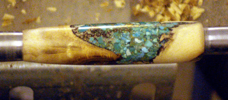

I turn a pen almost to final size. I cut a groove in a pen with an narrow parting tool. Then using CA and inlay material, I fill the groove, let it cure and finish turning.
I have used crushed turquoise, crushed jasper, glitter, etc. I also use it to fill voids in a blank before turning like this one. It can save a damaged blank if a chunk comes out while turning.

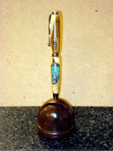

Here is the finished slimline
