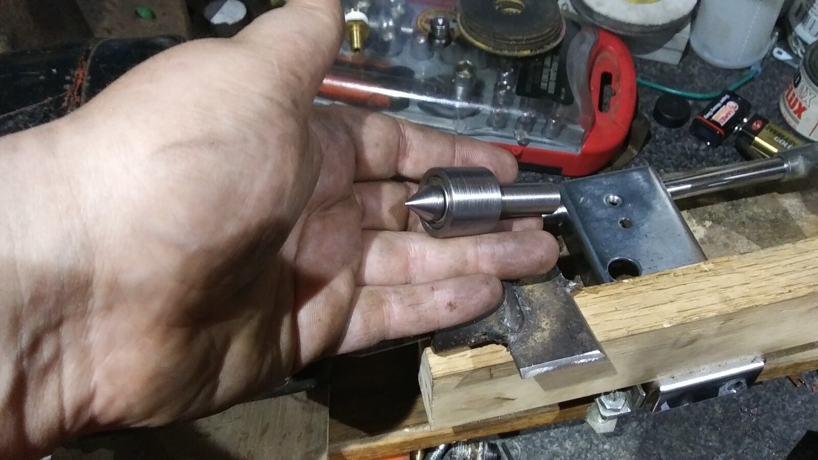

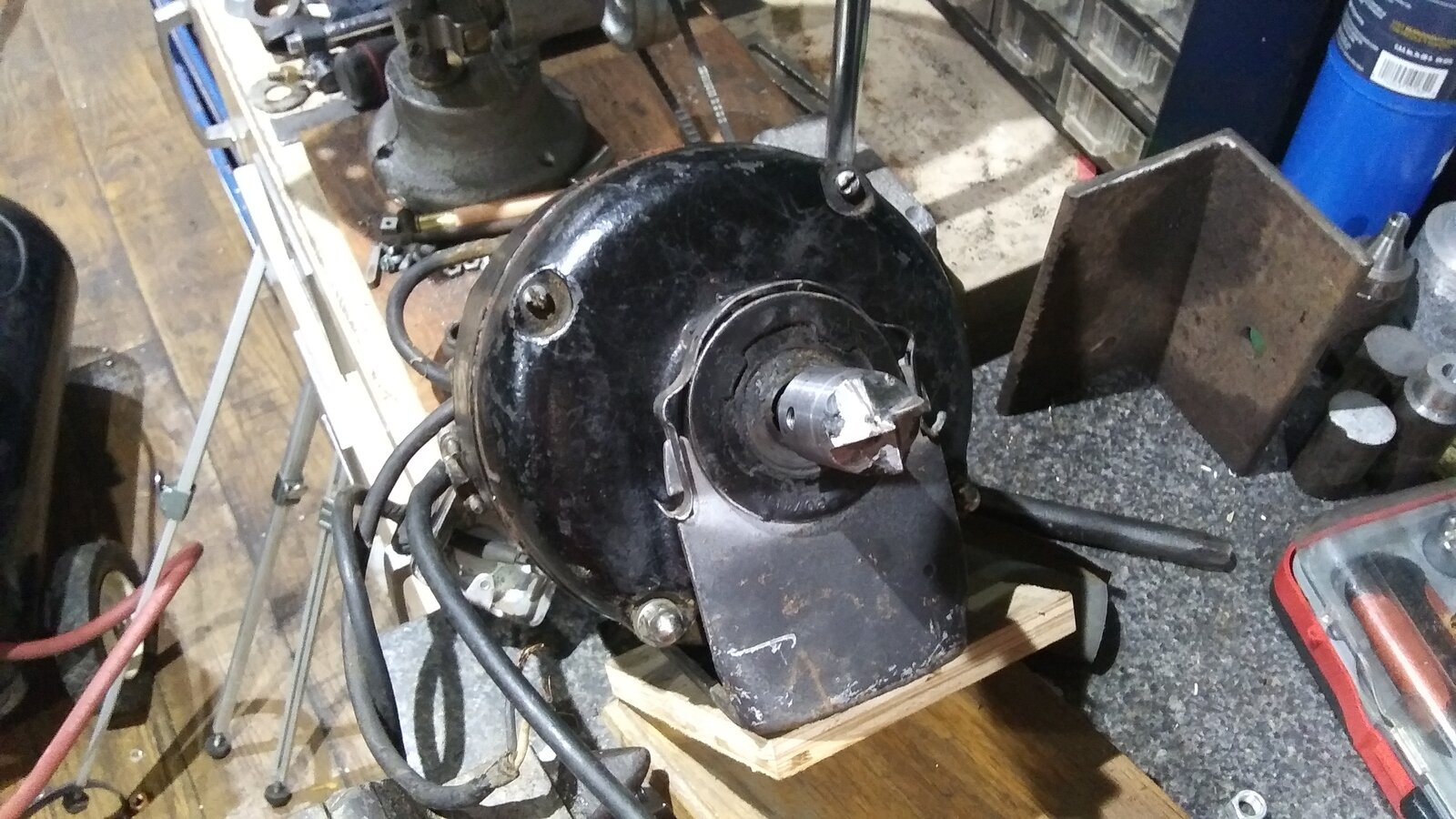

I have a little wood lathe made of random pieces of steel that I cobbled together, and machined up a live center for the tailstock, and spur center for a 1725 rpm motor I had laying around. It seems to work pretty well so far. Im a machinist and foundryman by trade, but it is fun to do free hand turning sometimes too like you would with a pen. So far, Ive just made a few dip pens since I like collecting calligraphy pens, and figured that it was time to try my hand at making a few myself that fit my hands better, lol.

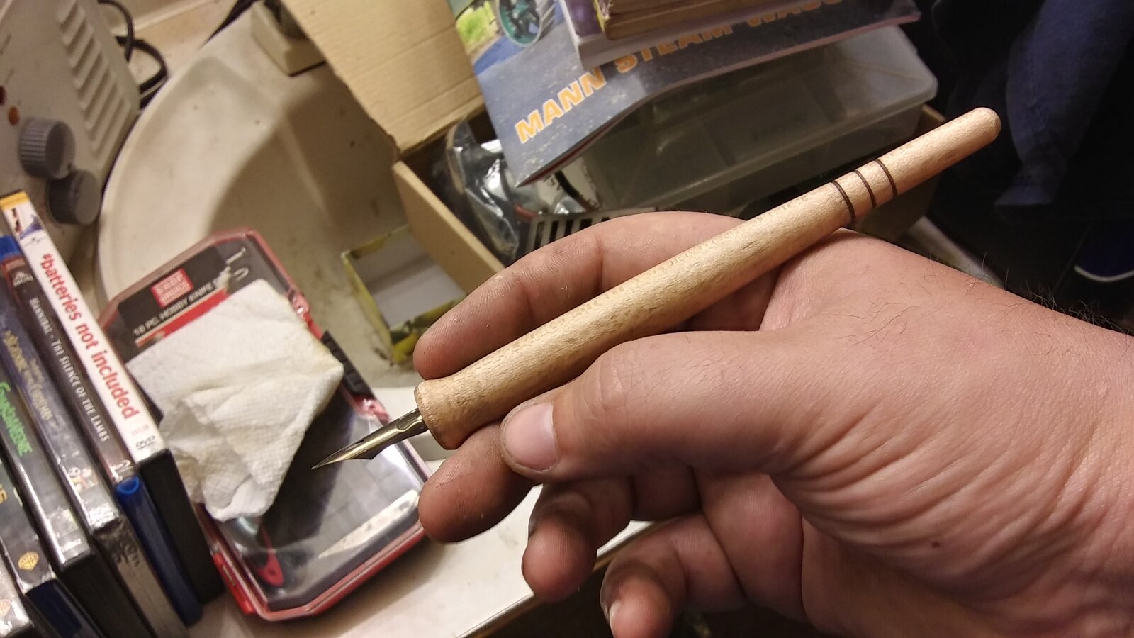

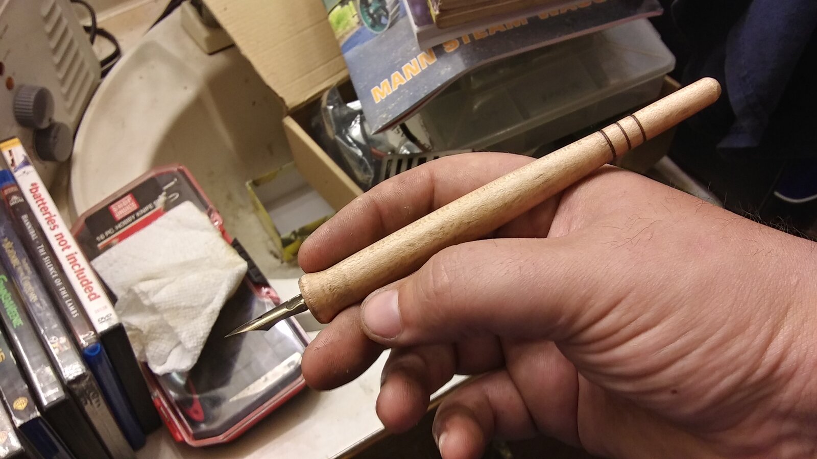

Dont laugh, but here's the one Ive been using most lately, just a quick turning job really. It's made of sycamore, and while it is a bit short, it really is comfortable to use. Im not a wood turner at all as you can probably see.

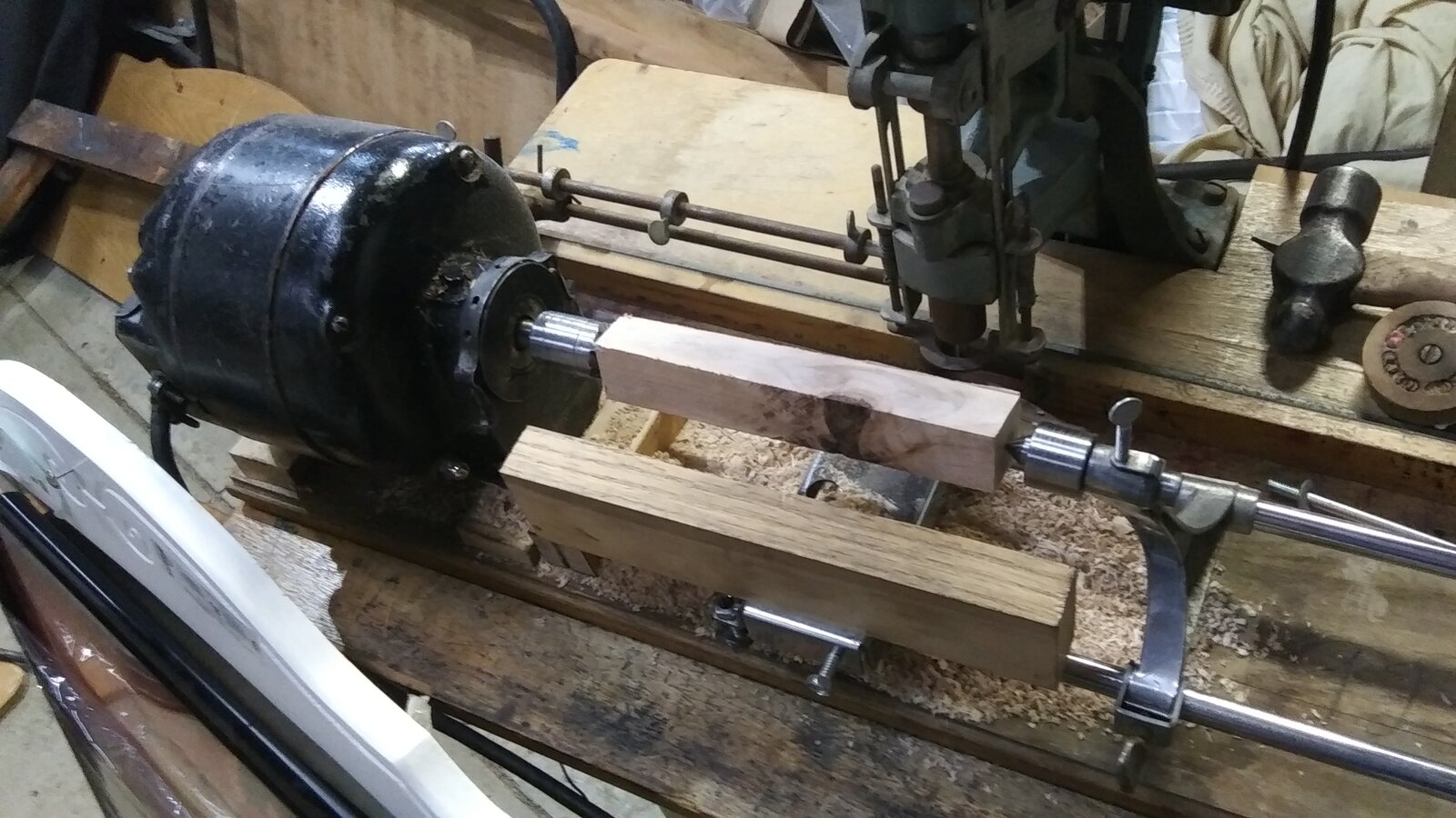

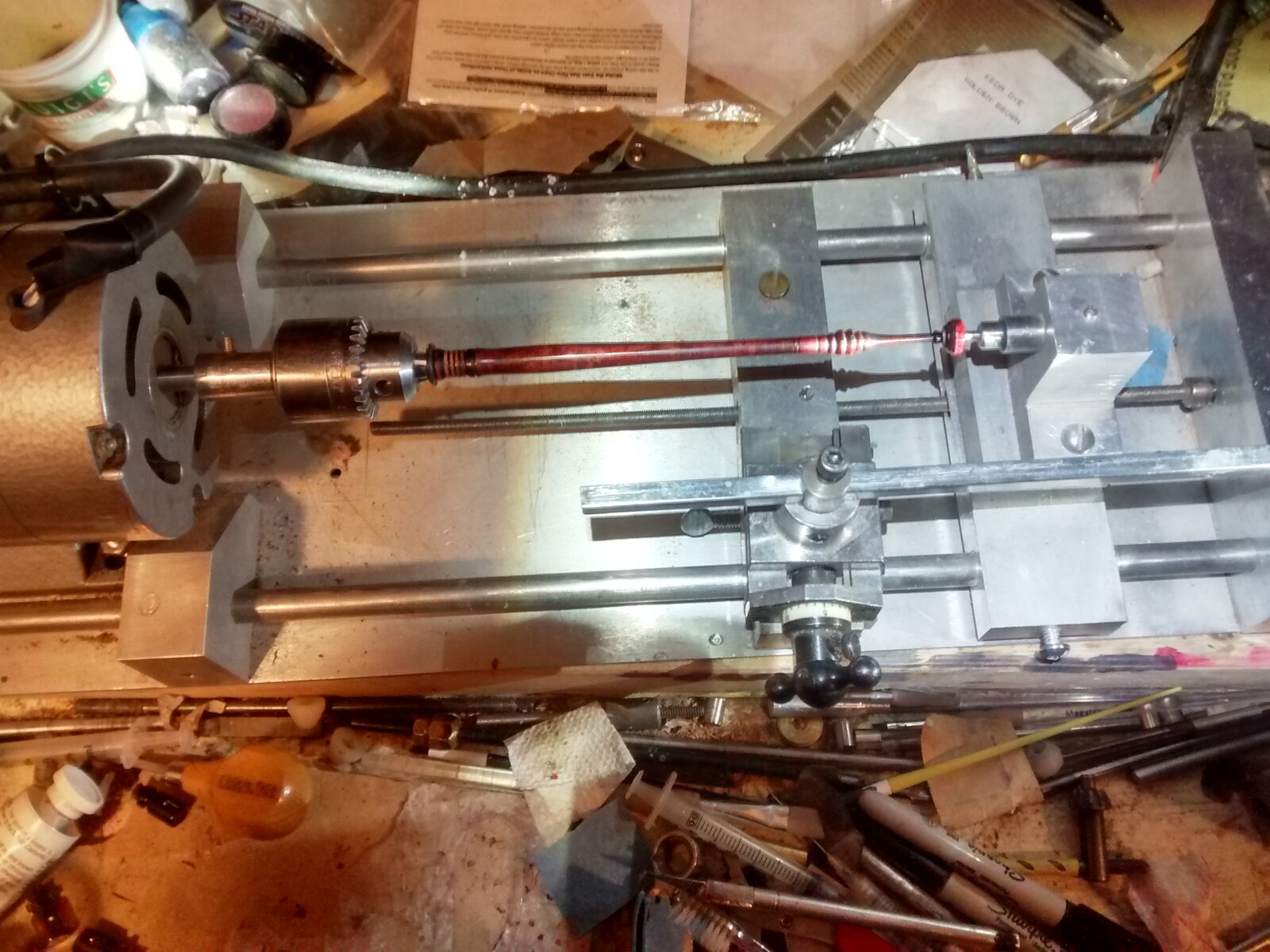

It's technically not completely a homemade lathe since some parts, I didnt make, but a family member got a junk box at an auction and inside of it was some pieces of a toy mini wood lathe, but the ways were completely rusted up and corroded/pitted and everything was siezed up, it was missing the tool rest, and motor was shot. I replaced the shafts/ways on it with some chrome plated tube I had and just screwed a piece of wood to the carriage to act as a tool rest. I then stuck a 1/4HP motor that I had laying around, I think it was from a very old clothes dryer on it as the headstock, then welded and machined up a spur center for it. The spur center was just made the same as a homemade spade bit, just a piece of round stock that is slitted in half with the angle grinder and a piece of steel is welded in, then turned to size and so it's true. I did that, then cut it 90 degrees from the first blade in the middle and welded in another, that gave the 4 teeth for the spur bit. It was quick and dirty, but it did work pretty well. I still need to make an adapter for the motor for it to use a drill chuck, but that is pretty easy. As you can see, it was one of those thrown together jobs to see if it was something I would even get interested in tbh, but it does work pretty well. Ill make up an adjustable table rest coming up from some angle iron or something so I can adjust it in to the work.
The thing came with a dead center, and you constantly had to keep resetting it, so you spent more time fighting with it than turning, so I found two bearings in the one drawer that were just laying there from something I tore apart, and made up a little live center with those bearings and some random pieces of steel that I had sitting there at the time.

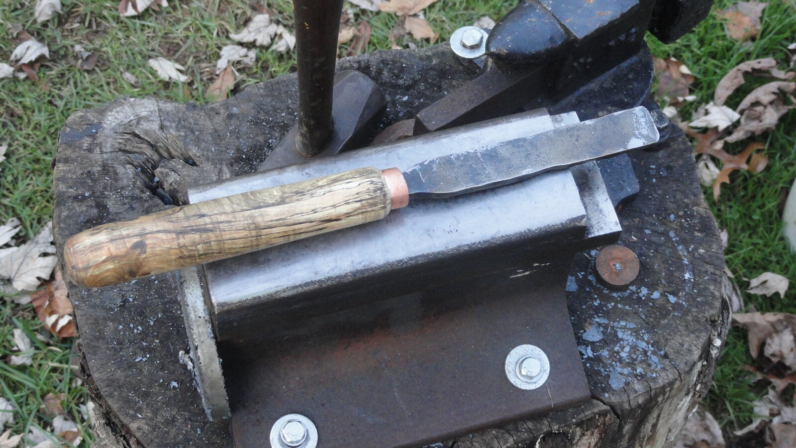

Ive done a little blacksmithing too and have made up some scrapers and a gouge to go with it out of some large spring washers, and have been using those so far. Here's the one I use the most so far, it just has a beeswax finish on it and I have no idea what type of wood it is, it was just what I grabbed off of the woodpile, lol. So far, the wood lathe really was just being used to turn file handles and handles for screwdrivers.

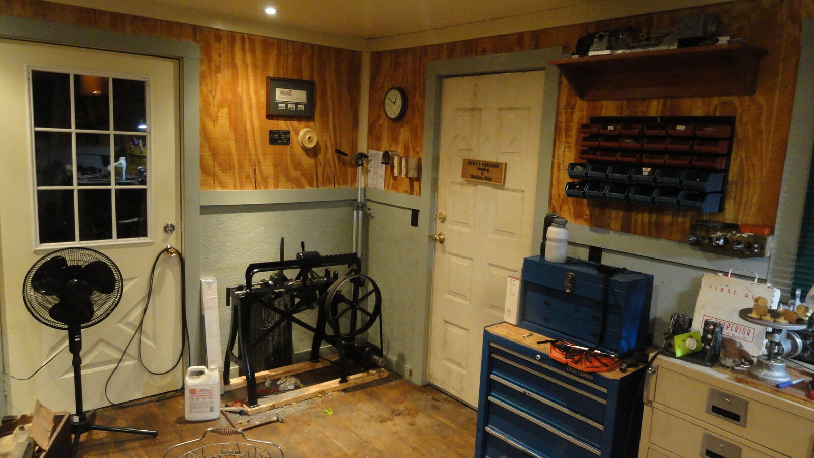

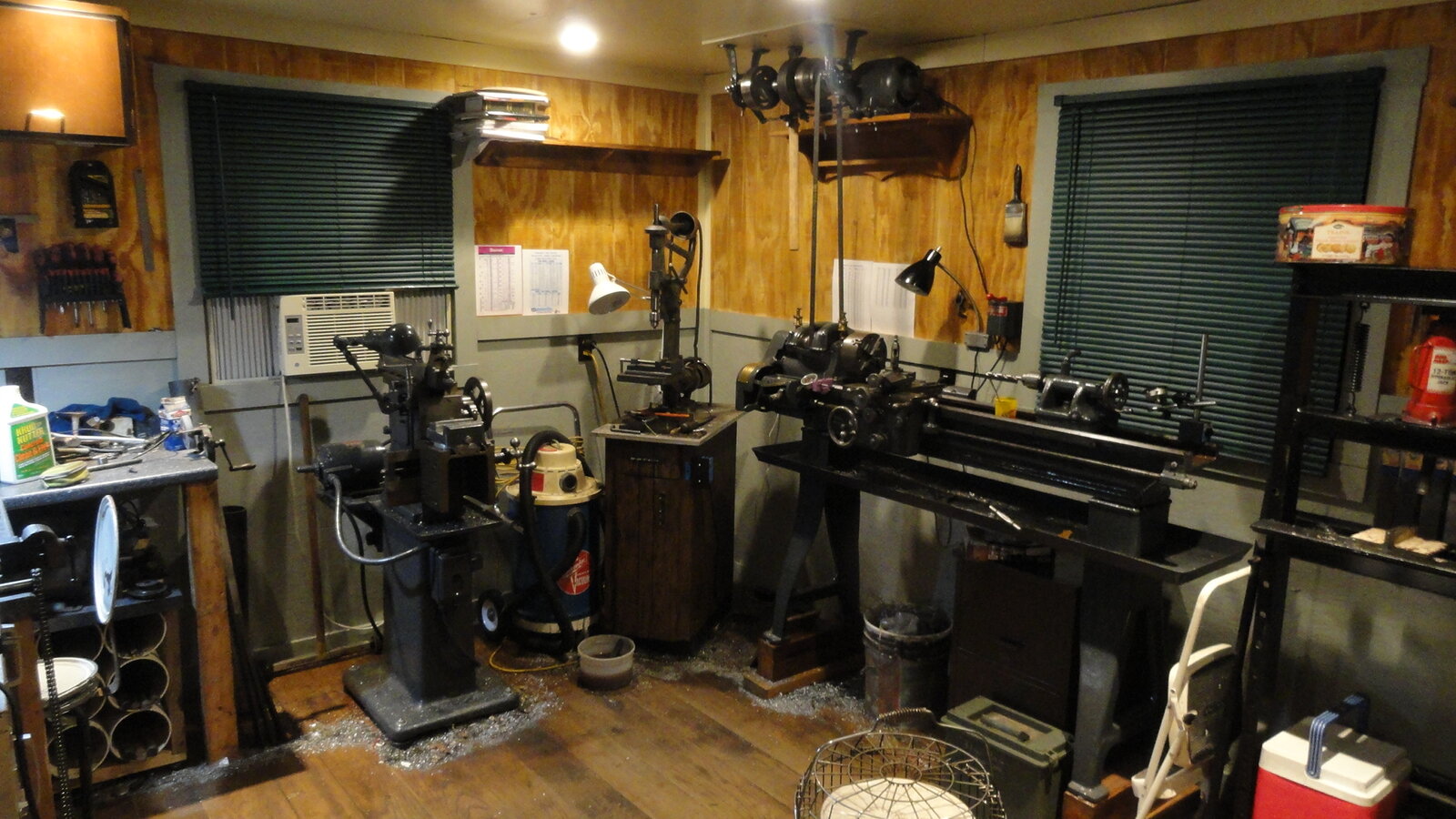

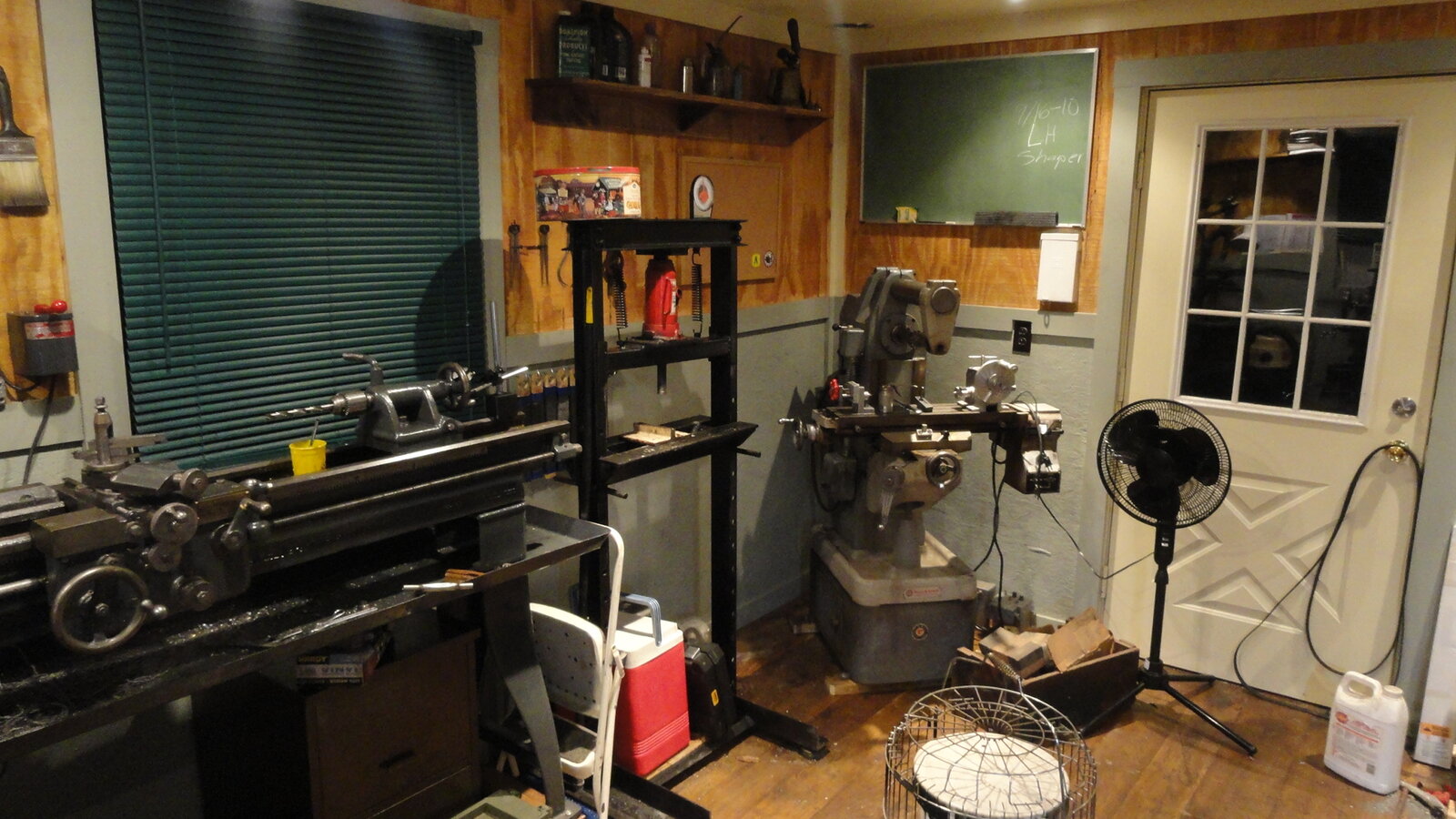

As for my shop, I have a small machine shop where I do odd jobs for local farmers and people around where I live, just fixing things or making things, whether it be machining it up or casting something out. Most of the machines are from between 1893 to 1925, all flat belt driven. As for where I picked up how to do that stuff, I mainly just got the machines and started playing with them, after a few youtube videos on some stuff I was interested in, the rest was history, lol.
Ive always liked messing with dip pens and calligraphy sets, but could never find one that I really liked how it fit in the hand, so a few weeks back, I found a few boxes of old nibs at a thrift store and figured I'd try my hand at making a pen/holder for them, and it's kinda progressed from there. I have the stuff coming to make a few slimline pens, which as soon as the tubing and everything gets here, Ill make up the drill chuck adapter and an arbor to turn everything on.

Your shop's a lot prettier than mine - as are your machines. I've got a 80s-era South Bend Light 10, and a probably-maybe-possibly 50s-70s small knee mill (no one's ever seen one even vaguely similar from the company, so it's a bit of a mystery). I'm puzzled by a couple of them, though... I can't quite identify what's in the first picture... and is that machine on the left in the second one a shaper?

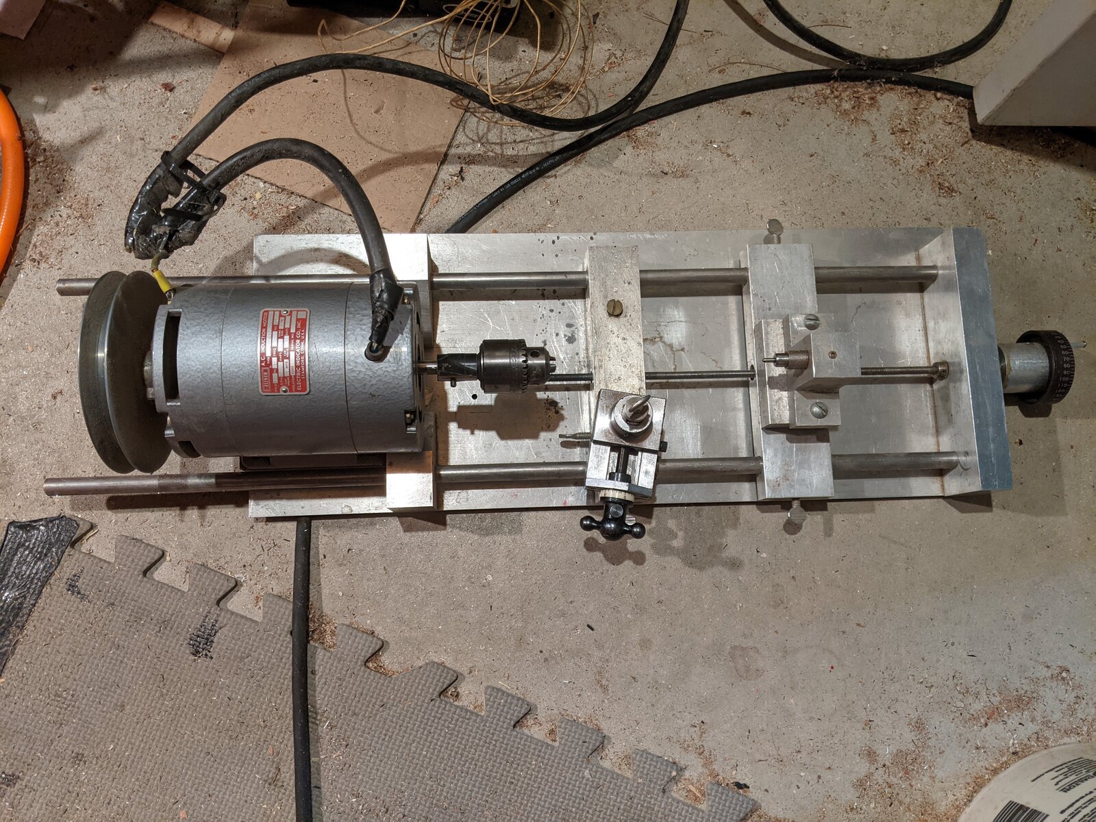

Speaking of [less than] pretty machines (I still think it's kinda cute), here's my first lathe:
Back in its glory days, with "tool rest" installed, turning an impractical pen:
That's a pretty neat little lathe and looks like it would defenitely work well for turning pens and wooden handles for things. Defenitely alot more work into it than mine, that shows for sure, lol. I just threw my little lathe together in an afternoon with what I had laying around to get the thing running, and figured I'd try turning a pen/nib holder to see how it worked, and have been playing with making them since. It seems to work pretty well so far, but if I were to really get into it much more seriously, I'd probably just make up some patterns and pour the parts for a real mini wood lathe, just pour it in cast iron so I dont have to worry about it flexing or anything.
The saw in the first pic is an 1893 stover novelty works power hacksaw, it works great for cutting up stock, and has really never given me much trouble. The machine on the left in the second pic is a 1923 rhodes 7" shaper, drill press next to it is a 1903 canedy & otto drill press, lathe is 1913 monarch jr, and the mill is the newest, which is rockwell horizontal mill from 1960s. There's also a die filer off to the side that gets used to death too that I cast out and machined up also a number of years ago.

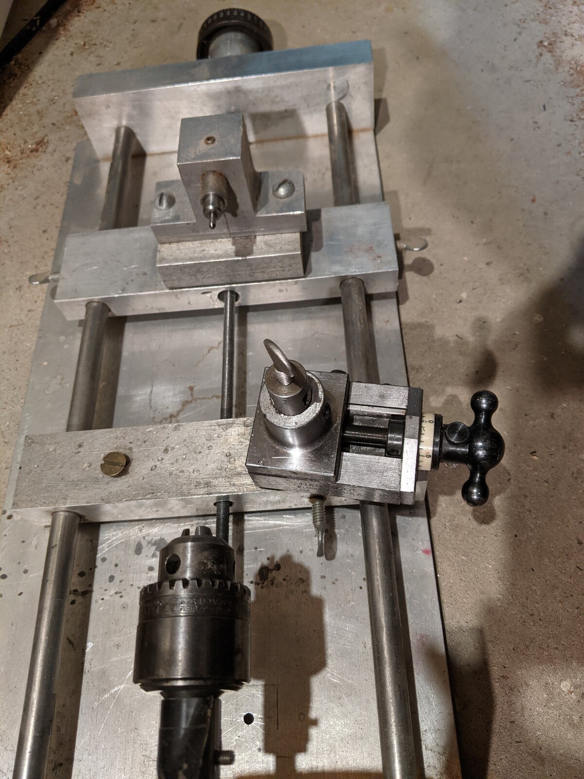

Well, it was good for pens - I don't think I ever tried it for anything larger. It had an extremely limited swing, maybe 10" between centers, and the makeshift-tool-rest-in-a-makeshift-tool-holder arrangement wasn't sturdy enough for heavy turning.... but it was pretty neat to work with, and I really wish I could've met whoever made it (it was at least third hand by the time it made it to me).
Maybe... but what I found most interesting is how simply it was made. It looks like the whole thing was probably built with nothing more than a drill (press, presumably), some variety of saw, a couple taps, and a screwdriver. No welding, no milling, no turning.

For most of the pens on that one, I just used a standard 7mm pen mandrel (which, like 3/4" NPT pipe isn't 3/4", isn't actually 7mm at all, but around .247"), but that doesn't work for closed-end pens, so I had to do something different - and I think you already stumbled across the answer.
The tail end was held on the sharpened-rod-in-a-plain-bearing "live center", and I believe the front end (which was tubed like half of a 7mm/slimline pen) was driven on a hand-filed (this was long before I had the mill) pin chuck based on Don Ward/its_virgil 's designs in the library (see below), held in the headstock Jacobs chuck :
