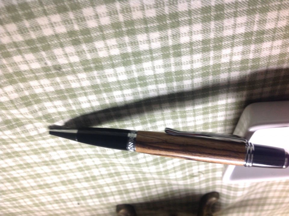

Thanks for the help. I keep learning and appreciate all the advice. Made my first, other than slimline today, a Manhattan Kit from Rockler. The wood is " Zebra wood"??
This is the first tube I glued, and blank I drilled. WOW, that CA sets fast.
Lots to learn, but enjoying all the advice, and will get better with each pen.

Don't use thin CA to glue in tubes and don't try to glue the tubes in while the blank is still hot from drilling or wet from lubricating while drilling.
Use thick CA, it will fill gaps. Both water and heat are CA accelerators, make sure neither is present.
