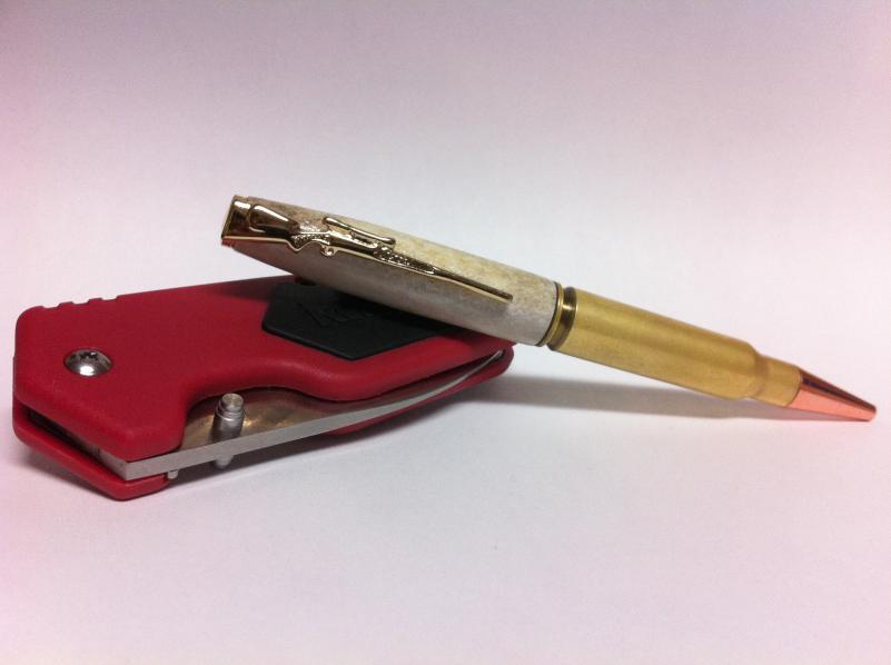

so i am slowly getting into custom pens and my dad's friend made me one from elk horn and a 308 cartridge. i figured if he can make them i could make one from my next buck kill so heres the issue. the pen that was given to me, its a twist pen and the actual mechanism to twist the cartridge in and out just doesn't seem very stiff and while writing the cartridge ALWAYS ends up closing up. how can i fix this?

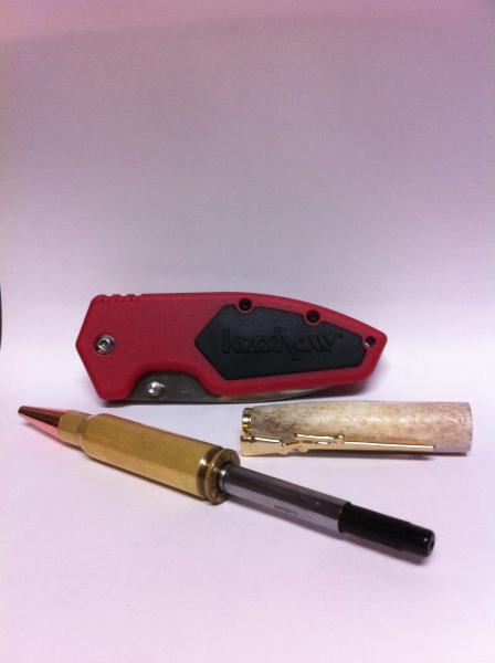

literally just went and snapped these so be nice please but hey this is just the overall pen I'm trying to use an iPhone and to be honest from the hours of research i did I'm pretty sure nothing is wrong with the transmission but is there a transmission that basically snaps into place that i could replace it with?

One thing I have found the most cause of this is that the transmission is not fully extending. This has to happen to lock it in place, if not it will retract as soon as you put pressure on it. JMTCW. By the looks of your pictures it is just a slim line transmission and can be replaced very easily.
Lin.
you have to knock out the nib. You can use a small transfer punch and once the nib is off you knock out the transmission from the nib end. Hold the pen bottom in your hand and wrap it in a piece of cloth or rubberized material to keep it from slipping. Use a transfer punch that fits inside the tube and hit it with a mallet or hammer and the transmission will come out. Replace the nib and then replace it with a 7mm transmission and press it in slowly so that it doesn't extend too far. It isn't too difficult. Just follow the steps and don't rush it.
Will get a picture for y'all in the morning. The tip definitely May not be coming out enough. I just want to get it working properly since there is nothing worse than racing to write before the tip disappears
You have had some good advice. My guess is the same as some. I'll bet that the transmission was pressed in to far.
Try this: Unscrew the refill about one revolution. Now try the twist as you would with the top on. If it works correct, your trans was pushed in to far when installed. If this is the case, you can do as suggested and knock out the nib and then knock out the tranny. If all comes out well, what I do, when installing trans in a 308, is this.
First you have to have the nib back on the casing.
Second, screw the refill into the trans and extend the refill as you would in the writing position, hold it up to the casing, and see how far you need to press in the trans. Now remove the refill and press in the trans just short of your mark and test. You should be short. Now just sneak up to where you need to be. I will bet that you will not press in the trans as far as you would normally go on a normal size tube because your 308 is just a bit shorter than the normal 7mm tube.
One problem you may run into. When you knock out your trans you may inadvertently knock out the tube as well. There is a good chance you will wreck your trans as well.
If you do have a problem, I can send you a nickle plated 308 with the trans installed and a copper nib just because, so don't sweat it to much.
Let us know how it works out for you.
I simply screwed the cartridge a bit and it worked perfectly. Id love for it to have a transmission that vet distinctly and firmly locks into place but my pen is doing great now
