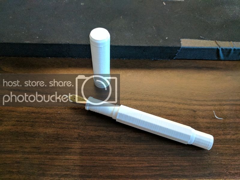

Already on it, I have worked on a few designs. And no, it is not more expensive than current methods. I can print a 100 blanks for the price of one acrylic blank.
just a taste, I'll post more pics later

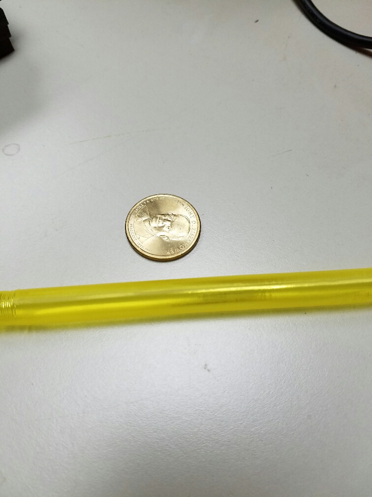

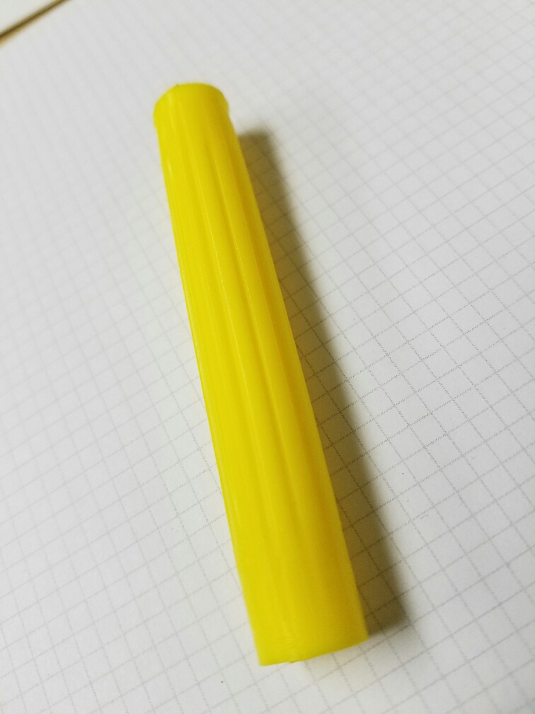

Played with a concept last night during the Hive meeting,
Now i need to figure out how to encapsulate it in Alumilite or something similar. I tried the XTC-3D stuff from smooth on but I'm not crazy about it. It sat over night and it is still soft, tacky. The rest I had mixed is hard as a rock, so not sure why it isn't hard on the print.
Maybe a mold so I can turn it down to .5mm or less above the print, but then I loose the fluting, might be OK though. I thought about not doing anything, but over time the 3D print will get filthy and it won't be easy to clean it becasue of the layering.

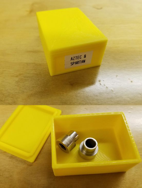

Right now this would be novelty thing. People at Maker Fairs love the 3D printed stuff, they are always wanting to buy my printed examples and such, so maybe a few dozen Trimlines with 3D printed body would go good. ;)
I was really surprised however, I put one I printed on my lathe and I could actually us the tools on it. I thought sure it would simply shred into pieces, but it actually cut nicely. This is PLA (Poly-lactic Acid, or corn starch) plastic. It is fairly strong and ridged, much like acrylic. It has a low melting point so it's not a pen you would want to leave in your car on a hot summer day lol.
