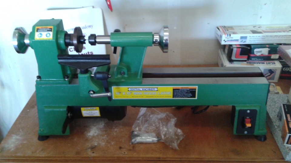

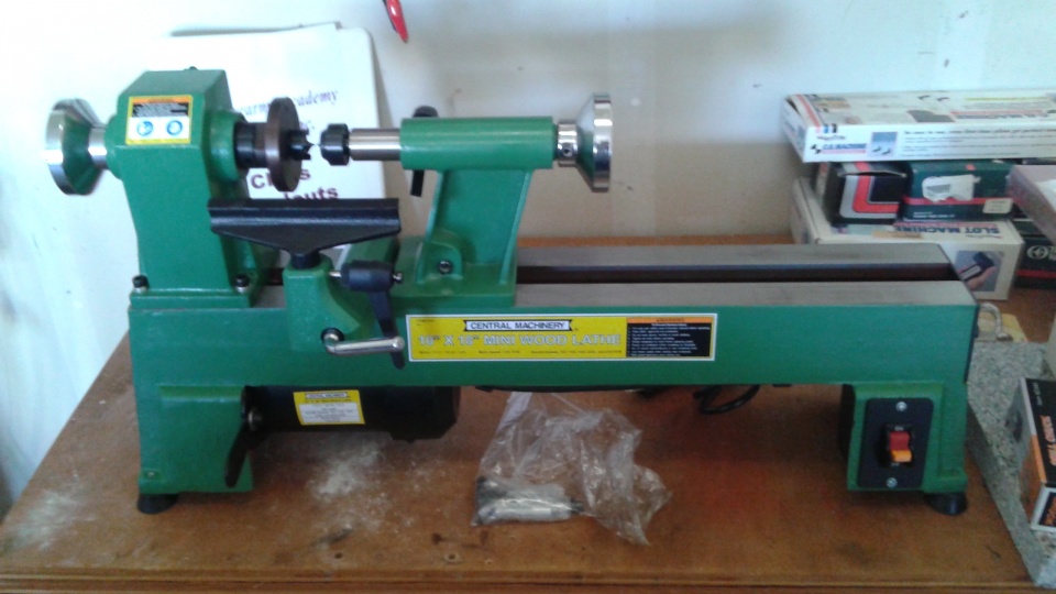

I know that HF tools are not the best and can be hit and miss, but for a starter lathe the price point fit my budget so I picked up this lathe:
Benchtop Wood Lathe - 5 Speed

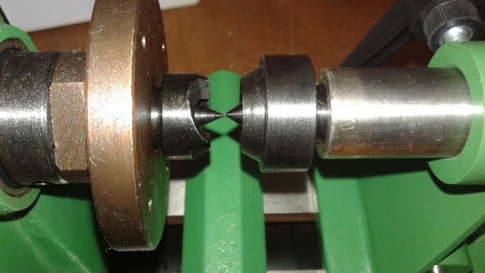

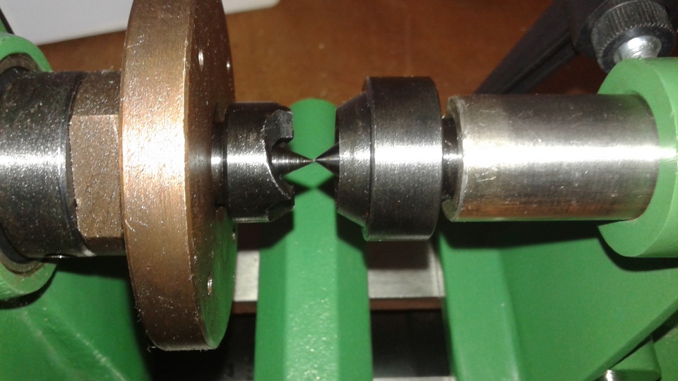

I had done a little research prior so the first thing I did was check the centering which was spot on. I had a 20% off coupon which made it that much better of a deal.

I started with the Rockler equivalent of your lathe 3 years ago and it has served me well. They are identical except for the name & color. I recently moved up to a full-size lathe for larger projects, but I'll continue to use my mini-lathe for some small projects and may eventually use it as a buffing station.
I bought the Barracuda 2 Chuck System from PSI. As you noted, there are many to choose from, but this is a pretty good one for the price. It comes with a set of pin jaws that are good for drilling pen blanks, but also has several other sets of jaws that will be good for bowls & other projects. You can also buy extra chuck bodies from PSI when you get tired of changing jaws from one project to another.
The only drawback to drilling on the lathe that isn't variable speed is that you will need to move the belt frequently. Fortunately, it's pretty easy with that lathe. You should drill at the lowest speed & turn at the fastest speed that's comfortable for you. Some also like to slow the lathe down for sanding & finishing, but that's not really necessary. I turn, sand & finish at full speed with my lathe. Sanding takes a light touch & good quality sandpaper - I like Mirka Abranet & Mirka Goldflex, but there are many others to choose from as well.

The HF lathe has a spindle size of 1"x8 TPI so it does appear that the Barracuda 2 Chuck will fit it. It must come with an adapter as it shows that it will fit two spindles in the specifications.
At this stage I think that I will give the one I purchased a shot and see how it goes. The Barracuda 2 cuts a little deep into my budget at this stage and while eventually I can see that in order to do other types of projects I will need a four jaw chuck it's a little out of reach right now. I will keep my eye on craigslist and maybe something will show up that route.
@edohmann; in regards to the Lathe not being variable speed, I knew that going into the purchase and it was one of the compromises I made to be able to get started now rather than waiting several months. I've experimented already changing the belt positions and it doesn't take long. I've printed out the chart from the manual and will tape it on the front of the lathe for reference. I am surprised that there wasn't a sticker or something supplied (but again, it was a very inexpensive tool.)
