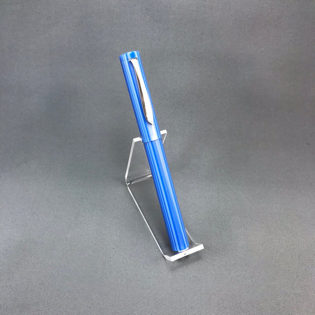

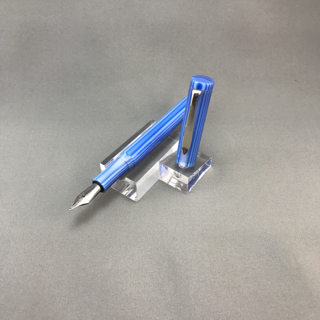

I just wanted to test out the new picture posting and figured I would display my latest creation.
It's a Blue Pinstripe with a hand shaped Nickle-Silver clip.
Getting the stripes to line up between the components, was the tricky part.

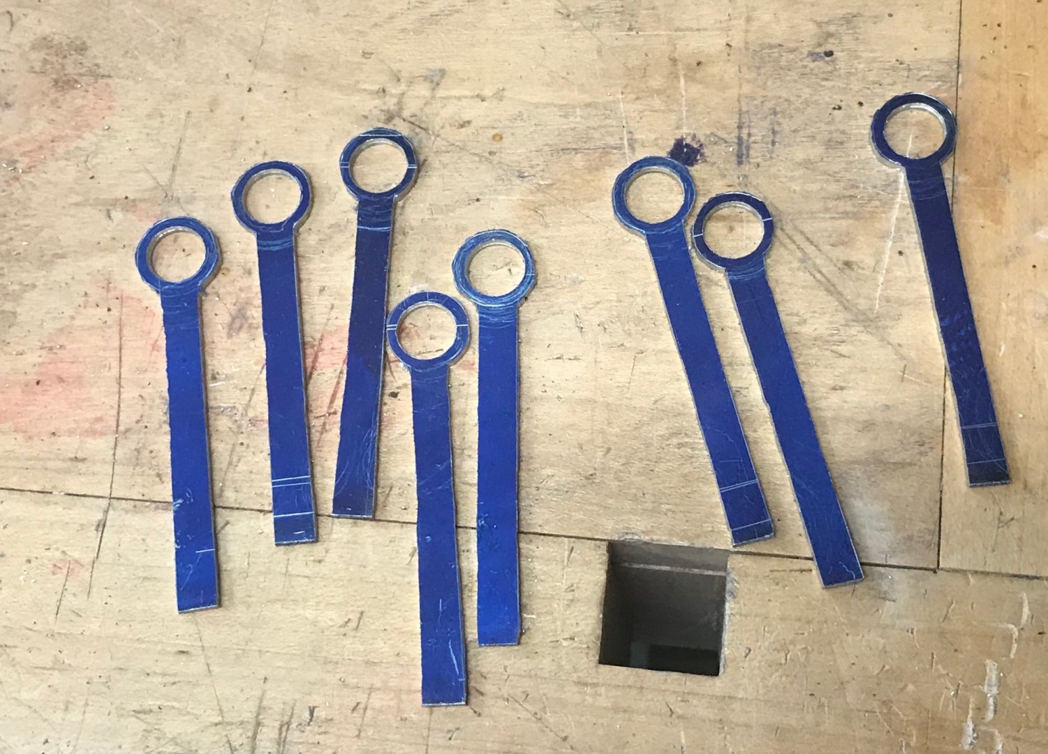

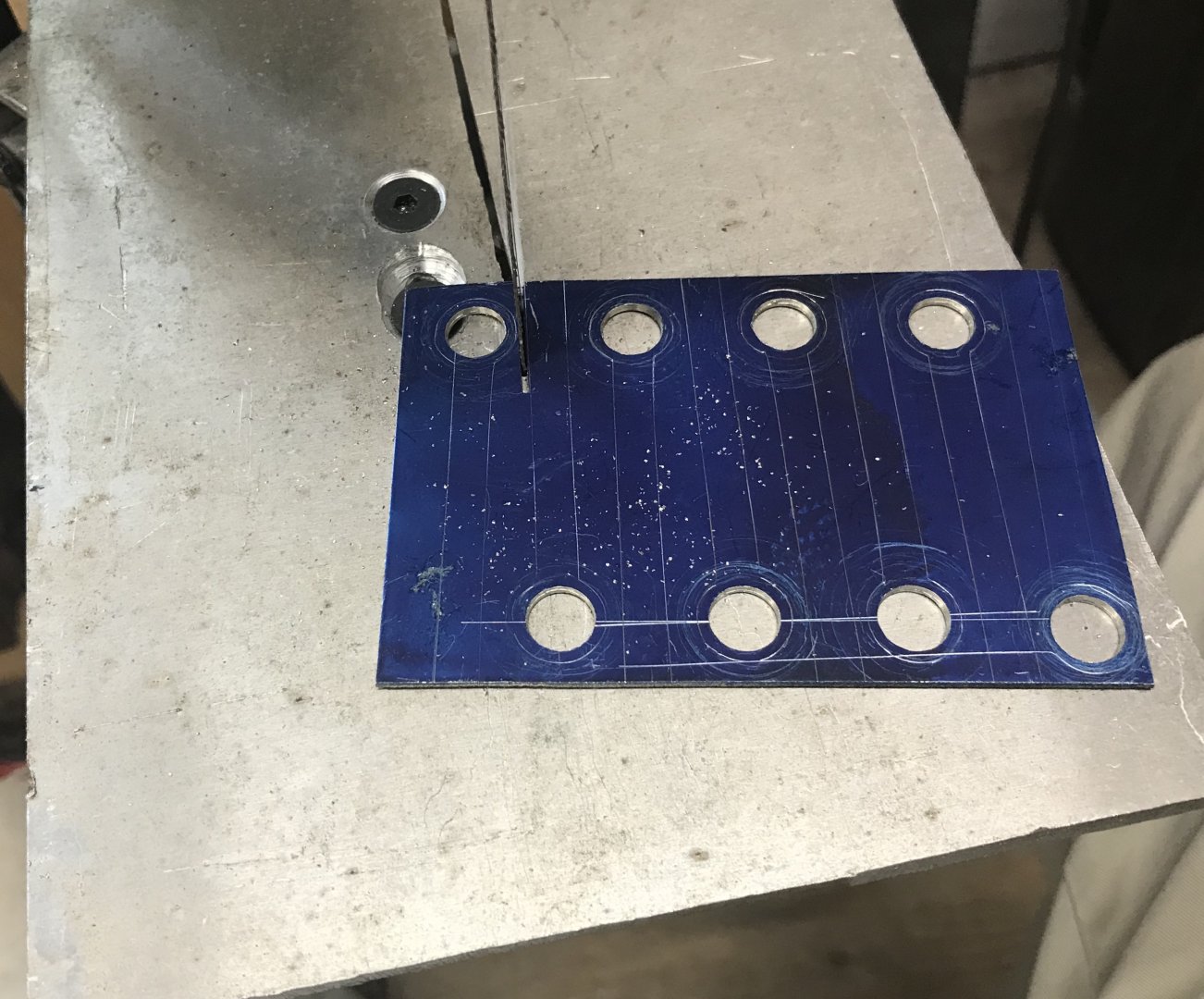

There not as hard as you might think Tony. The first step is getting the right material. I had the hardest time getting small sheets of the the material I wanted here in Canada. I ended up ordering from Online Metals. The shipping hurts less the more you buy.
These ones are made of .052 .062 thick Nickle Silver 770-H02. I simple drew the shape on the metal, drilled the hole for the clip, then cut out the shape. I used to do this with a hacksaw, but now I have a Portaband saw, takes about 1 minute. After that its just cleaning it up with files, Dremel and sandpaper. This is the tedious part that i hope will go quicker with practice.
