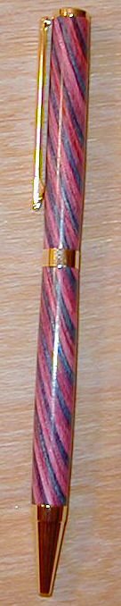

Applied D.C's formula to 5 pens last night and buffed this morning.
All results were EXCELLENT!
One piece in particular was a power point pencil made of lignum vitae(thanks to ILIKEWOOD)
I knew a CA/BLO finish on this pen would drive me up a wall so I opted for BLO.
Wet sand with BLO 320,400,600 grit.
Burnish in with viva paper towels till my fingers burned.
Micro meshed from #3to #9
I applied DC's formual at 8:00 last night and buffed it out at 8 this morning.
It looked good with the BLO,but it looks great with The magic STUFF!
This will be a good test because I intend to use it as my shop pencil[:D] and it will take abuse.I will make successive applications as the week progresses.

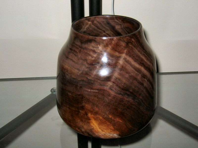

Here is another non pen with TSW.
Should we be refering to this as a finish enhancer? It appears that it is not being used on raw wood, but a full finish is being applied and then TSW is being used to enhance / maintain the finish?
CA/BLO is a finish, I am using the Beall system, others are using carnuba wax. Hmmmm. Just a thought.
That's one beautiful bowl, John...you did yourself proud.

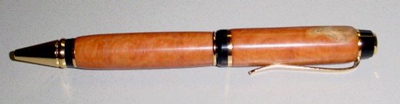

Lou, I used the TSW on my first cigar pen yesterday, using Australian Coolibah Burl. I sanded thru the micro-mesh and applied one coat of friction polish before applying your finish. The pen came out sooo sweeet! I have received many comments on it. Here is the pen, if anyone wants to see it.

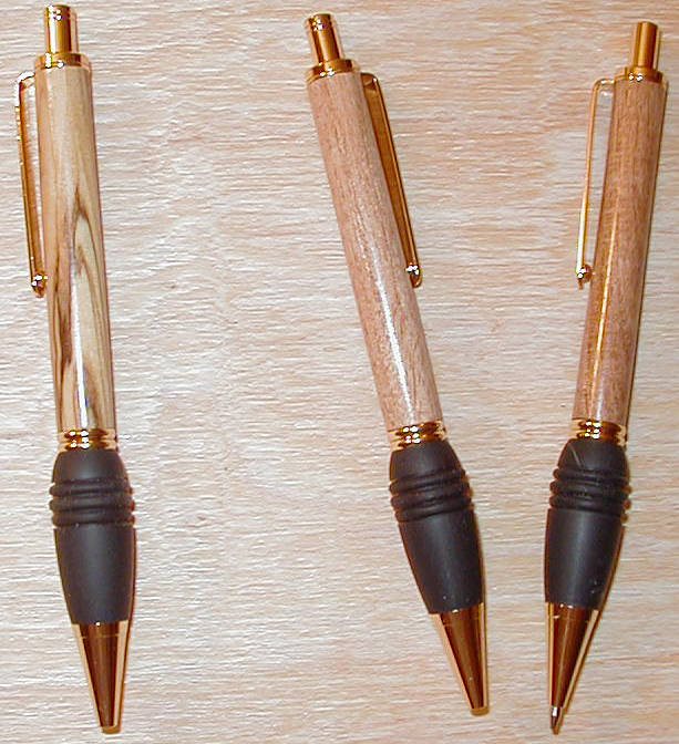

Three EZpens for were requested by someone.
All three were sanded to 600 then quick trip through MM.
The Olivewood on the left was then Myland sanding sealer and then TSW. Next night another coat of TSW and buffed.
The two mesquite had only friction polish and then TSW.

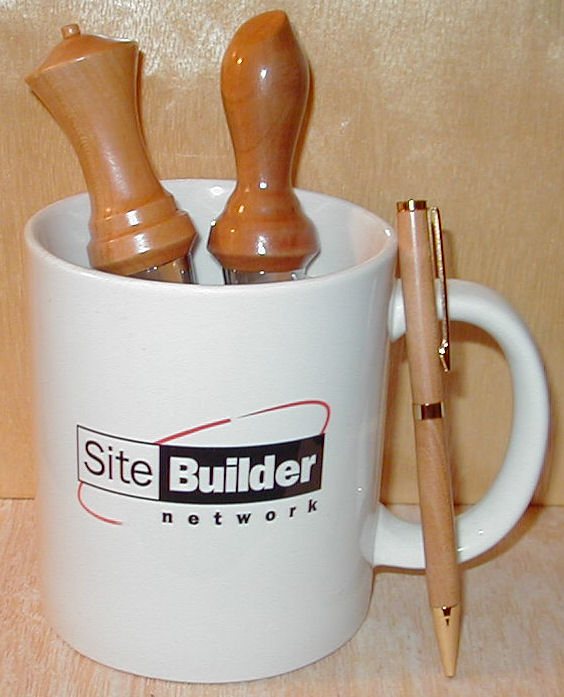

Also made a couple of wild cherry stoppers and a wild cherry slimline per request.
Both stoppers and pen were sanded through 600 then MM.
Both stoppers were Myland sealer and then TSW.
Pen was only TSW.
