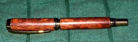

I certainly hope so. How about it Tom? John? I'll be posting a picture tonight of a sindora burl pen that I finished yesterday. Let's see what results others are getting!
Here it is. Sindora burl Titanium gold Gentleman Jr. pen finished with sanding sealer bottom coat and TSW-1121 top coat.

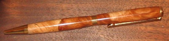

- Item description- slimline pen
- Wood type(s) - Maple Burl
- Pre-finish if applicable - BLO/CA
- Pre-finish sanding grits - 1200 then EEE
- Finish application notes including bonding wait time - wiped on and waited approximately 5 minutes, then buffed off with same cloth
- Post finish notes, wait time, observances -
- Buffing steps used - desired sheen (semi or high gloss) - high gloss
- Assembly notes- no issues
- Opinion and reasons - Great smell
Just got my sample today and was anxious to try it out. I'll carry this pen starting tomorrow and will post results on how it wears.

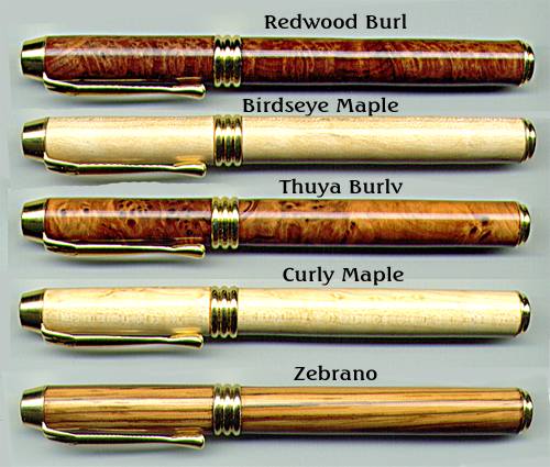

Here are pics of the pens I did with the new finish... all Executive Roller Balls.... various light to dark woods... all polished up real well to a high gloss.. These were made after the first couple I tested... got a better hand on the application and buffing process on these... just a little learning curve... first time I did not follow the directions correctly and they still turned out good.. but these are even better...
- Item description
- Wood type(s) - Various (See Pictures)
- Pre-finish sanding grits - 600
- Finish application notes including bonding wait time - wiped on and waited to glaze over, then buffed out with same cloth. Assembled pen.
- Post finish notes, wait time, observances - Waited until following morning and Soft cotton cloth to final buff it to a glass like surface.
- Buffing steps used - Old cotton tshirt buffed to high gloss
I have to say, not only are your pens great looking but your photographt is great too! I definately like the brilliance this finish added to your work.
Tom, why does some of that look familiar, especially the Redwood and the Thuya. Is it from what I sent to you? Wherever it came from you did a nice job with it because they all look good. I like those kits, they allow for a lot of wood. I also like the classic rollerballs, but the bits are a little expensive but the lines of the pen is just so nice. I had to buy a bunch of kits to make up for the expense of the bits. Nice job.
Wayne
Yes Wayne that Redwood came from you... the thuya was from another source..
I agree those kits are the ones to use if you really want to show off some fancy wood... it is a shame the maples did not come out as good as they really are...
It is not a photograph... I put the pens on my flatbed scanner and set the resolution to 200dpi and adjust the brightness and contrast to get a good scan...
