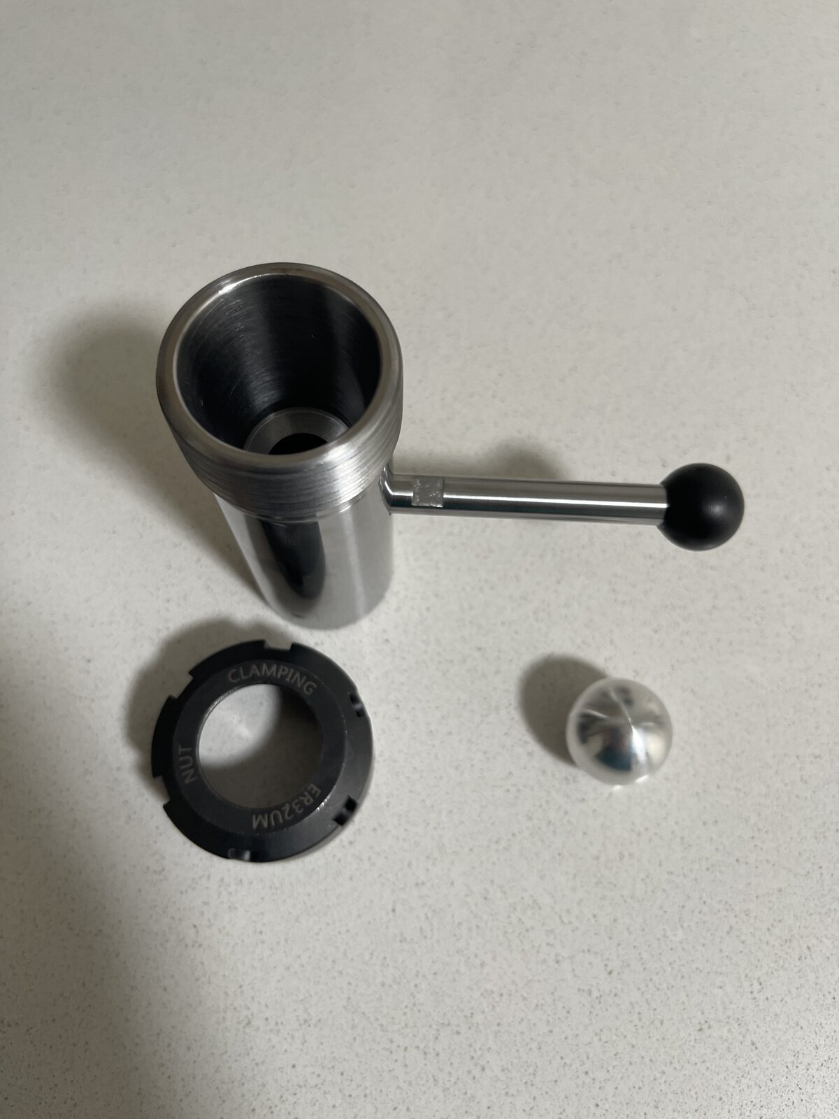

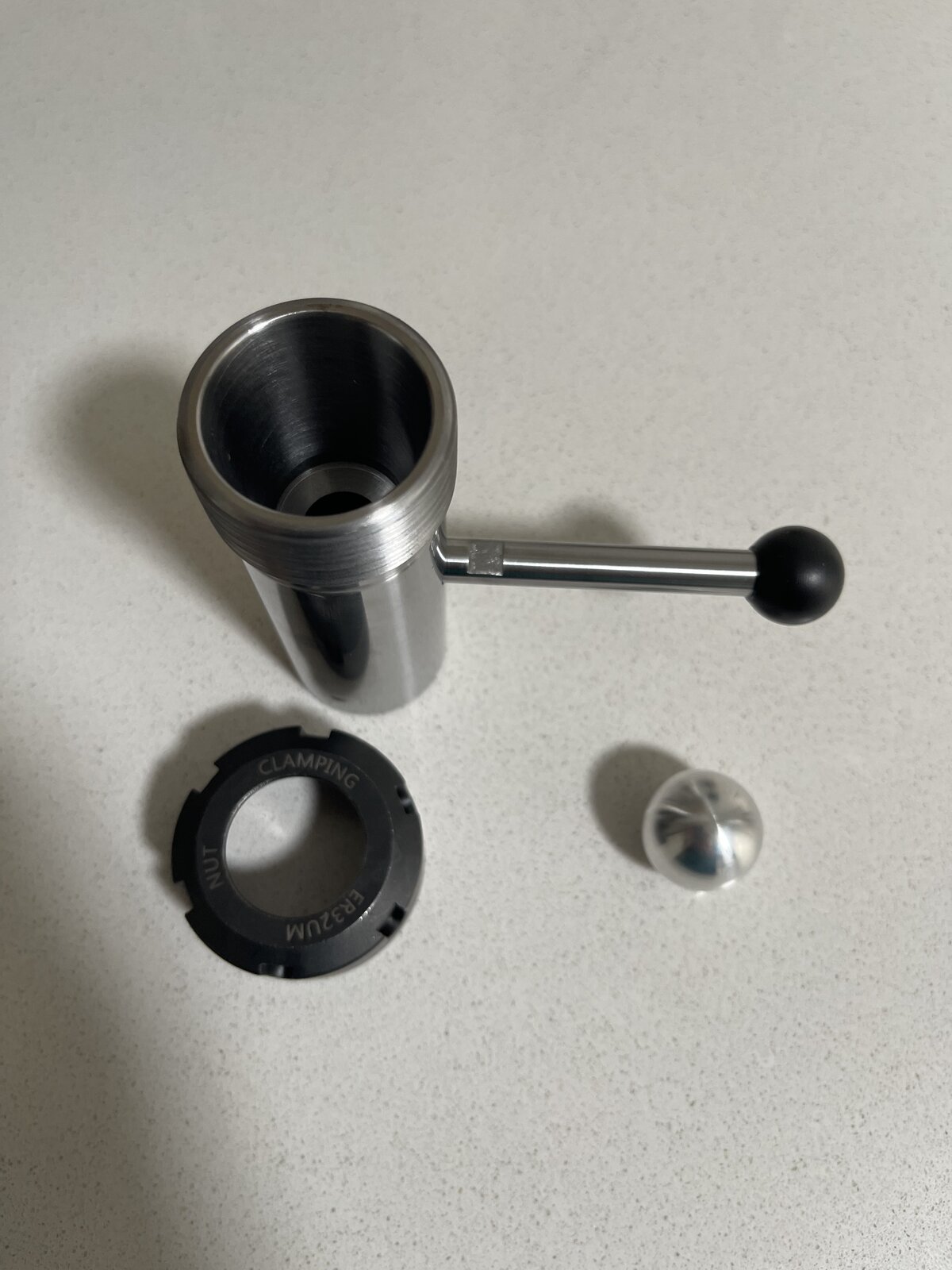

Big thank you to @rherrell for this awesome er32 tap holder. That fits my littlemachineshop die holder shaft.
This is a sliding holder which allows the tap to be fed into your part as your part turns.
The er32 allows for holding your tap. It's much more accurate than the Other tap holder I have.

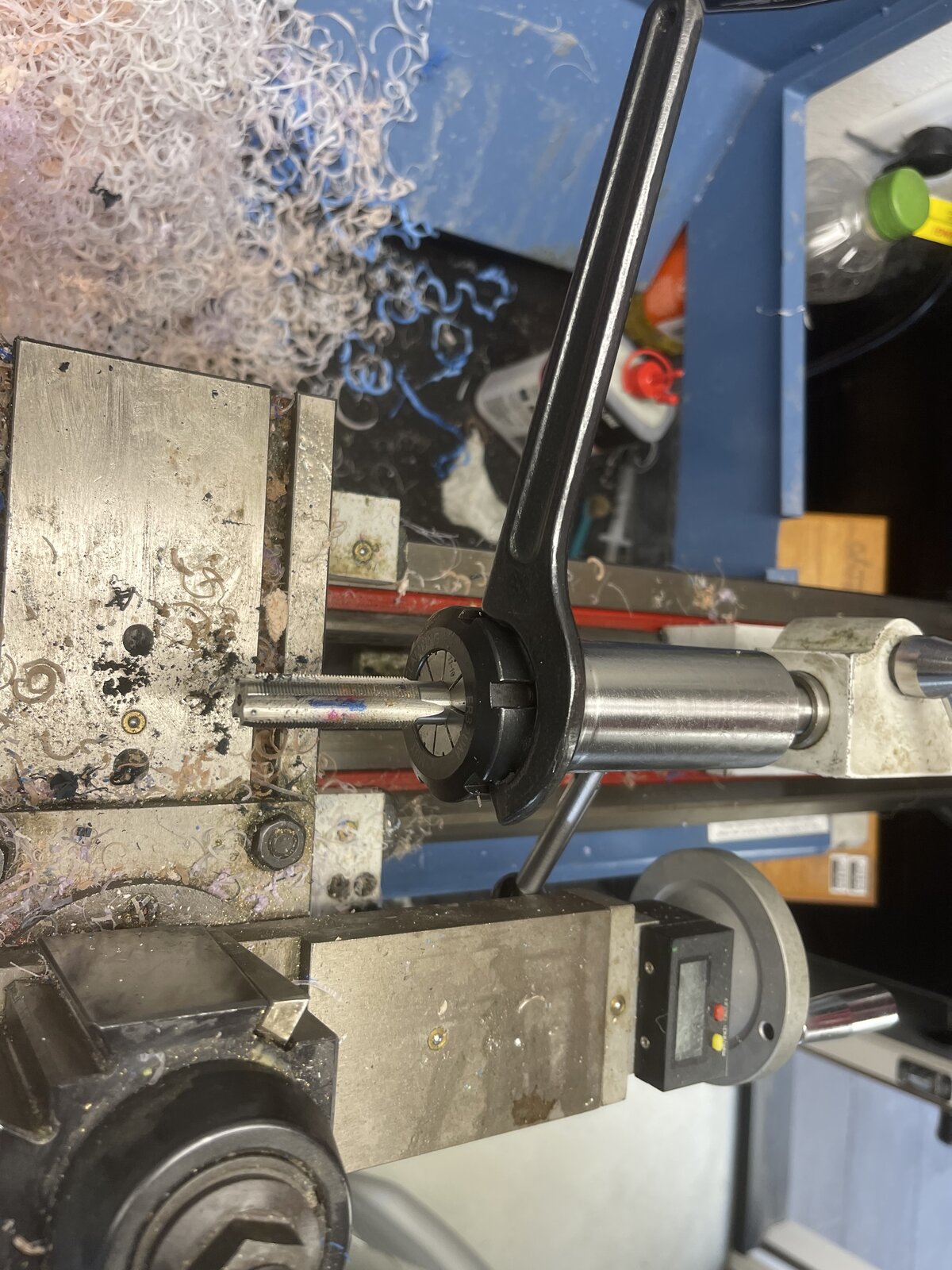

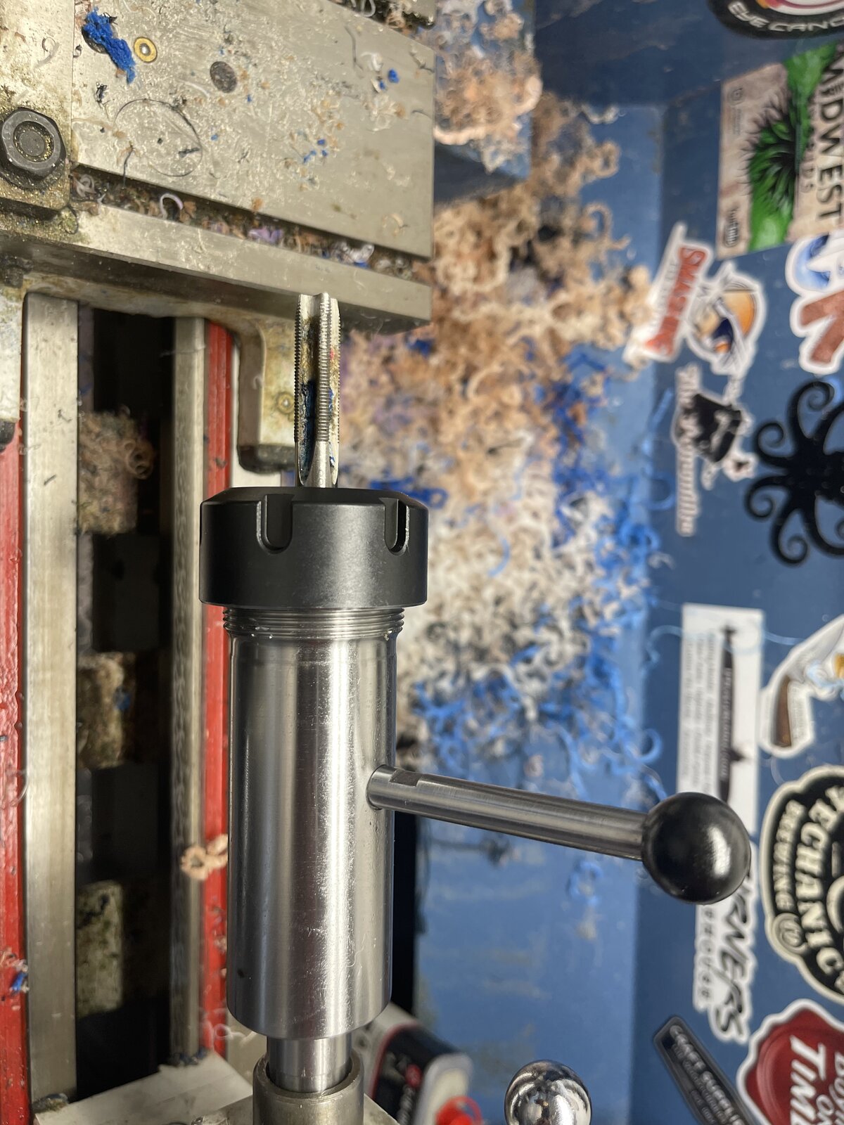

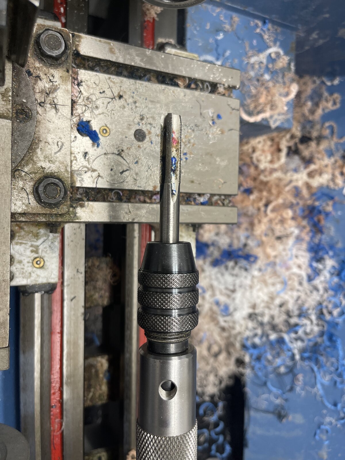

I have the Niels as shown in the video. Works fine for tapping bottle openers. But for kitless, Not happy. My taps are always held off axis in the various sized chucks.
The er32 setup by @rherrell is dead straight.
Tolerance stack up of the v holders vs concentric lock up of an er32.
When I spin the Niels you see the tap is off axis. When I spin the er32 it's on axis.
Sorry I can never get videos to work so I included stills.
You can see in the Niels it's tilted to the right.

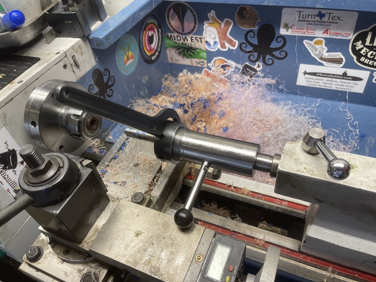

Make sure you get the tap close, lock the tailstock, slide it in till it engages, hand turn headstock to engage, then lower tap.
When reversing add slight pressure backward so that when the tap clears it moves away and leaves the starting thread intact.
1 photo shows how to align the handles to loosen (1st photo) the er32
Last photo shows how to tighten.
