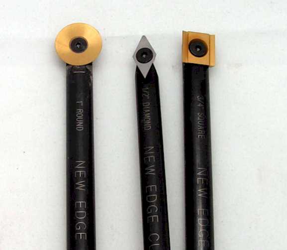

Anyone here own or ever use any of these tools? I went to the tool show in Pa. last week and as soon as I walked in the door the person that makes these was set up. I was impressed and bought a set plus the one he no longer makes. The set consists of 7 tools. They have carbide tips and when they get dull you just rotate the tip. After you have used up the entire tip you simply replace the tip. I haven't had a chance to try them yet. They are very sharp though.

First of all I would like to say that I am in no way affilliated with the people or company that makes these tools. Just wondering if anyone here has any and what they think of them. The tools measure 8 1/2" for the three smaller ones and 11 1/2" for the longer ones and all have a 14" hardwood handle. There is total of 7 tools in differant sizes available. I purchased the set plus one tool that is not being made anymore. The sizes available are: 1" round, 3/4" round and 1/2" round, a 1/2" diamond and 3/8" diamond, a 3/4" square and a 1/4" square. The replacement tips are $15.00 each except for the 1" round which is $20.00. I understand they will cut a lot of wood before replacement is necessary. They are extremely sharp tools but I haven't had the chance to use one yet. The person putting on the demo at the show used the 1" round to do a bowl from start to finish. There is alo a pen turning tool available with 4 tips.Their web address is: newedgecuttingtools.com. If anyone is interested or would like more info. on the tools.

Any updates as to how well these work? Also, why the need for six tools? Couldn't all of the tips fit on one handle assembly? It would slow down tool changes, but would save a ton of $$$.

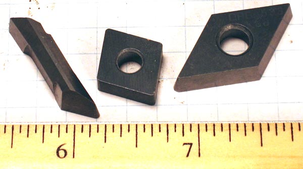

OK, the "honey do" list was a lot longer than what I thought it was going to be.
Here's what I found at the surplus place...

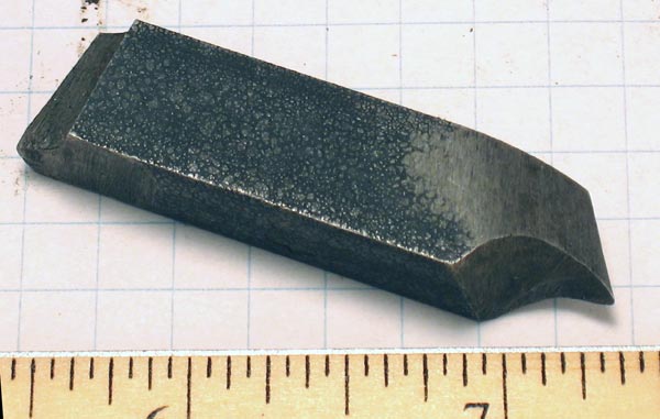

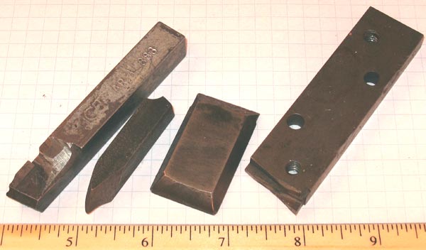

I was WAY off on the price of the carbide cutters. They are, in fact, 99 cents each. I just bought these three, but they have many shapes and sizes. I'm not a machinist so I'm not even going to try with the proper names:
These cutters ARE sold by the pound. These are about the smallest I found and the get quite large (and heavy). Same thing about the sizes and shapes. This was just over 1/2 pound's worth:
Here's a closer shot of one of the above cutters:
If these bits can help any of you, just PM me. The store is only a mile from me.... right across the street from my favorite fried chicken joint[:p]

The ones up top are the carbide turning inserts that normally run in the $15 to $20 range. They can be found on sale down to around the $3 range sometimes. The others are HSS or cobalt toolbits or carbide brazed onto steel toolbits. They take hand grinding to get the proper shape. The carbide is far harder and takes higher heat (not a big issue with wood or plastic) than the others.
