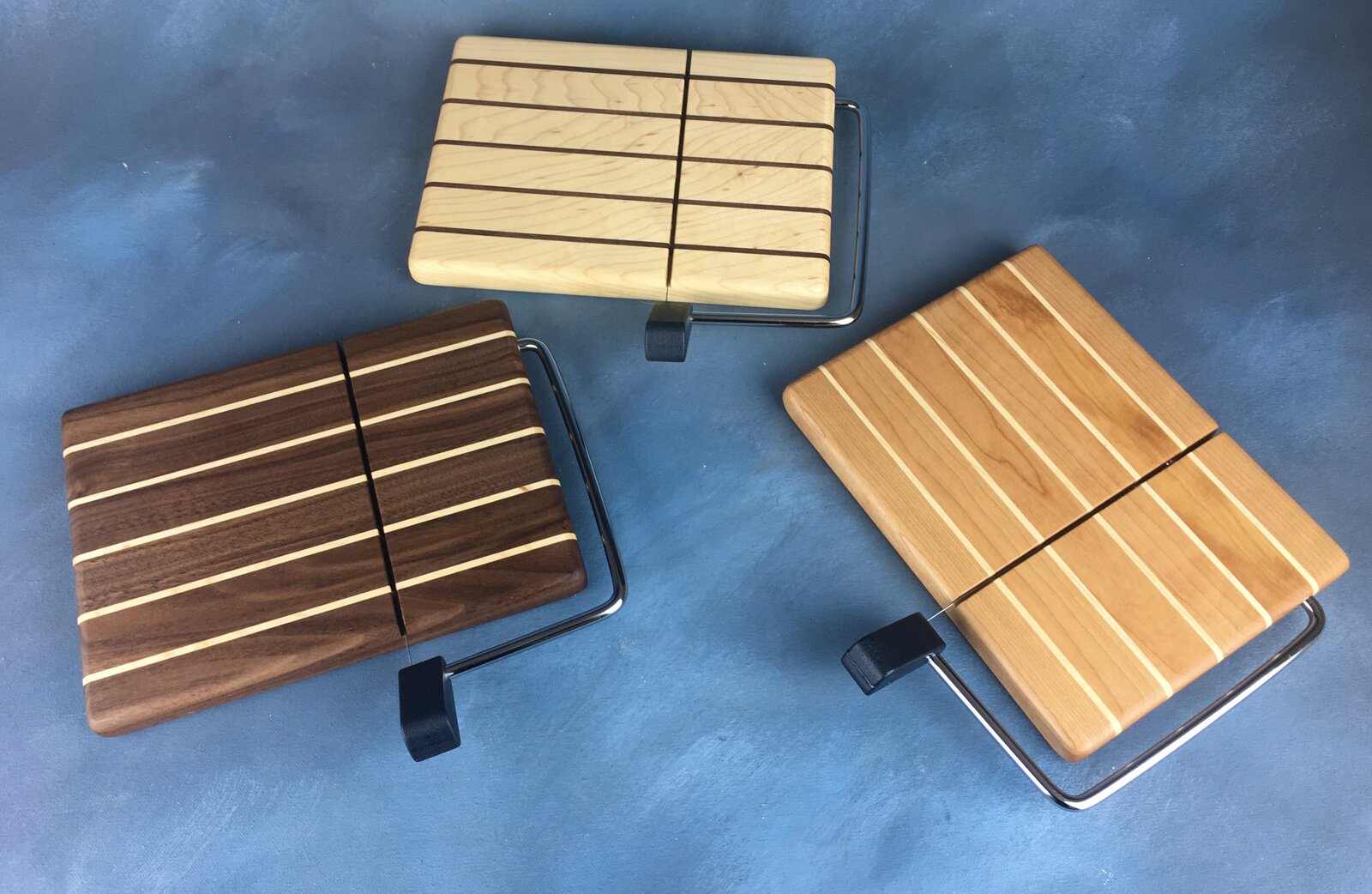

We have had very good sales in cheese slicers and cutting boards. To that dnd I came up with this new design. I also made matching 12"x11" cutting boards.

Very nice. They look like a fun project to do.

I just may have to borrow that design.

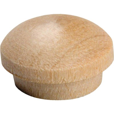

Do you leave your cheeseslicers flat on the bottom or do you put feet on them. something similar to these mushroom plugs?
I leave them flat and they work well. It is my way to avoid juice grooves and feet to keep from having areas that collect bacteria. One screw removed and you can sand them if needed.
