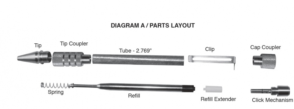

They have a new clicker that uses a Schmidt mechanism
It's call the DuraClick EDC (Every Day Click)

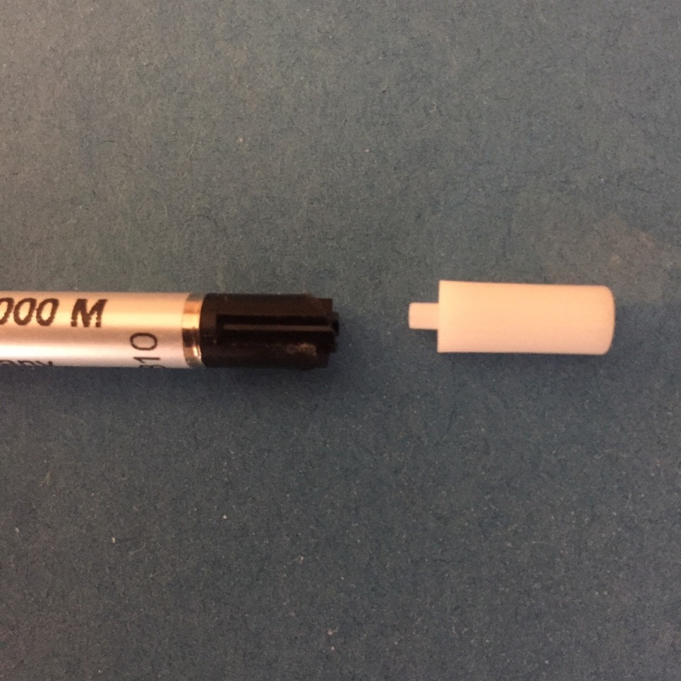

An interesting detail that could be a concern is the refill extender.
A small nylon piece that snaps into the end of the refill.
If it gets lost I wonder if replacements are available.

Those wouldn't be the first kits to use that piece.
On a couple that I made, I shortened the tube, to eliminate the little plastic piece.

As John said, this is not the first pen kit design that uses a "refill extender" piece.
Berea Hardwoods, in their early Sierra click pen kit offering, used a metal extender. . The point of this extender was never very clear to me, other than making the overall length of the pen a little greater. . But it was an inconvenience, especially at the time of refill replacement, because of its potential for getting lost. . As far as I know, there never were any replacement extenders readily available. . And, besides that, who wants to be in the position of owning an unusable pen in the case that the extender disappears. . Some people have claimed (see Curly's post above) that the longer pen barrel was meant to offer the possibility of replacing the standard refill with a gel refill (typically longer) by leaving out the extender piece. . But that possibility was never featured in any of the Berea data on that pen kit, as far as I know. . Similarly, the alternative of using a gel refill is not mentioned in the PSI blurb for this new pen kit offering.
Berea discontinued their Sierra click pen kit with the extender piece about 6 or so years ago when they did a complete redesign. . Some penturners were overjoyed at this change, but many were very confused by the introduction of yet another, different, length of brass tube.
In summary, I am not in favor of a pen which requires a "refill extender", and for that reason I am wary of this new pen kit offering from PSI. . I wish they had provided a longer click mechanism instead of the refill extender.

....... I wish they had provided a longer click mechanism instead of the refill extender.
Mal since Schmidt makes mechanisms for many companies and have likely standardized their sizes to facilitate production I doubt they would make longer ones for the relatively small numbers that PSI and its suppliers represent. Maybe if they made millions of them. :wink: If PSI wanted to bear the retooling costs they might but then those significant costs would be reflected in the prices we would have to pay. :eek: As important as we think we are, we a little more than an afterthought in the overall pen market. :frown:
Greg can you see if the click mechanism if fit into the top parts or is the entire mechanism one assembly?
magpens
Feb 2, 2011
15,764
Canada
From inspection of the PSI instructions for this new kit, it appears that the click mechanism screws into a top finial piece which PSI calls a "cap coupler" (misnomer, in my opinion).
Curly, another althernative would be for PSI to provide a small extender piece which fits onto the plunger of the click mechanism ... subject to available room inside the top end of the pen and "cap coupler".
I know that this does not overcome the potential for losing a crucial piece but what I am really getting at is this. . Perhaps the pen maker could, himself, supply such a piece and even glue it on, thereby making it a permanent fixture.
According to the catalog this is a "Schmidt SKM-88" it screws into the top cap, coupler or whatever you want to call it.

As far as I can see they would have to shorten the tube.
I don't think I would like it.
Would look too stubby.
Gregf
May 22, 2010
531
Richwood, OH
That looks to me to be the best alternative.
A 1/4 thick rod that would slid over the plunger should work.

I see that they have aluminum & a stainless option. I have build custom clickers using this mechanism (with and without a spacer). I would like to know if they seem top heavy based on using the spacer. I found that the mechanism makes a longer custom pen a little top heavy. But without a spacer, it's too short for my taste.
I think the stainless might have enough weight to offset the weight of the mechanism. But I'd be hesitant to buy the aluminum versions. At least till I new they felt balanced.

And I guess your point about the spacer (refill extender), even tho' it's plastic ... is that it affects the weight distribution in the pen, and therefore the overall balance of the pen.

I typically make the spacer a tight fit so that it slides over the clicker rod and stays attached to it. Then when you remove the refill, the spacer stays in the pen attached to the clicker so it doesn't get lost.
I always tell my customers about the spacer too, so that if it does come out with the refill they know they need to keep track of it. Haven't had a problem with one yet.
As for weight, they are pretty heavy and do throw off the balance. Some people don't like the heavier pens either. I'd assume that the aluminum nose cone being so long it might counter balance the pen, even with aluminum being lighter.
I have to order some of these kits. I'm curious to see if they are smooth like the well functioning Schmidt clickers are. The problem with the Schmidt clickers is that you sometimes get one that isn't smooth and they are hard to get clicking smoothly. The yellow plated ones from Richard seem to be way better.

I don't know if the PSI mechanisms are the same, but the ones I have are pretty substantial. I think they are chrome plated brass. They look to be the same though.
That is an interesting point and one I had not considered.
I think the spacer isn't an issue. I've made spacers, for my custom clicker. I made them out of alumilite. IIRC, the sierra clicker used an aluminum spacer. It was light too.

Here are the weights:
Clicker - 6 grams
My stainless steel nose cone - 11 grams
total pen weight - 32 grams

I made a couple of these this past weekend. The pen feels nicely balanced, feels very good in my hand,extremely easy to turn and assemble. Nothing I don’t like about it. It is now my every day carry pen.
That's good to know. Which kits did you make? If you make the stainless & one of the aluminum models, did you notice a weight difference?
One thing I think I over looked when I said it might be top heavy, was that in a kitless pen, there is no tube to add weight.the additional weight of the added metal piece to the nib along with the weight of the tube should add enough weight to balance the pen.
I may have to try one to see if I like it. I'd still like to know if the stainless kit weighs more than the aluminum models.
KenB259
Dec 24, 2017
2,741
Michigan
I made two aluminum ones, but I also bought the multi pack. Here are the weights of just the components.
Brass - 1.125 ounces
Aluminum - .75 ounce
Stainless steel - 1.625 ounces
hi,
by how much did you shorten the tube?
I just ordered the starter kit as well...
thanks!
