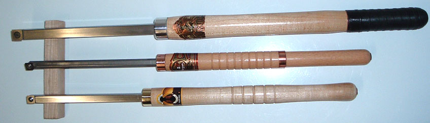

Why make 1 when you can make 3 for a few dollars more!:biggrin:
The large one was the first and uses an R4 blade.
The 2 smaller ones use the 10.7mm R2 cutters from Capt Eddie.
Just paying around with the handle shapes here. I have not used to 2 small ones enough to know which is better or more comfortable.
I have more carbide on order so there will be at least 2 more.
Seems to be the way I do things nowadays. The more the better.:rolleyes:

Love the handles, what is on them, cigar wrappers? I would rather see the carbides recessed to get the cutting edges closer to center mass.
JD, the image does not show it but the 2 smaller tools do have the blades toward the center of the tool. To get the blade edge to the center of the tool shank would leave very little of support left so it is just set down a little more than the thickness of the blade. I'll probably rework the larger one and recess it more.
The center one uses a hex shank and is designed so that it puts the blade on a 30 degree angle with a flat against the tool rest...both left and right. using it like a horizontal scraper is no more difficult than it would be with a round shank.
And yes, the cigar labels are my unique addition. :laugh:

Great job on those, Dale. It's interesting how our choices for diamter, style, and length of handles varies so much. I thought I would like short handled tools for pen turning, but I seem to reach for the long handled tools more.
Dale...NICE turning! I've been wanting to make a couple or three wooden handles for my Eddie Castelon tool bars and yours look darn near perfect! Thanks for sharing and safe turning to you!
