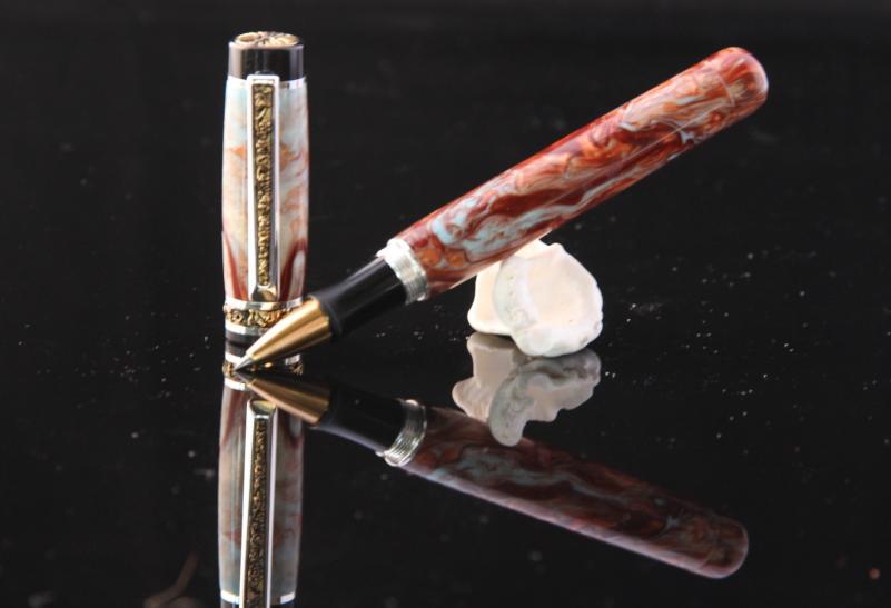

Steve- I'm a Canon user so I can't say much by way of Nikon, but I do use a 40mm prime lens that has been nice for shooting my pens. I can get about 12-15" from the pen and shoot tethered, I would imagine you can find something similar in the lens category from Nikon.

Joe and John,
You inputs are valuable to me, as it has been a long time since I have been doing anything except "Pointing & Shooting". One consideration I have in mind is the lack of a lens focus motor in the body itself, which leaves me with the choice of manual focus (older lens) or auto focus and/or button control focus only available with newer lenses. I can go either way, but must consider the constraints of the choice. Thanks for your responses! Any one else?

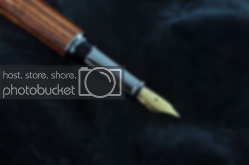

Hey Steve
I think your idea of going to a nice DSLR camera such as a Nikon D3200 would really be a improvement over a point and shoot style camera. This will allow you a huge choice of lens options. As John pointed out (JLewis) we both have Nikon D90's. We both work for a Museum, so its important that we have solid camera equipment. John decided to sell his Nikor 60mm lens, so I bought it off of him for my custom watch photography. I LOVE the lens. Its so incredibly sharp.. Its just amazing. I would highly recommend a Macro lens if your going to do alot of pen photography. It works perfectly for my needs. Here are a couple of quick pictures I took this evening to show you what I am talking about. The first picture is my new Amboyna Princeton Roller, and the second picture is my Wife's new Wallstreet II roller with a Shed Hunter Select Red Cedar barrel. Both blanks have great color which the 60mm Nikor picks up on.
Thanks for that input Denis, and I see what you mean with these photos (which look GREAT). That lens mentioned is on my list. I have read statements about the Nikon D3200 that I do no fully understand. Something about the configuration of the camera, it make all lenses "act" like they are a longer focal length than they actually are. So the 60mm will yield results as if it were actually about 70mm. This makes me wonder if I should be looking for a 50mm instead. Do you or anyone have any thoughts or opinions on that?

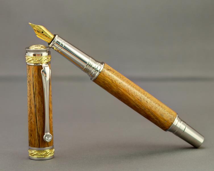

My personal choice is my Canon 60D with 60mm macro lens shooting pen set-ups in a tabletop photo booth. Not everyone has that sort of budget, work within your means. However, i encourage you to expand beyond your initial budget ideas as when you get going you'll soon wish you had more.
Oh yeah...before you all get down on me for dust in pic, that is the pre photoshop version. I don't care how well you clean piece of gloss black plexiglas, dust will show.

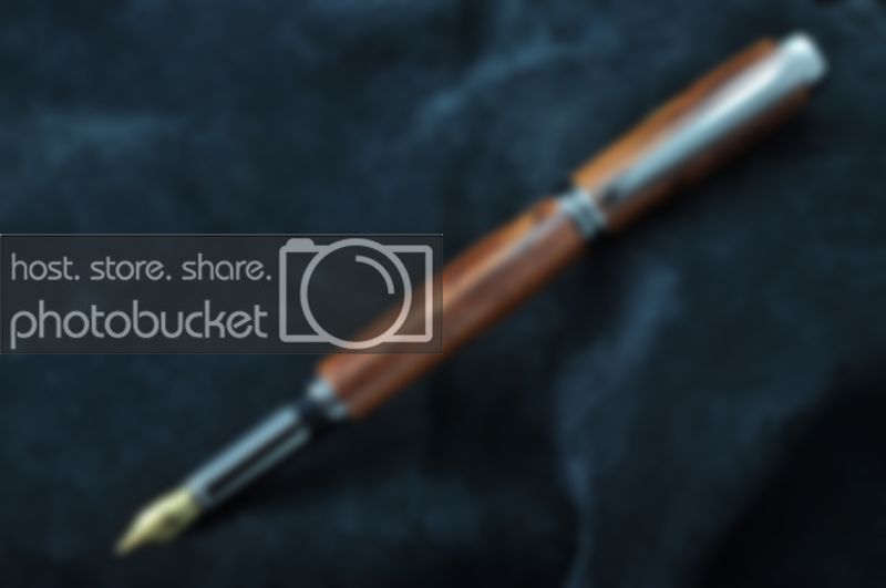

Hey Steve
I took a few more pictures this afternoon using the Nikor 60mm. I shot a few pics a little close to the pens so you could see the Macro capability of the lens. I think you will really like it.
Thanks for the added shots Denis. I have the camera, but the lenses are still on the way. I am anxiously awaiting the arrival. Nice sample shots that demo the close up capability!
Steve
